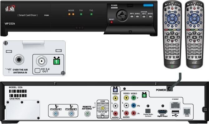

good grief charlie brown.
  1. coaxial cable from Dish Receiver "Home Distribution" port goes to the VCR Coax *IN* port. See the back of your 222k

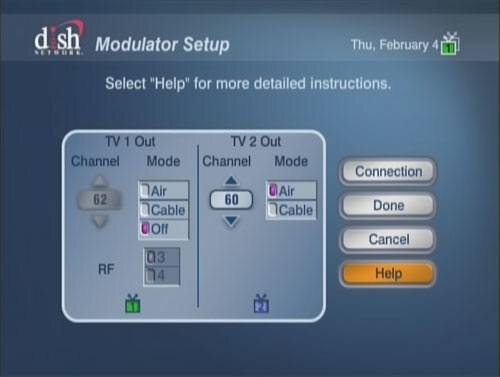

  2. vcr is set to the channel listed in the menu of the 222k for Modulator Setup ... As this picture shows Menu 6 - 1 - 5
    Notice the ability to send *out* via the coax / home distribution port, both TV1/Tuner1 and TV2/Tuner2 video signals. here is where you set what "channels" will be used to send the video signal out the coax to your VCR, please ALSO take note that you can use "Air" or "Cable" signalling. use the same (air or cable) for *both* channels that you output.
  3. For the VCR to record TV signals from the Dish receiver, the VCR will need to tune to the "TV/Air" or "Cable" channel, as you set in that menu screen.
  4. The coax cable *out* from your VCR goes to the Coax/TV *IN* on your TV.
Now ... here's where it gets confusing .. ON THE TV ... TV channel 3 or 4 will get you what the VCR is sending. BUT the VCR can be in "TV" or "VCR" mode in VCR mode it sends on channel 3 or 4 ... in TV mode it will usually PASS THROUGH the TV output from the Dish 222k.
If you are not using the Coaxial cables, then it would be following the Composite (Red/White/Yellow) "Out" from the Dish Receiver, to the IN of the VCR, from the OUT of the VCR to the IN of the tv.
As to your MAC / HDMI -- No clue. You'll need to look at the TV and see what ports are in use. Most likely the dish installer plugged the Dish receiver into HDMI1 unless you stopped them.
make a list of what is plugged in where ... tape a copy of it to the back of the TV or back of a door of your TV Stand ... this will help you in the future.
