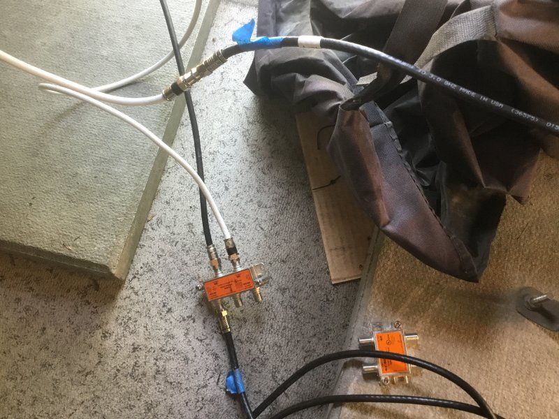

98FEFA9D-DABD-4B00-AC54-F3FDE48291E5.jpeg So this is the set up picture the white wire connected to the black with a male connection is the 129 from the other patio..also is connected to the 129 hybrid lnb on the dish 1000.2. Then the orange hybrid duo hub 2 wires are 110,119 and single wire is going to the hopper 3. Excuse my stupidity but I hope that makes sense.
View attachment 132683 So this is the set up picture the white wire connected to the black with a male connection is the 129 from the other patio..also is connected to the 129 hybrid lnb on the dish 1000.2. Then the orange hybrid duo hub 2 wires are 110,119 and single wire is going to the hopper 3. Excuse my stupidity but I hope that makes sense.

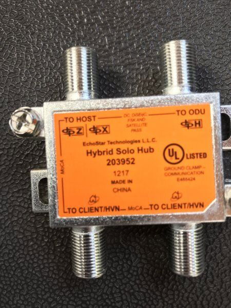

Do you have more than one Hopper? If not, then there is no need for the Duo Hub. What you want is a Solo Hub instead.
Forgot to mention 1 only have trouble with 110 I've also just noticed that the 1000.2 the arm that hold the lnb is the worng length. What is the correct size
I have 1 but not sure where to plug the the 110 119 and 129 also the receiver if you would be kind enough for you to draw a diagram.

The way you have that set up your trying to use the duo Hub as a switch. You have to connect the 129 dish directly to the 1000.2 Dish. That's why that lnbf has an input and then output from Port 1 on the western Arc to a solo hub

I would like to personally thank everyone who help and gave me the feedback I plugged everything back to my 1000 plus with 42 switch it fixed everything it sees all the satellite without a problem and I receive all HD channels. I think I needed the 1000.2 with the hybrid lnb to Authorise the hopper 3. So glass eye in the middle 129 on other balcony.
