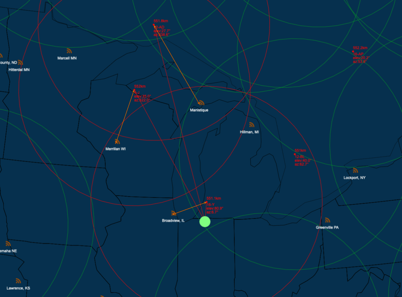

The latency of Starlink depends on many factors, mostly how close your terrestrial Starlink terminal is in relationship to the Starlink ground station. Where I am, the Starlink Ground Station would either be located in Broadville, IL, or Hillman, MI. So, the trip up to the Starlink satellite at 550 km altitude, back down to the Earth station, and from there it's just like any other Internet provider concerning latency.
So, assume 550 km up and 550 km away, that's roughly 778 km, or 777,817 meters. Light travels 300,000,000 m/s in a vacuum, so the travel time up and assuming a similar situation for the trip down, yields a little over 5 ms for the outbound leg, maybe adding 1 ms for internal processing time in the satellite. So, Starlink could add just under 15 ms to the "normal" terrestrial Internet travel time. My attached example doesn't attempt to figure out the actual distances involved at this moment in time where I had three possible paths to the Internet backbone. If I were attempting to connect to my work system, the additional travel would pretty much be the distance up (550 km), the distance down (550 km), and the backbone time from Broadville, IL to our Corporate datacenter near Chicago. But, that would be the best case, and it would probably jump up another 15 ms if my Starlink used the Wi or MI ground stations.
I would say it's not the latency that "kills" Starlink for time-sensitive protocols, but the jitter; the wide swings in latency from 15 additional milliseconds on up to 50-60 ms.
