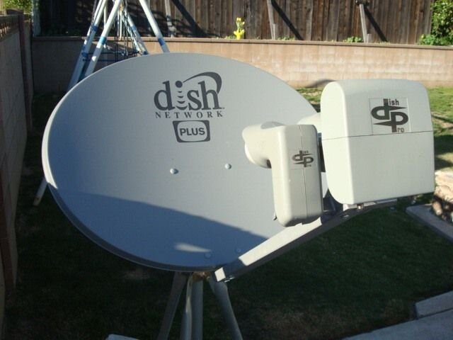

Hey All,
I came across this dish, 23"X30", and could not find a reference to it in the forums. Does anybody know if it is any good for FTA? How about that LNB in the middle?

its pretty useless for FTA
Its a Dish500+ and has LNB's for 110,119 & 118.7
The 118.7 LNB is the oddball as its KU circular. It does the 11.7-12.2 frequency band but is circular polarity. If you can get in the throat of that LNB and take out the dialetic plate the LNB might be able to be used for KU but honestly I'd sell it. Folks who have INt'l channels through Dish use that dish
Thanks Iceberg,
I am wondering if anybody has had success modifying it, It seems big enough for KU since it's width is at at 30".
if you can mod it, the dish should work for KU but it is a little on the small side vertically. Folks use the Superdishes which are 36x20 and they work for KU so this should work fine too
just gotta figure how to mod it properly

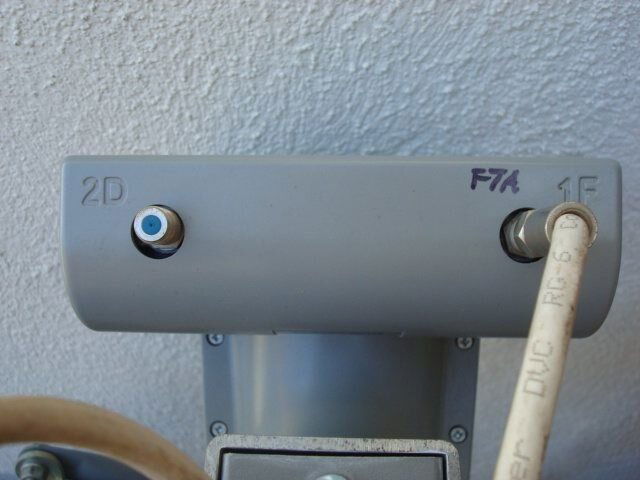

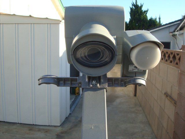

Hey All,
Wanted to report back and let those interested know that the dish and odd LNB will work for some FTA. I tested it on 101 AMC 4 and was able to get some channels: 3ABN, 3ABNLatino, Esperanza, Hope, LLBN and a couple other Int'l.
Also tested for 97 and got some channels there as well. It does not however get all that is FTA. The LNB has two inputs, one on each side, labeled '1F & 2D' and the 1F input worked for FTA, but the other input does not seem to work for FTA.
