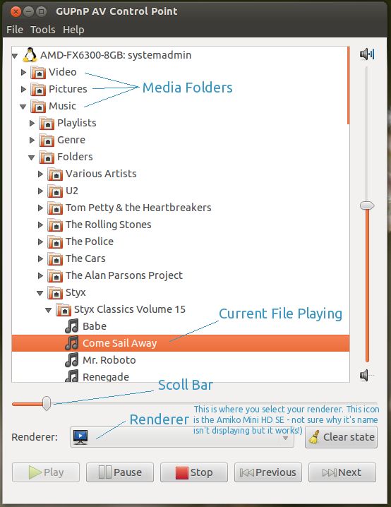

Update: I downgraded the firmware from 10000A00_1.0.71 to 10000A00_1.0.57. Google Maps now works and DLNA/DMR now functions under Ubuntu 12.04 for me. I can push video, audio and picture files to it over the network from my computer using GUPnP AV Control Point and rygel.:)

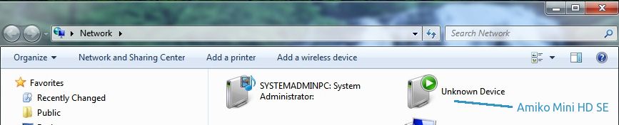

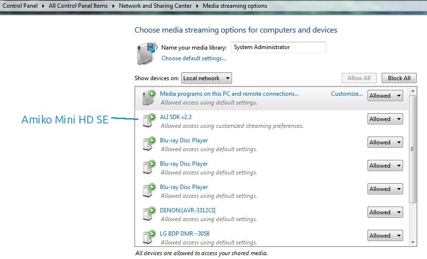

Windows 7 still won't cooperate though. Amiko shows up on network and streaming devices:
But I can't push any media to it. I've tried Media Player 12, Media Center, VLC but nothing.:(
