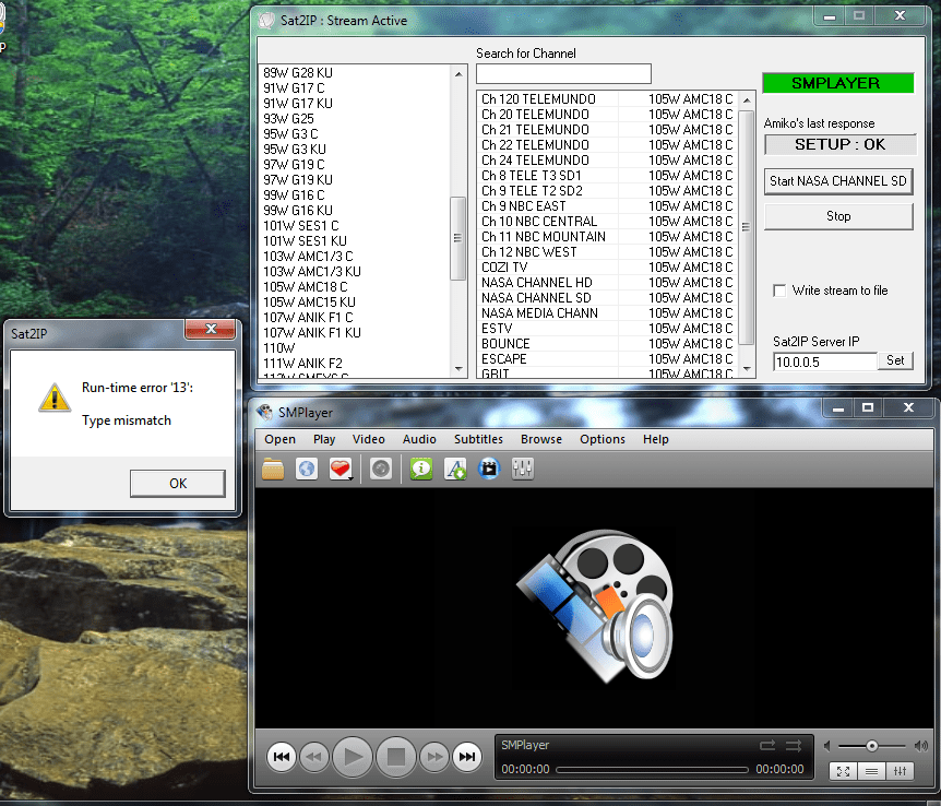

I booted into Windows 7. I installed SMPlayer and Sat2Ip with no errors. I ran Sat2Ip and entered the network address of my Amiko Mini HD SE. The program found it ok and retrieved the sat/channel list - ok so far. When I select a channel to play, I get this error. Gives it for any channel I try to play. Any idea what's wrong? :(
Did you have SMPlayer already running or did Sat2IP start it for you?
Is there an additional component, requirement or something needed in the package? When I was a VB programmer I always included the obvious controls and components, but sometimes I would miss something almost trivial. I would find out some computers didn't have something mine had.

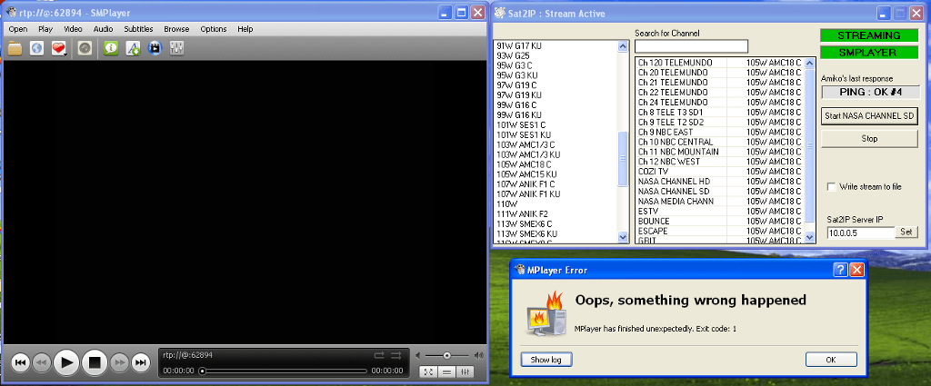

Also, figured I'd give it a try in Linux. I was running Windows XP 32 bit under Oracle VM Virtualbox. Not sure but it looks like things got further (I see a green box appear in the Sat2Ip program that says STREAMING) but no audio/video though and ends with SMPlayer error.
Log shows:
C:/Program Files/SMPlayer/mplayer/mplayer.exe -noquiet -slave -identify -nofs -sub-fuzziness 1 -vo directx, -priority abovenormal -nodr -double -nomouseinput -nokeepaspect -wid 66046 -colorkey 0x020202 -monitorpixelaspect 1 -subfont-osd-scale 3 -ass -embeddedfonts -ass-line-spacing 0 -ass-font-scale 1 -noflip-hebrew -ass-styles C:/Documents and Settings/SystemAdmin/.smplayer/styles.ass -subcp ISO-8859-1 -subpos 100 -volume 50 -cache 2048 -osdlevel 0 -prefer-ipv4 -vf-add screenshot -noslices -channels 2 -af-add scaletempo -af-add equalizer=0:0:0:0:0:0:0:0:0:0 -softvol -softvol-max 110 -demuxer
Error parsing option on the command line: -demuxer
MPlayer Redxii-SVN-r37328-4.9.2 (i686) (C) 2000-2014 MPlayer Team
FFmpeg version: N-67926-g4e9745f
Build date: 2014-11-23 17:46:49 EST
Setting process priority: abovenormal
ID_EXIT=NONE
It didn't have me watching the thread, so i got no notifications. I suspect i am missing a component in the package like fred555 said. I'll message you. As for the second error, that is a problem with SMplayer. See if you can play any particular video with the SMplayer in the linux virtual box.
