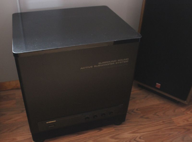

We have an old Pioneer S-W1000 active subwoofer/center channel that I managed to get free about 20 years ago. The parents of a teen gave it away because the teen played music too loud and the sub was really bothering them.

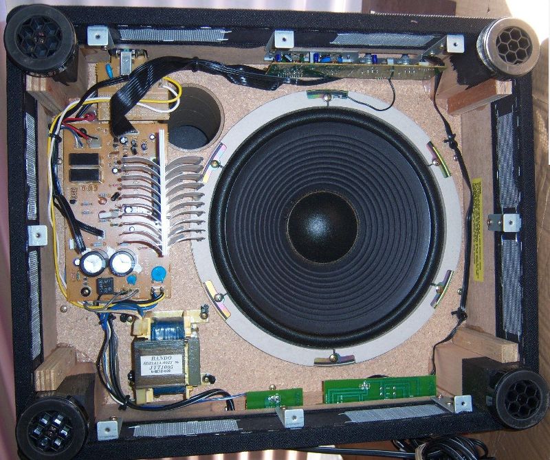

This made a great addition to our home theater setup. Rather than trying to remember to turn it on and off every time we used the system I just kept it turned on all the time. Fast forward to a couple of years ago. One winter we started hearing an occasional crackling sound. Since we had recently received a big snow and ice storm that had started to melt we associated the sound with the snow and ice melting and shifting on the roof. One day the sound turned into large booms and I realized it was the sub. I took it apart, sourced parts and installed all new capacitors. I also cleaned all the switches and potentiometers with Caid Laboratories DeoxIT D5. To avoid having it turned on all the time I added a Russound ACT-1 triggered AC outlet to the 12V trigger on the amp. It has been working great since the refurb! :D
