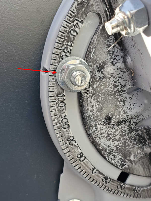

Does This Skew Seem Right
After some googling it seems you are in a zip code in the 780XX region, Dish's manual to the 1000.2 indicate Elevation=48 Skew=121 Azimuth=209 for that area, so it seams dishpointer gave you the skew in the reverse direction (180-59=121).

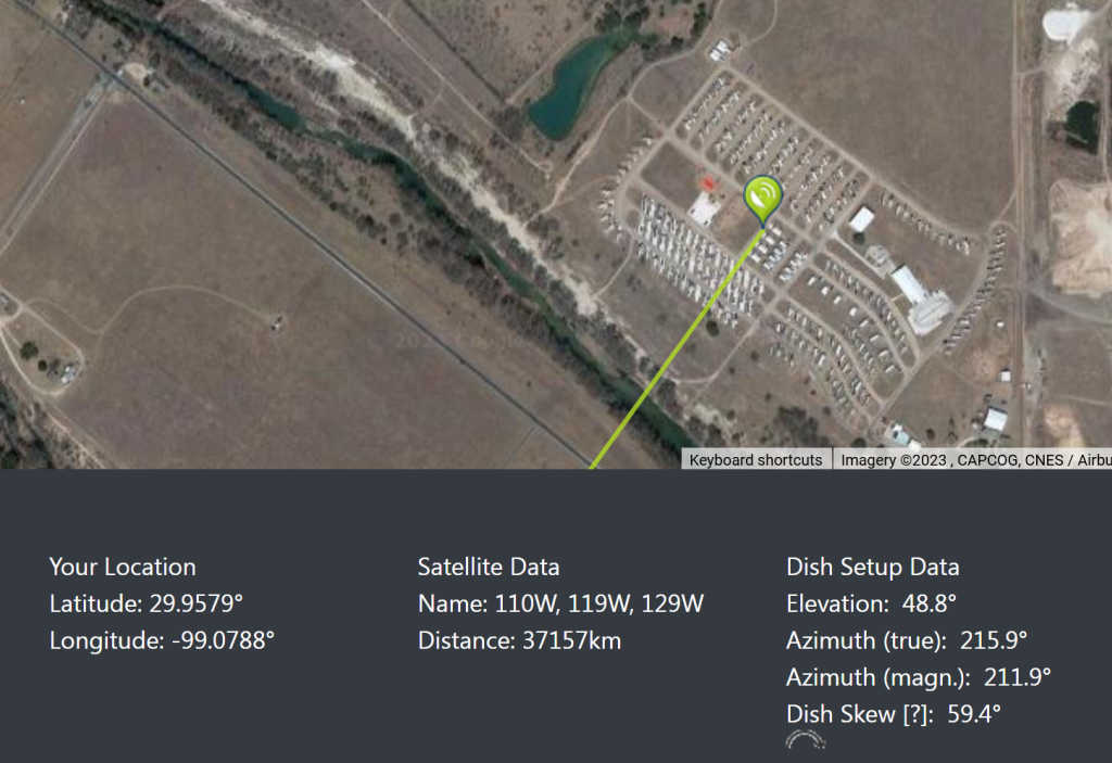

Here's what I get at DishPointer for your location using the multi-lnb listing for the 1000.2 dish and western sats.
Pretty strange. When I use the same lat, long and birds 110, 119, & 129 for multi-LNB, I get: skew 59.4, not 120.6. Subtracting that from 180 gets me 120.6

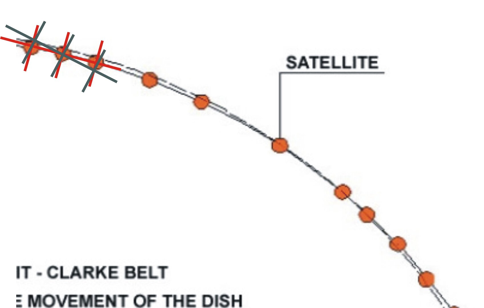

For a twin or triple, skew will be spot on when you can peak signal on the outer sats if the center one is zeroed in.
That's correct, however for some reason. Most places still list a skew for it.
I think a little clarification is needed.See my example? If your dish was aimed true south, as we start out in the c band or ku fta world with polar dish mounts that track the sky.. The lnbf 0, or skew reference would in fact be at zero. If you popped the plastic cover off and looked down the throat you would see the antenna probes aligned vertically and horizontally. Just like a +. Kinda'.
As you scan the arc west. Skew needs to tilt the lnbf to match the satellites apparent tilt in the sky also.
Imagine looking at the horizon through a fisheye lens pointing due south. The horizon no longer looks flat.
If you look east in the camera viewfinder (not moving the camera), you have to tilt your head to the left, or ccw, to get a flat view of your yard.
And the same looking west. Tilt your head right, or cw, to get the Ford in the driveway so it doesn't look like it's in a Joie Chitwood show.
So from the back of the dish looking at the sky.As you hunt for satellites west from true south. You turn the dish clockwise. Again look at my graphic.
You will find in a single lnbf situation if you do not add skew. You may snag a signal and peak your dish for highest readings. But you should add skew to what the listings say for your location. Then alternately tune in a horizontal and then vertical transponder and adjust skew in very small amounts until the signal strength is balanced for both polarities.
Again. Kinda'.

Try using the 1000.2 (110W, 119W, 129W) multi-lnb listing that adjusts for the Dish scale settings.
Yeah, if you use DishPointer, you need to select the specific dish you are using.
