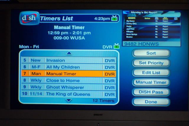

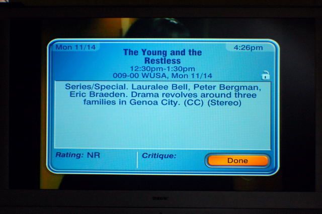

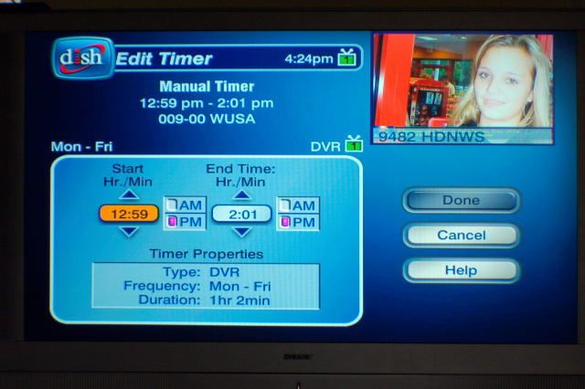

I set a manual timer over the weekend (I don't create many manual timers) and it was set to record M-F, 12:59-2:01pm. The timer fired, but when I went to view the recording I noticed it has recorded from 12:30-1:30pm. I am in single user mode and I was recording a Dish provided local channel (remapped to local channel 009-00 I believe). I am not sure if this problem was noted in prior releases because I infrequently set manual timers. Anyway, here are are some screen shots to show what I am talking about.
