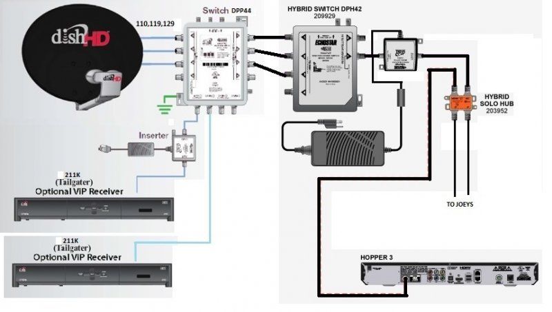

This is what I was thinking. But have one question, can the power inserter for the DPH42 be installed between the solo hub and the Hopper 3 or does it have to be between the DPH42 and the solo hub as shown here?
I saw the attachment, that is what generated the question. I guess I'm basically asking will the solo hub pass through the power if the inserter is installed on the Hopper side.
The reason the power inserter is upside down in the attached pic is because the inserter's To Switch port is to the DPH42 switch and the To Receiver port is to the Hopper 3's To Hub port. View attachment 127186 View attachment 127186
