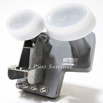

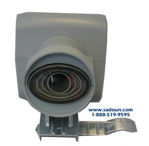

Will I be able to connect the 118.7 output of this LNB to the DPH42 for my international channels?
Thanks for the response.
The reason I asked the questions is because the DPH42 installation guide shows the newer LNB with the built-in switch for 118.7.
I wonder about that too and don't have any answers for you. Maybe someone that knows more info about that can help. My 1000+ has the DPP LNBs only that has four coax to the DPH42 switch satellite input ports.
