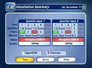

So this weekend I switched the LNBs from the dishes and my 119 LNB was working great on my 510. I was getting all CONUS transponders! Signal strenght and channels ok. Working great for a couple of days. So I thought it was a faulty LNB that was giving the errors on the receivers.
Today, I got the nag screen on some channels and once again can't get even transponders on my 510! So now I got two LNBs (119 & 110) with only odd polarity!
What the hell happened!?
:what
I had already placed an order for a new DP Dual LNB. Am I gonna' have to replace the switch as well, and get another LNB?
Tried to test the transponder signals with a DVB-S tuner and it doesn't get any even transponders as well...
