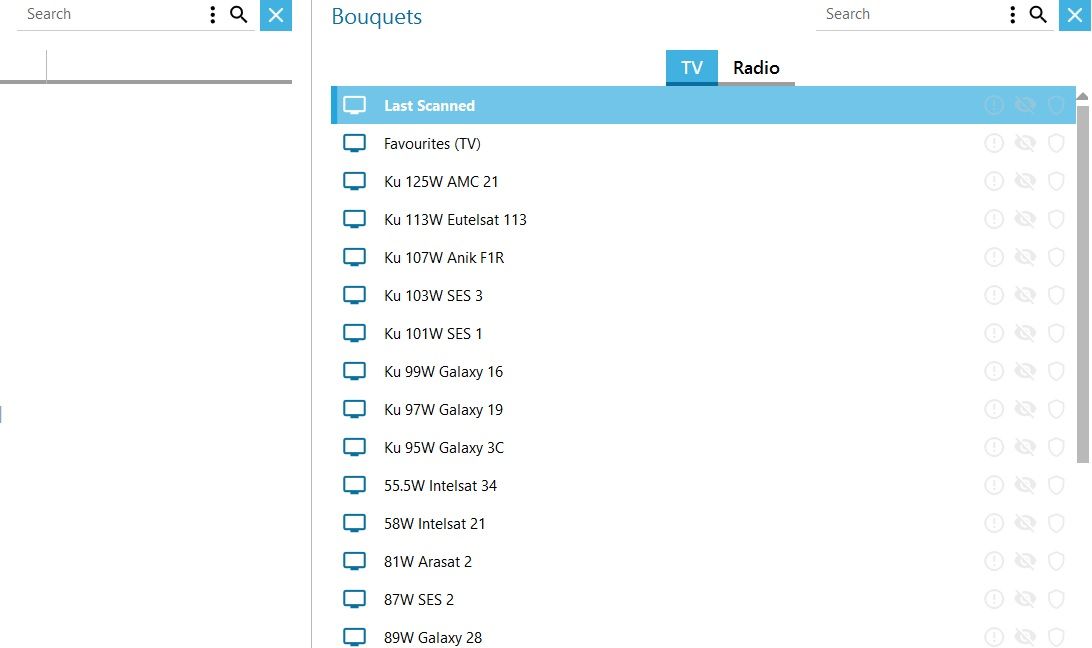

Since day 1 using a channel editor I've always placed channels arranged like the photo. It works. Dish counts stay put.
Channels on charts differ from what the receiver shows after a scan. Like 3839V SID 0X10 may be Me TV.
