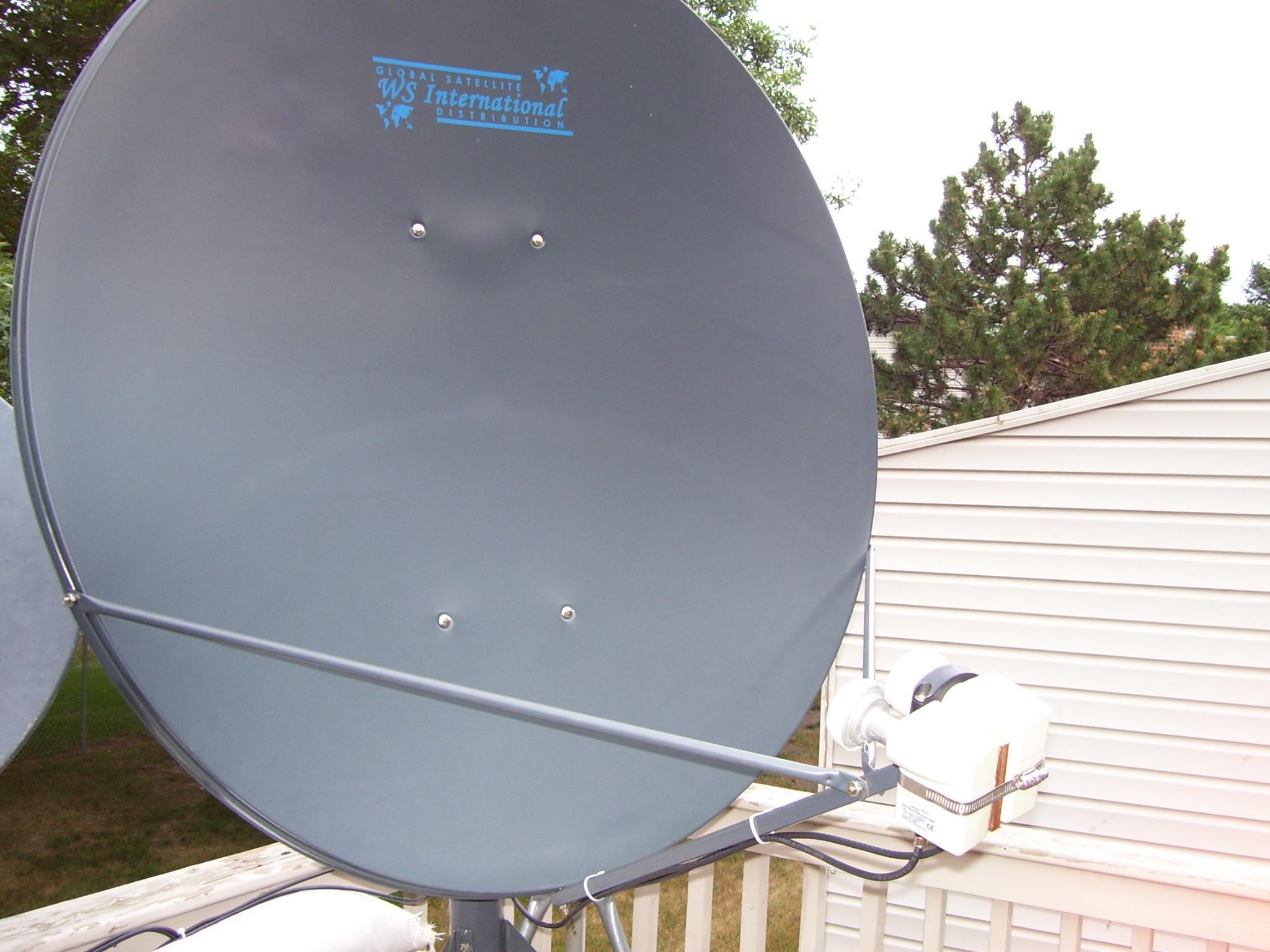

Thats what happens when you have dishes on the roof and on the deck...the dish on the roof was partially blocking the dish on the deck
Moved the dish on the deck back to 107.3 and moved the motorized one to 111.1 and now its all working :)
upgraded the setup and now we have numbers I like :)
moved the 1.2m dish to 111.1 and now I get some better numbers

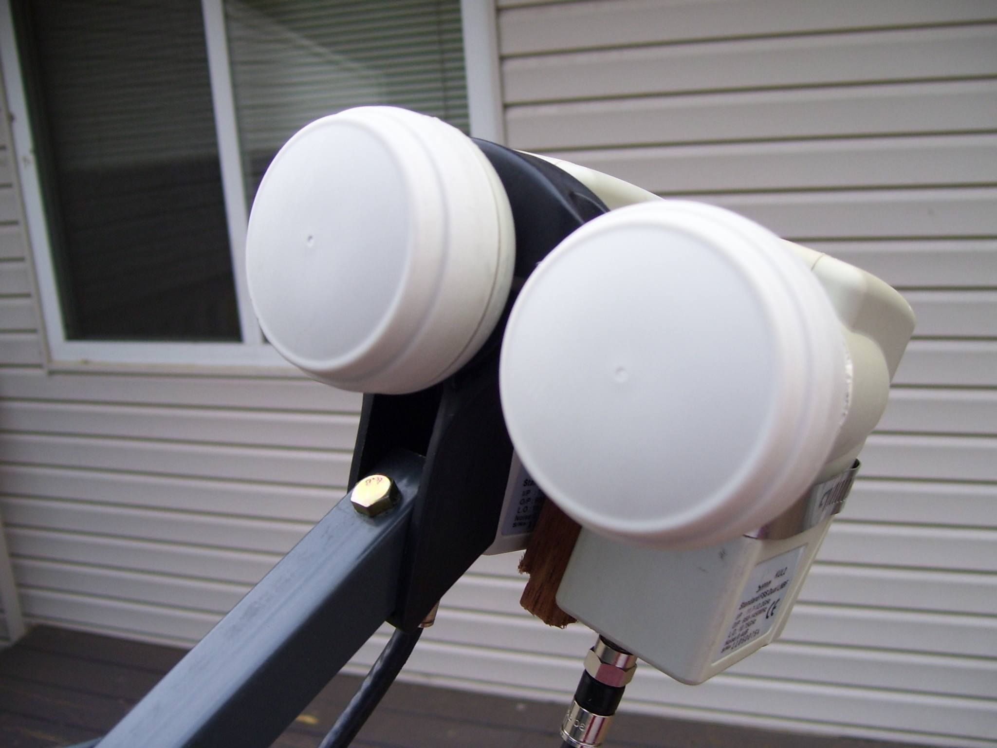

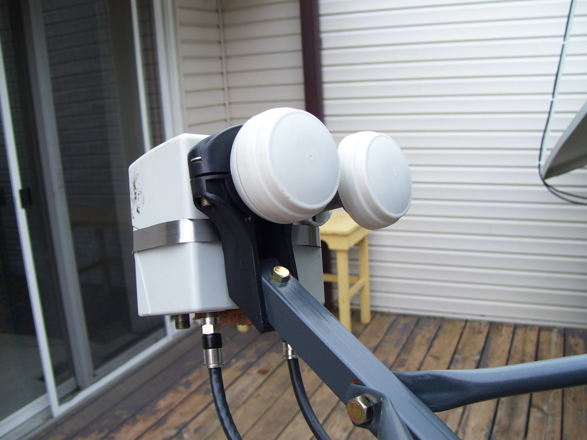

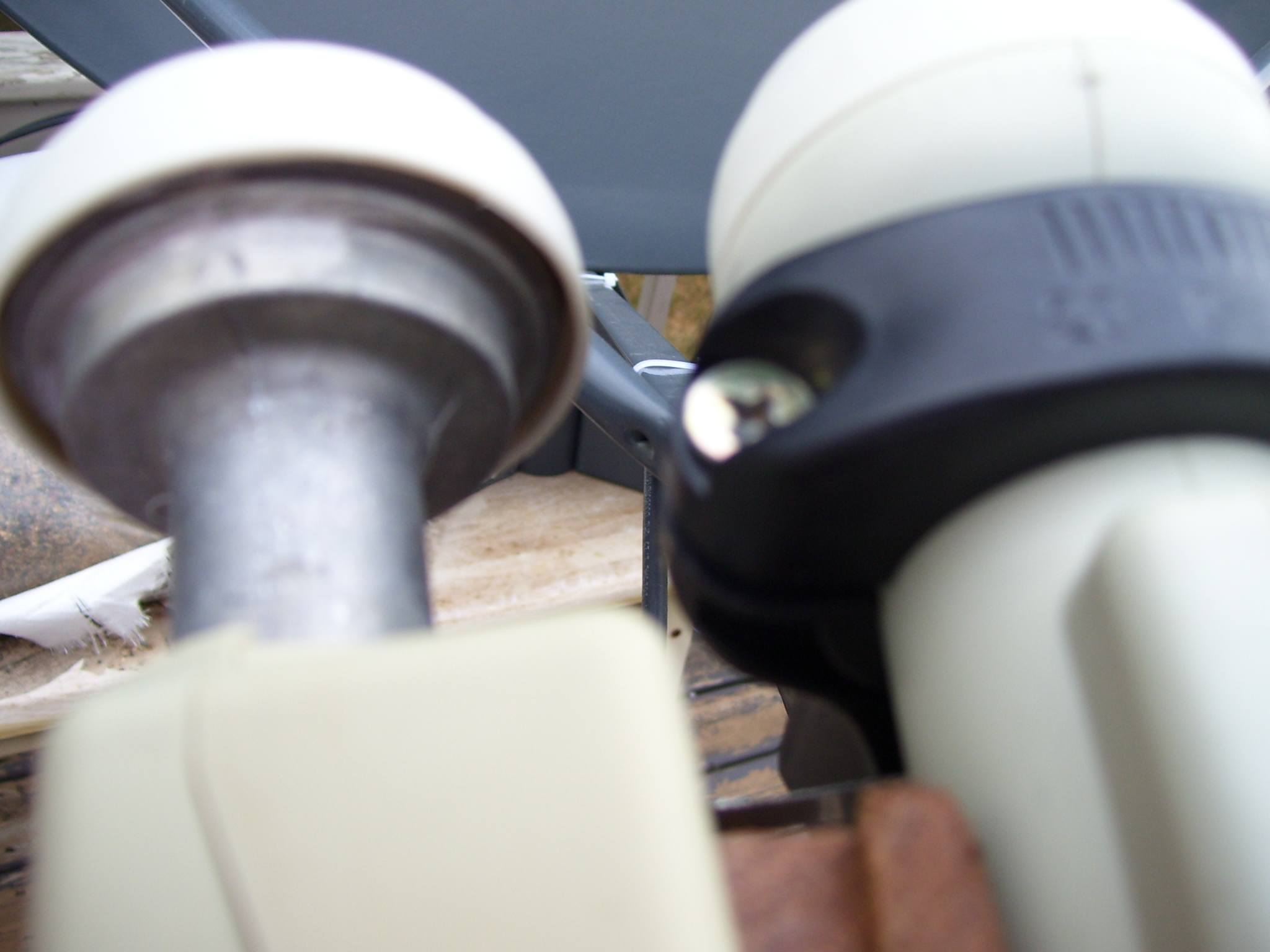

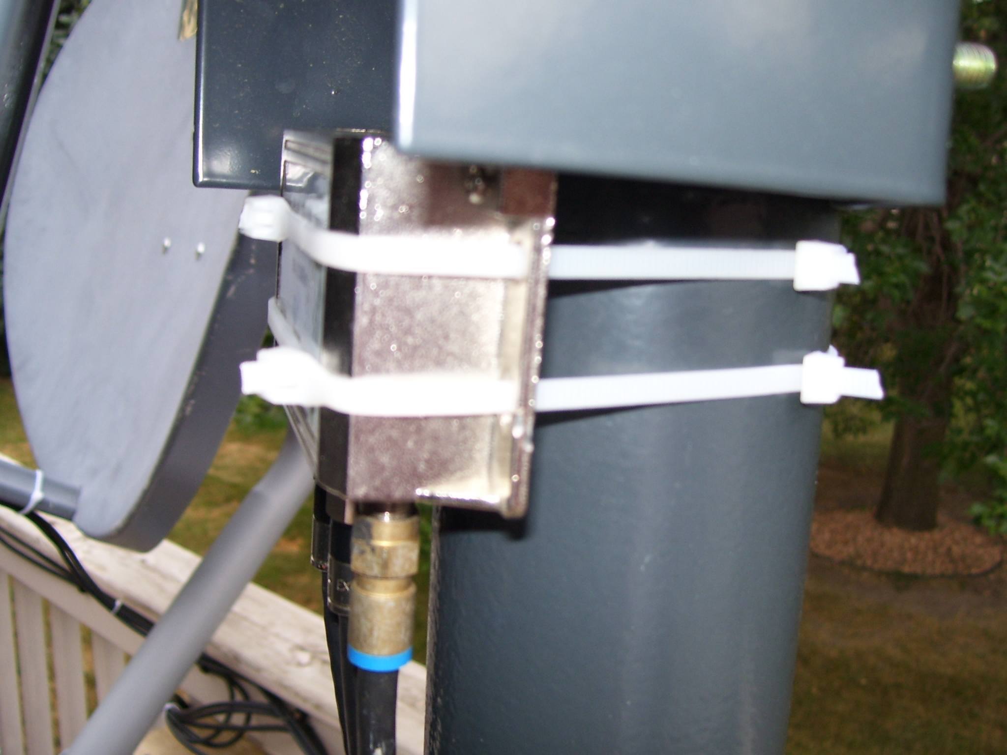

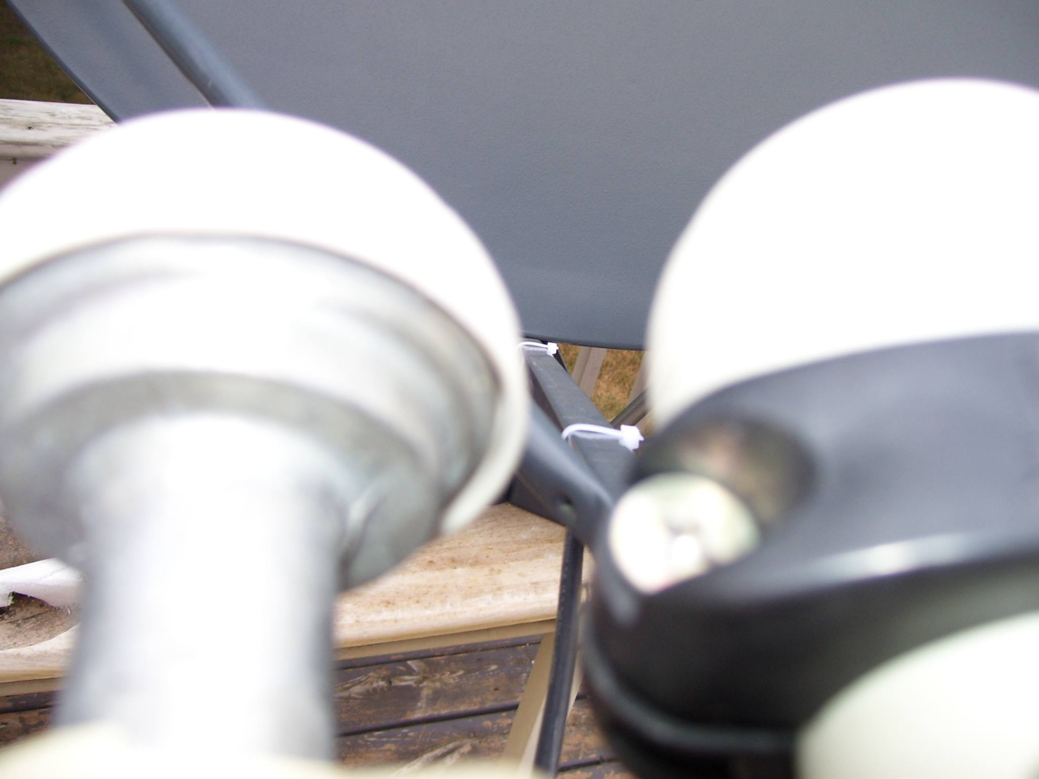

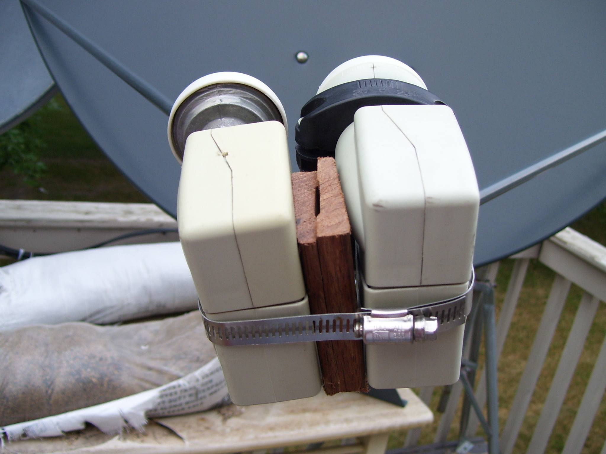

Added a 2nd LNB for 107.3 and ghetto rigged it (thats what I do best) and got really good numbers

HD on AnikF1 is at 7.8
and some pics :)
