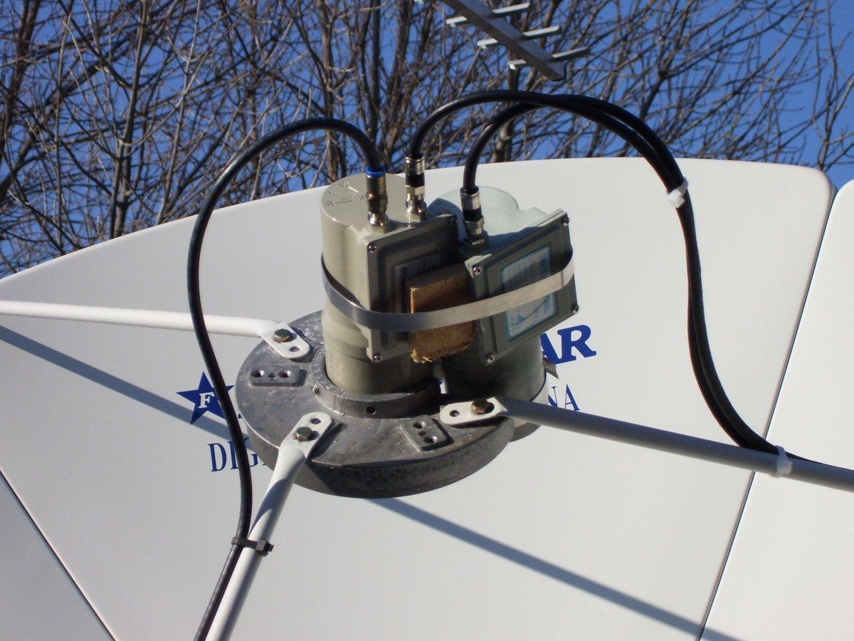

since the dish is fixed, I manually skewed it. If its on a motor/actuator, you would set the skew up to 0 on your true south like KU and it will automatically skew when the dish moves
Ice does the feedhorn on the Dual output C-Band LNB stay stationary and just the LNB itself skews? It is going to be a fixed dish. I have an actuator arm I may hook up later on. Thanks for your help Ice
you skew the whole assembly. The scaler rings stay in place and there is a screw you loosen and manually skew the dish. Thing to remember is it seems like most of the C-Band LNBF's are off by 90 degrees so the 0 side is at 9:00 and I skew from there
see the attached. Its at G4 which is only 6 degrees off my true south (T6)...note its skewed at 9:00 or so
Thanks Ice I see how it works now...:) I'm going to get my BUD tomorrow probably take me a few weeks to get it setup because of work schedule.
