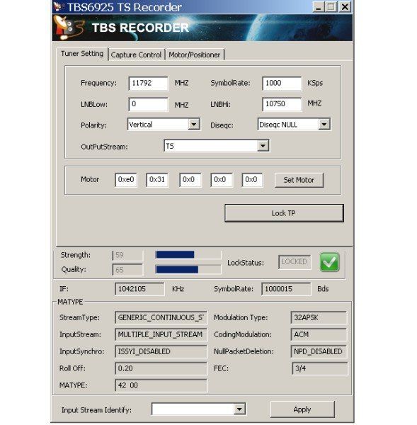

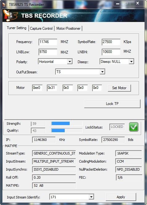

I think at the moment only TBS6925 PCI-E support 16,32APSK,ACM,VCM modulation, It also support Blind Scan.
