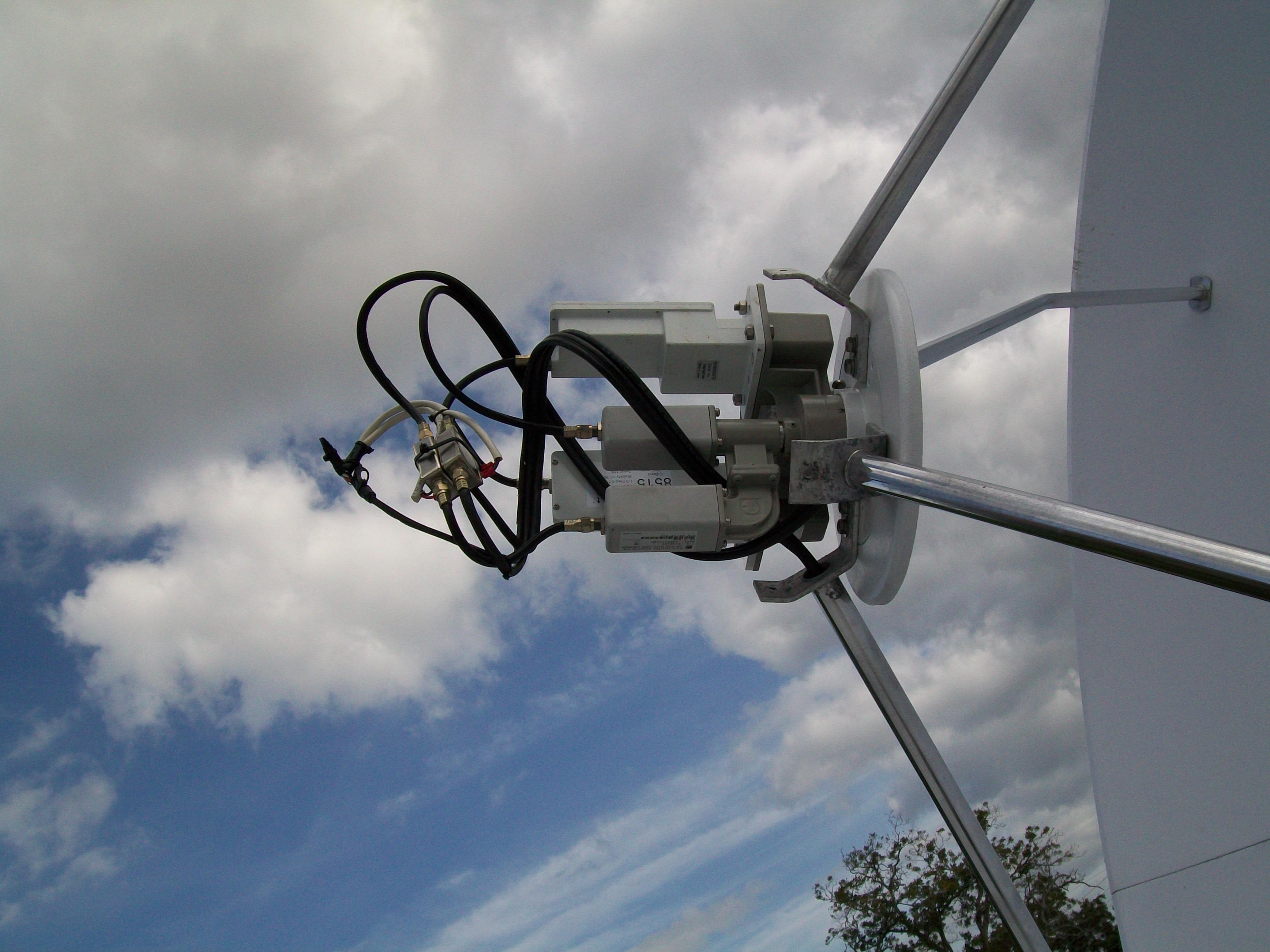

as far as lnb's I use a few different models Cal Amp Extended Professionals, Galat, Japan Radio, and Norsat, like the cal amps the best, even though a pair of my Norsats are PLL. as far as a noise level (or Kelvin) it does not matter much, what people should be more concerned about is stability of a lnb that is used, an you're 35K old lnb I would say that it may be more stable than the BSC that you are using now. I use no servo motors here on my feeds all ortho's, due to that they will deliver the best signal of any kind of feed out their today. now what a ortho is, it is a feed with seperate lnb's for each polarity an band that is used for.
here is a picture of one of my ortho set ups.
