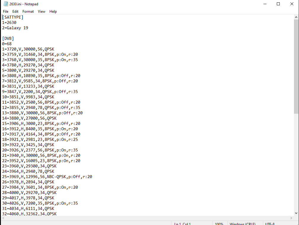

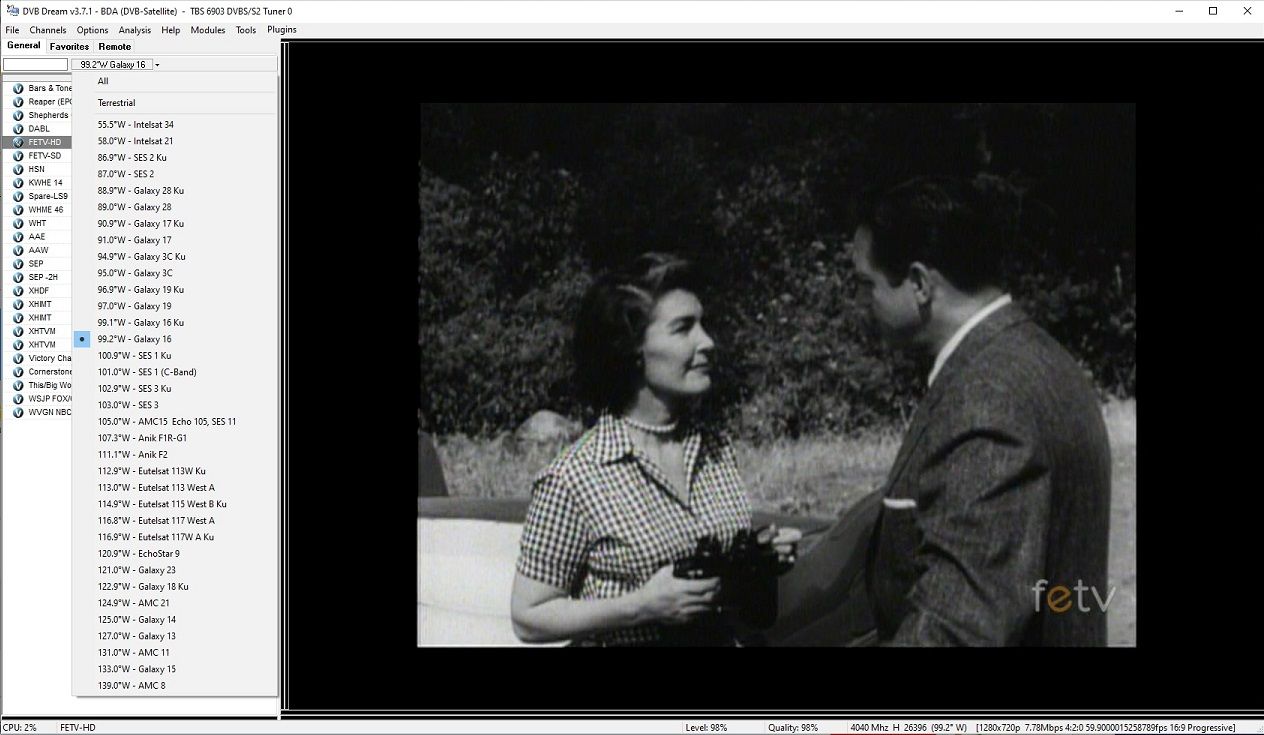

I have it set up both ways on different PCs. One has two installs of DVB Dream and the Ku dish on one tuner and the CBand dish on the other. But on my main PC I use just one install of DVB Dream. You just need to arrange your transponder ini files correctly.
Transponders.jpg SatList.jpg The Ku sats are 1/10th degree off the CBand sats by ini file. This is how DVBDream keeps track of the Satellites. You can name them anything you want in the INI file line info.

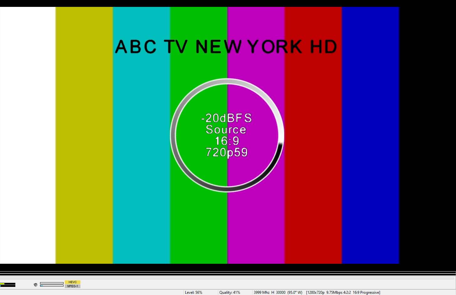

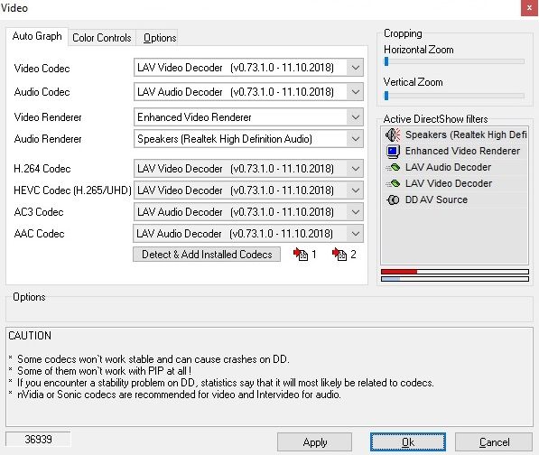

Thank you for your reply. I have a couple more questions if you don't mind. Which codecs are the best to install? When I play some 4:2:2 I get micro blocking. Next, is there a way to get the signal level and quality indicator on DVB Dream to match an STB. My Mio shows much higher levels.

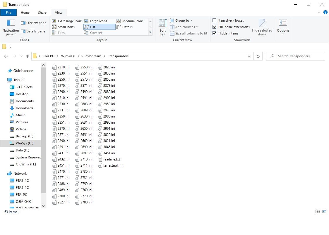

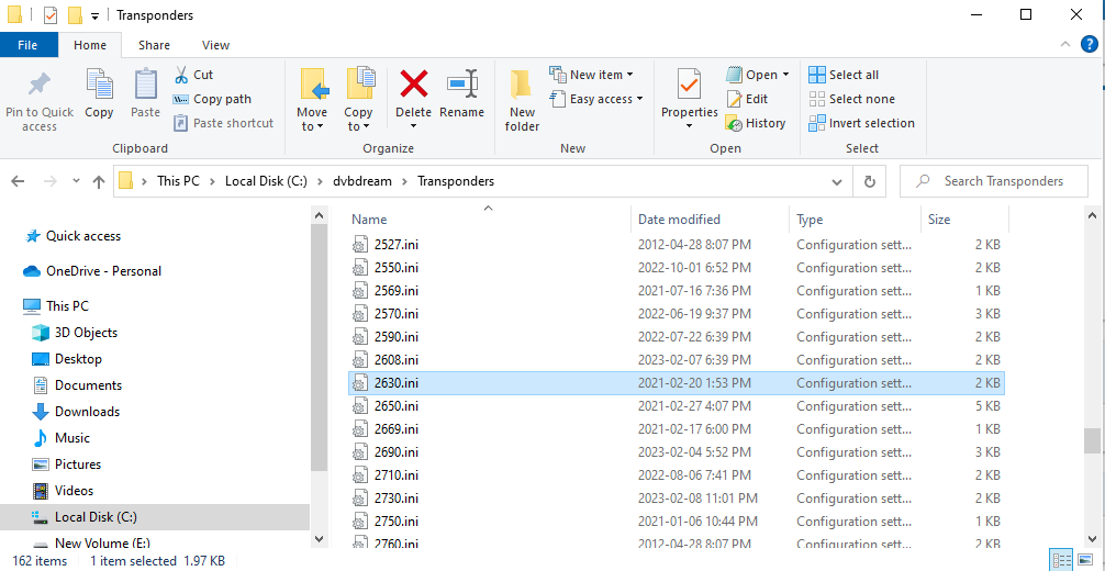

Sorry to dig up an old thread. I have some free time today, so I thought I would get my DVBDream working properly once and for all. I would like to manage both C and Ku all in one session of DVBDream. As I mentioned above, DVBDream installation menu only has one satellite listing even if it is a hybrid satellite.
I have attached a screenshot of my folders. As you can see 2630.ini represents Galaxy 19 (97 w) which is a hybrid satellite. How do I add Galaxy 19 Ku to the list?
I appreciate all help.
