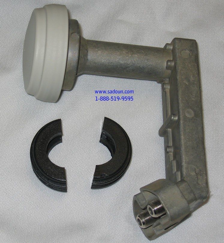

Hmm. I just bought this cheap. cheap. Dish from Sadoun. Eagle Aspen 20" thinking I could attach my Ku lnb or a dish lnb so I can receive NASA channel on Ku.
I have not found a LNB that will fit the holder. Any one know what will fit? A dtv lnb is too lose.

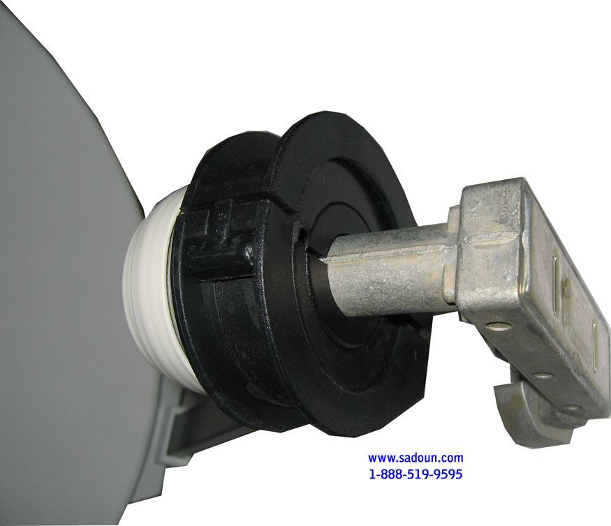

Try to take the plastic shroud off the LNBF and then mount it on the dish as below:
oh ok. I was thinking that LNBF looked sorta skinned. :D
That worked. Thanks.
