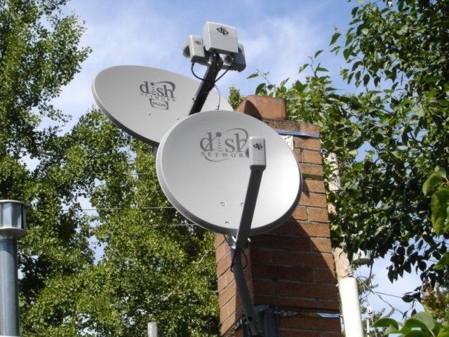

I have the HD Absolute pack and two dishes, a Dish 500 pointing at 110 nad 119 and a single Dish pointing at 61.5. Why would I want to change to the Eastern ARC. I am happy with two dishes. Is there any other advantage to Eastern Arc?

Would it be possible to hit 72.5 and 77 with 2 separate 500 dishes?

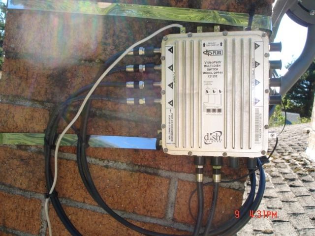

What extra switches would be needed. Presently have a dish 1000+ and a 129, feeding into a dpp44 switch to 2-vip211 hd receivers.

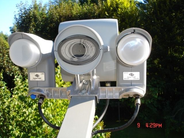

Any Dish satellite slot can be received by any single Dish Network dish with a single Dish LNB mounted on it.
The only exception is 118 (international and locals), which requires a special LNB, IIRC.
Switches should work the same for any slots, i.e. a 4 slot switch should work with any 4 slots.
Currently, there are unpredictable results if you have the same channel coming from one more than slot, in other words, you can't currently make it choose the slot you want.
Dish 1000 family of dishes has various special stuff for receiving three slots that you may need to disable, if you want to use it for one or two slots only.
Here is the relevant equation from The Diffraction Limit of a Telescope:
What you want to use is the lowest frequency transmitted by Dish satellites, and the dimension of the Dish 500, in order to find the "diffraction limit" of the dish. This is the minimum angular separation (between satellites) resolvable by the Dish 500. We leave it as an exercise for the reader to convert frequency to wavelength. ;) Also note that this angle from the dish cannot be directly compared to the difference in orbital longitude locations, because the latter are referenced to the center of the earth.
Geeze....talk about a paradox.
Not a paradox, just physics. :D
