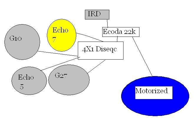

Just got my Ecoda 22k switch and put it inline. Yes, it does allow you to cascade 2 Diseqc switches as discussed in previous threads.
System works like a charm with the Ecoda 22k switch separating the LNBs/Diseqc switches. No more slow switching. I recommend the Ecodas over others as of now. :) :hungry:
Next, the 8X1's are heading to my shopping cart.
techno is that a replacement for these cheapo 3x4 switches I use on my primestar dishes to get H/V on one line?
EDIT: This doesn't replace 3X4 multi's.
This can replace your existing 22k switch, and also is the only switch that can pass Diseqc commands.
This means, that both sides of the house can have a 4X1 Diseqc (or 8X1) and be switched between the 2 sides with that one Ecoda switch.
Also eliminates "homerun" cabling as described by one of our members. :)
My house is an odd situation. Trees are all over but I have LOS for different birds on 2 different sides of the house.
East side of the house is my motorized dish, but the LOS for sats further west (123 and so forth) aren't as viewable due to my mango tree.
This is where the 22k switch comes in, accepting my cable from the west side of my house which has a 4X1 for G10, Echo 7 (NASA), Echo 5(WOUB), and a future fixed position which I'll probably pick tonight. Maybe G28 or G25 depending on what I watch more. (I watch more of ABC News Now than I do G25)
So, we shall see!
I guess I was reading into a bit more than that. I just wanted it to be complicated I guess. :)
Here is the setup. There will be an 8X1 to replace the 4X1 eventually to accomadate C-band in the future.
8X1 will be added on the east (motorized side) one of these days.

Now, another update:
This setup limits useage of a Universal LNB and if you choose to use one on this setup, you are limited to one freq. band. Hi or lo.
I use the standard linear LNB on the motorized setup to view the limited highband stuff. (without a universal)
