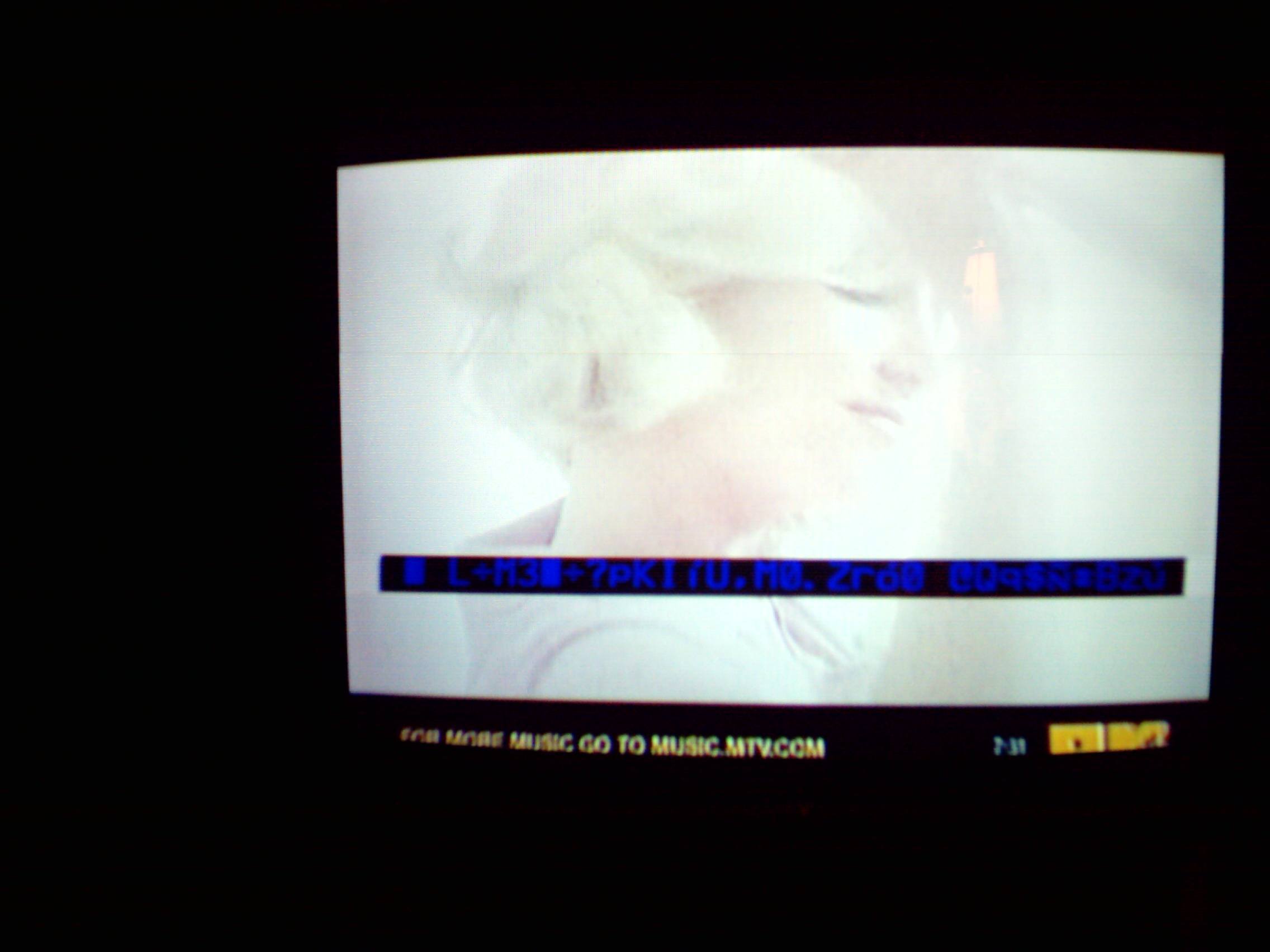

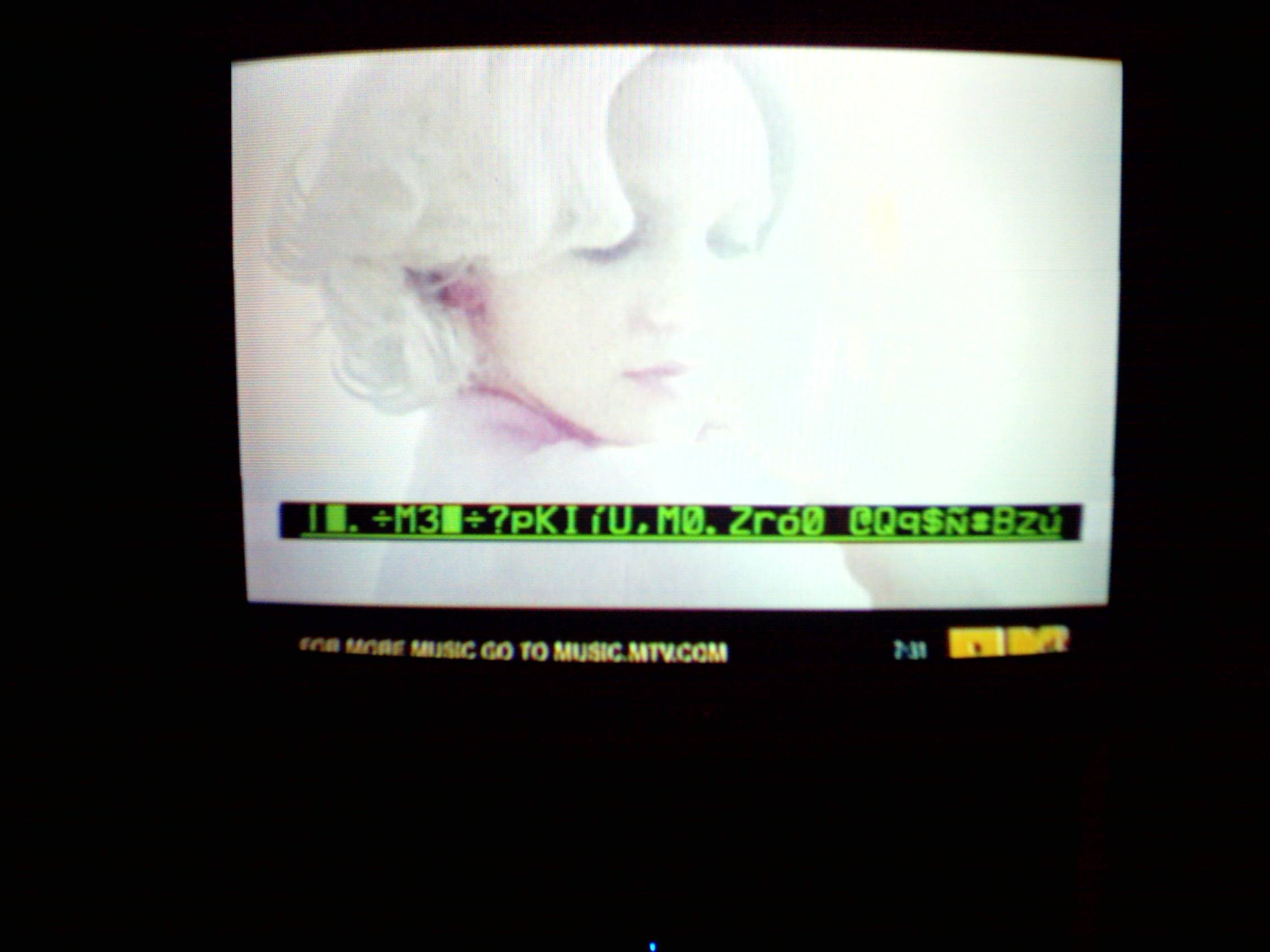

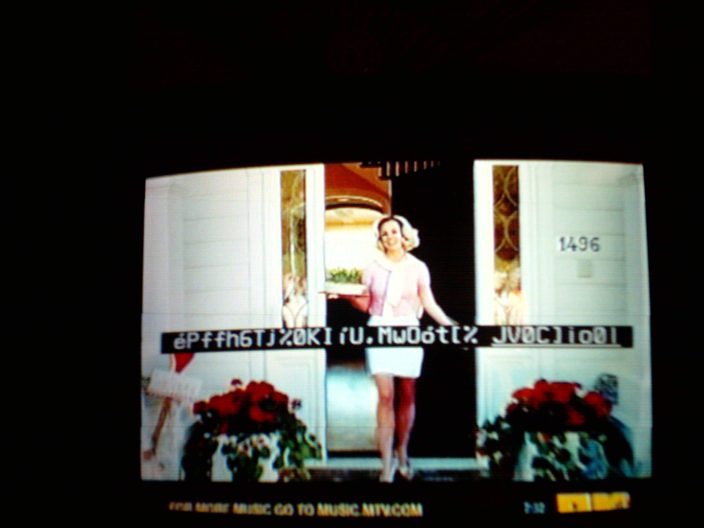

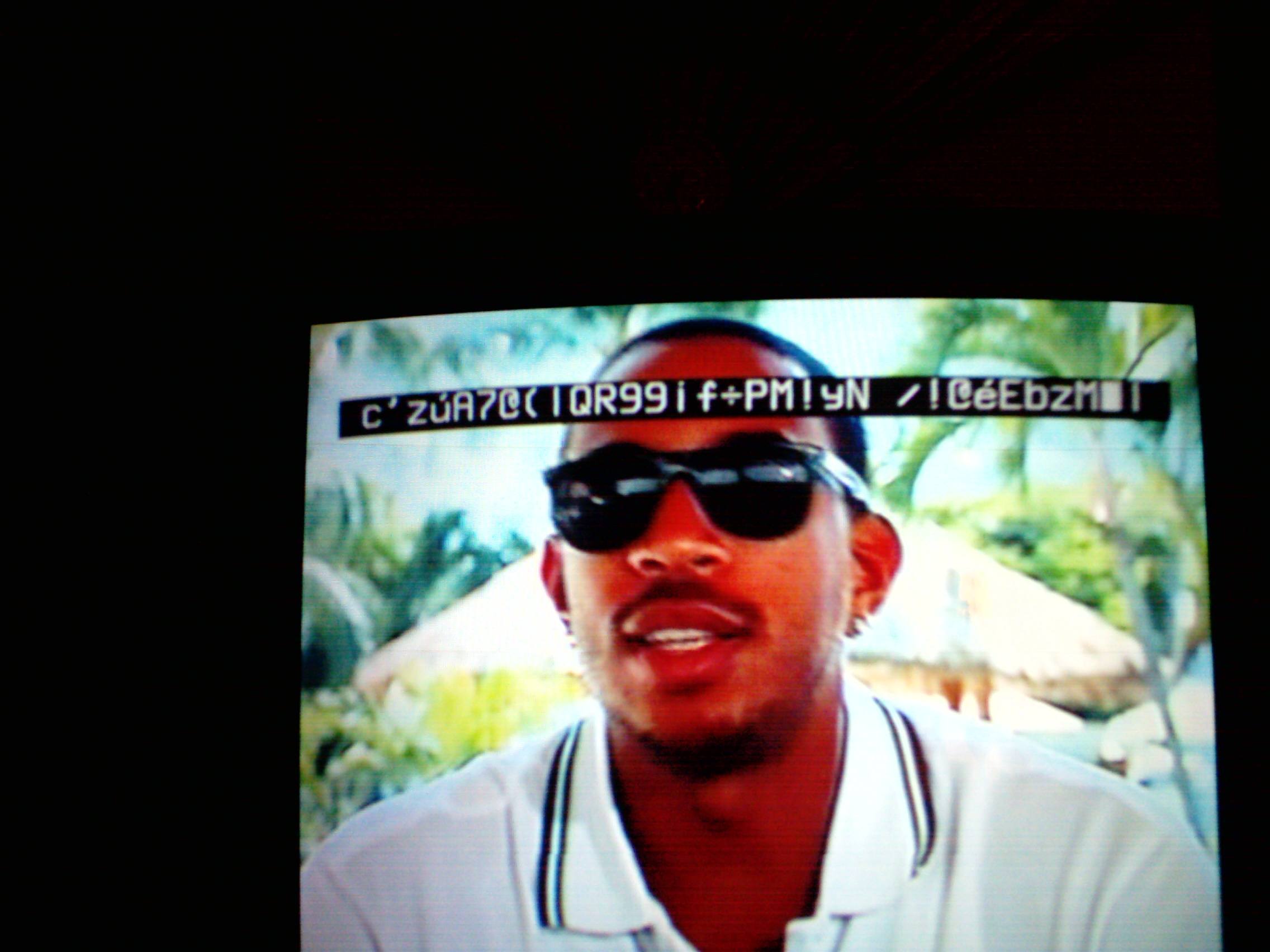

I have posted photos of encryption messages that appear occasionaly on our DirecTV television screen. Has anyone seen this happen before ? I Googled some of the encryptions and brought up results. Some of the characters are of various languages.:rant::confused:

It only appears on 3 or 4 channels. Not always on. Just at various times on clear days.I usually watch MTV2 or Fuse in the mornings before work and appears on those channels. Some of the encryptions appear and reappear. Some never appear again. The locations of the encryptions appear in different locations on the screen. At the top of the t.v. screen then in the center, then at the bottom , then in the corner. Almost as if they are text messages?
Try to verify whether it's the DirecTV receiver or the TV that is showing these.
Check closed captioning.
BTW, what model receiver are you using?
DirecTV were here in August 2009 and restarted system. The menu settings ( for recording scheduled shows etc. kept appearing ) After there $50.00 service charge it still appeared after they left. I just turned off the recording menu on the t.v. and it has not appeared again. What is appearing now is totally different. CC would take the actual audio and convert it into alpha characters correct?
If the phrasing on the channels is converted to CC then several nouns and verbs would reappear . Also how could someone speak in several languages at once?

While I am not a linguist, I do know a couple of languages. What you are showing are not any languages that I am aware of. I don't recognize them at all. If anyone sees another language word in the captions, I would be interested to know what words you are identifying.
It still looks like a closed caption error to me. You say CC is not set up. It must be actually set to OFF in most cases. There are often several CC settings, CC2, TXT1, etc. It could be inadvertently set to one of those settings on either the TV or settop box.

As Lt Disher says, this is almost certainly caused by one of the "unused" closed caption modes being set to "on" on the TV itself. It's quite a common problem.
FYI, CC has nothing to do with converting the audio to text. At least not as you imply. CC is a function of humans actually entering the text to go with the audio. This text is encoded into the broadcast signal and decoded when a CC setting is enabled.
In the case of local newscasts, usually the closed captioning is generated by the prompter which the anchors are reading from, if they ad-lib it won't show up in the captioning.
