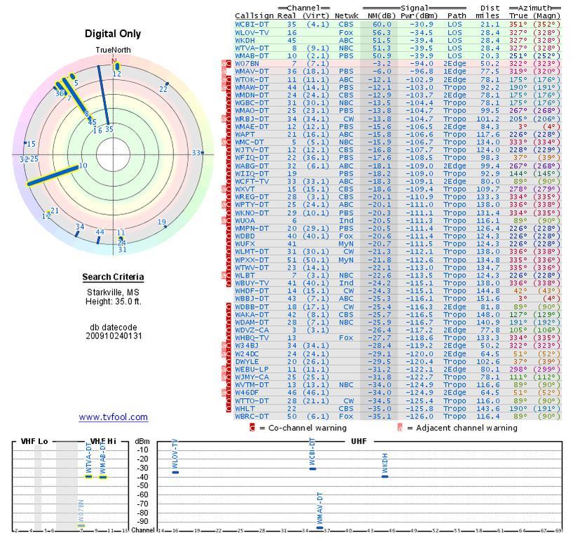

I checked Antenna Web for my address. It indicated I could get these locals OTA with a flat multidirectional antenna and preamp. Bought one for each TV and the best I can get is 55% signal with CBS HD IF there is no rain within 600 miles! LOL on the 600 miles part.
You can move to either and be in beam. HOWEVER, based on this current info shown, at under 30m, with the correctly selected and aimed UHF/VHF combo OTA antenna, you should have no problems getting your OTA signals. Not sure what a "flat" multi-directional means, but you need something like this - mounted above the roof line.
http://www.solidsignal.com/pview.as...Antenna-(5884)&c=TV Antennas&sku=716079000734
OR
http://www.solidsignal.com/pview.as...M-HD-(CCS1233)&c=TV Antennas&sku=716079000659
