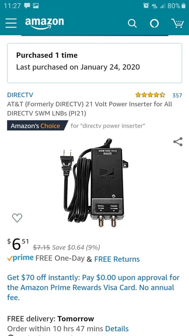

This is what I ordered from Amazon

What box did you buy off of Amazon? A 775 error usually means your power inserter, the item in the picture you posted, isn't providing power to the dish. Is the green light on the power inserter already have on? Perhaps you unplugged it somehow.
I got the Swn(?) Not sure what it's called but it is hooked up to the main box. No my old one did not have any light and it was plugged into the wall. From what they told me when I called, the black box that didn't have a light on it was how the receiver communicates with that satellite dish.
Please excuse my ignorance on this matter but what exactly do you mean by power inverter exactly?

The power inserter is the box in the picture you posted. It provides power to the dish. Make sure you have it connected correctly. The port labeled ird goes to the H24, the other port goes to the dish. There must be a splitter somewhere. The power inserter, if between the splitter and the H24s, must be on the power passing port of the splitter. That's designated by a red line on the splitter.

You can move the receivers around all you want BUT you CAN NOT move the power inserter to another outlet. Only one terminal on the splitters for the house allow power to pass though. In order to move the power inserter to another outlet the connections at the splitters have to be reconfigured. Normally the power inserter is installed at the outlet that is closest to the satellite and should be left closest to the satellite.
