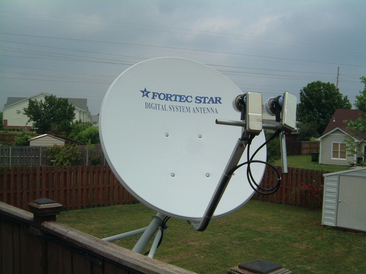

My signal level has gone down to about 55-60 on 82 since the move to the different satellite. I am currently using a 20" dish 500 dish. I do have a 75cm elliptical starchoice dish that I could use, that is quite larger. Is there an adapter I could use that would allow the expressvu(dish) LNB(DPP) to be mounted to the starchoice dish.
Thanks for the help.
When I used Bell I put up a 80cm dish and used a magic bracket. I put 82W in the center and 91W offset. I just took the plastic housing off of the LNBs so they could be attached to the brackets. You could do something similar with the SC 75cm dish. You just have to work at getting the best signal by manually moving the LNBs in/out & up/down until you get the best signal, then adjust the bracket to the best position for mounting the LNBs.
I have this setup. A rectangle, DirecTV lnb will slide right in the arm of the SC dish. I use the SC dish for 82 only and another dish for 91. I went up 7 points from a 24 inch dish on sat 82.
