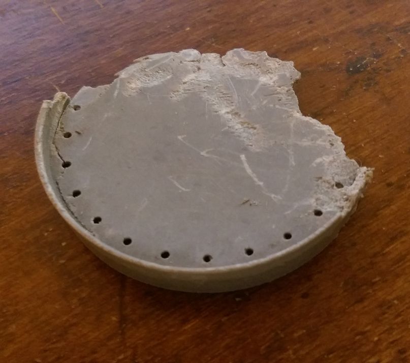

I know there are all kinds of genius ways of making these, BUT, does anyone know where to actually buy replacements like this?

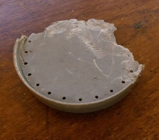

Mine had gotten lose over the years and I would put it back in, finally it fell out and the dogs chewed it up. I have half of a cap now. I really would like a "REAL" one to put back in there. Does anyone know of a place to buy a handful of these?

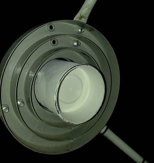

I kept telling my self I was going to do that, but never did. I should have fixed it once I noticed it was loose. So for now I have cut the bottom off of a plastic cup. Will this hurt the signal at all, until I can get one?

Compare the signal quality with each cover. Some materials are not RF transparent.
Is there a material that is, lets say, amazingly RF transparent? I was thinking about some sort of plastic screen or something.

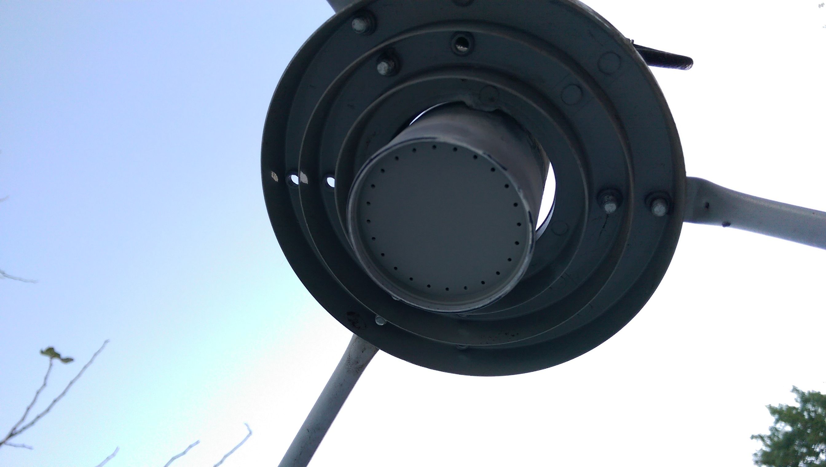

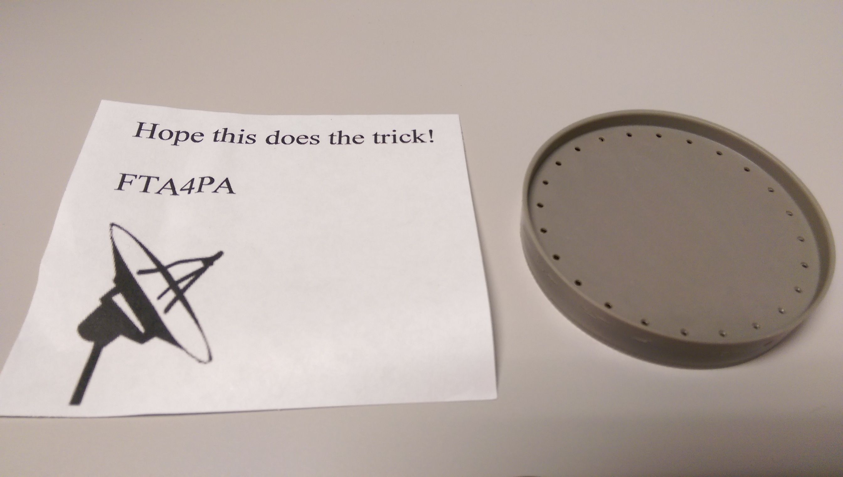

BigRyan, I have a lightning damaged NS741 here. Even if you order a CK1S you are welcome to the NS741 cap so you have a backup - just let me know. :)
An old trick I used was to take a clear plastic cover off a binder notebook and cut a square large enough to cover the hole with an excess. Then run a bead of super glue around the edge of the feed throat, stick the plastic over it long enough to let the glue set, then take a razor blade and trim the excess off around the outer edge of the throat. Then put some holes in it small enough to keep out bees and insects and the problem is solved. Will last several years.
