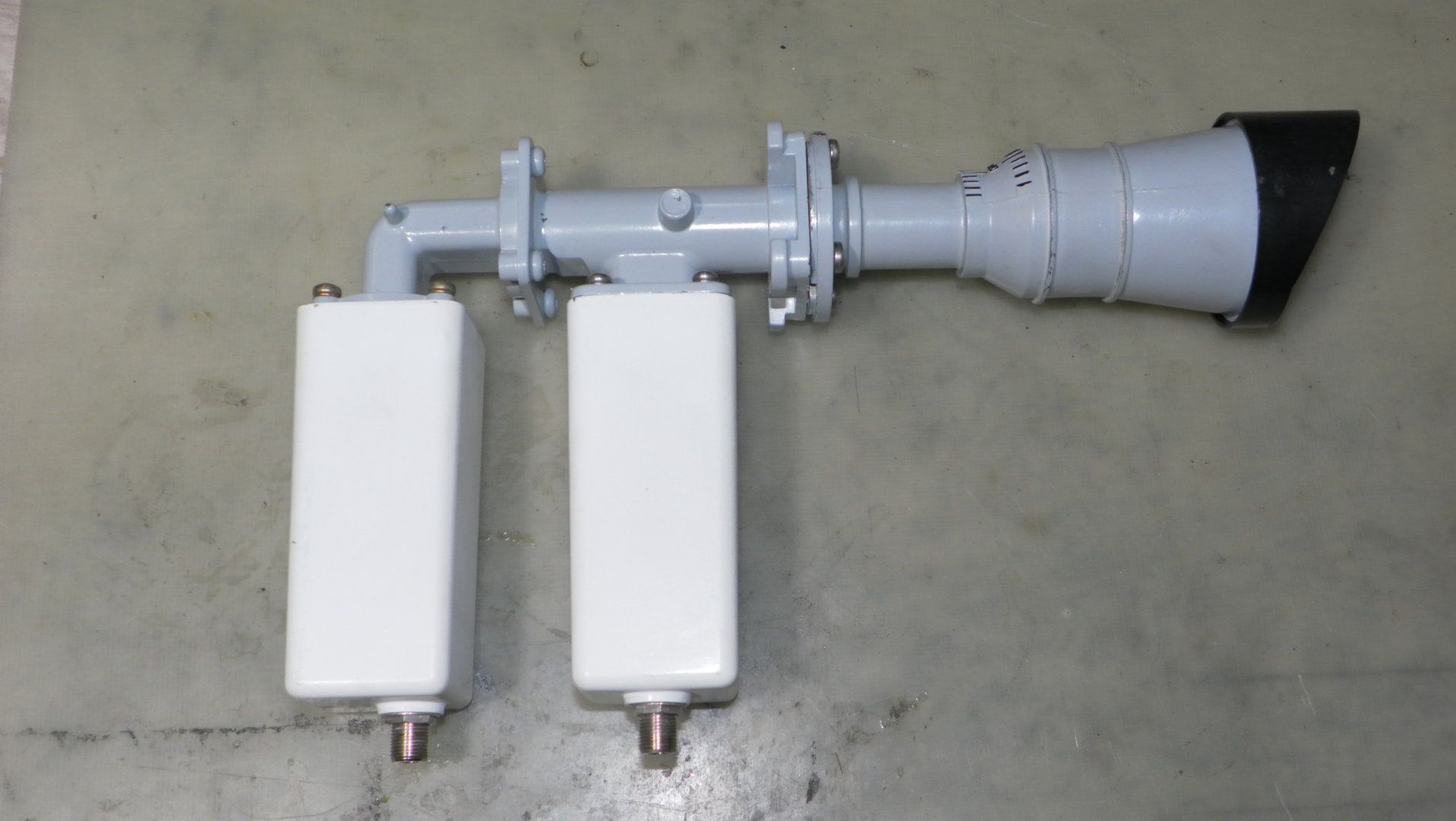

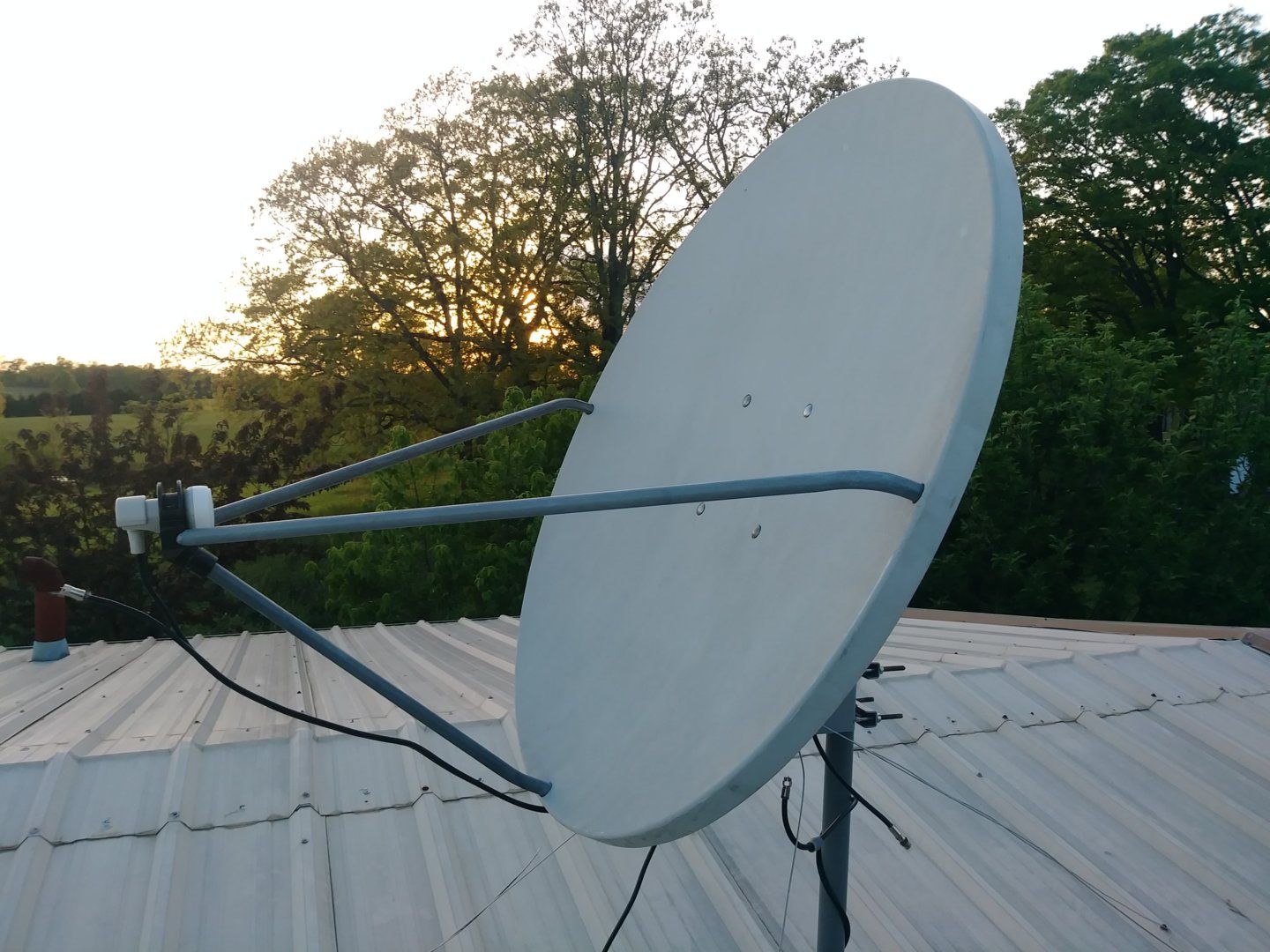

I'm not a fan of fits all feedhorns. But I agree a feedhorn + LNB would be best. I use a 1.2m CM with the factory feed.

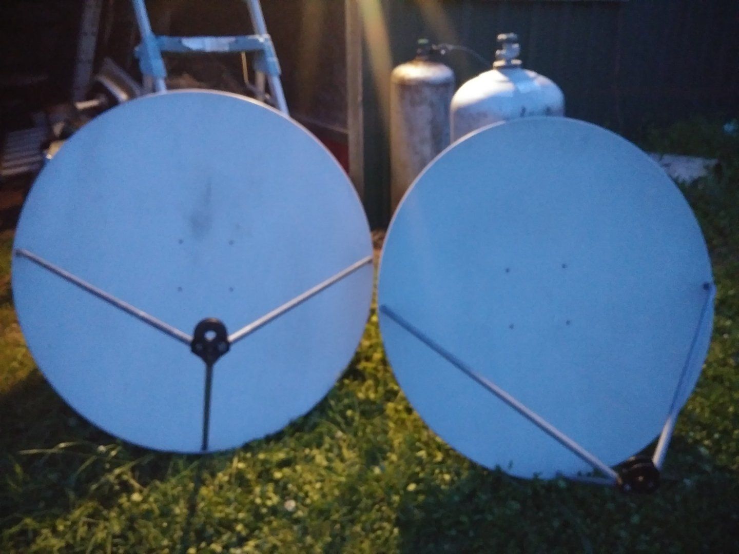

Here's a photo. Picked up a 1.2m and a 1m Channel Master commercial glass for $180 cash.

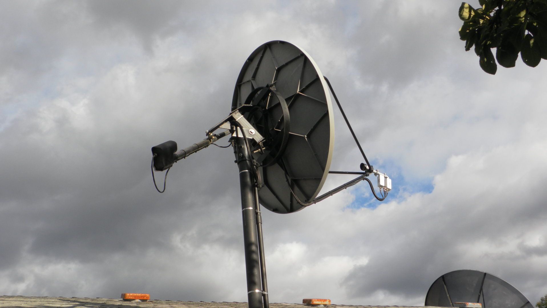

I was able to get the 1m up on the STAB just to try it. It was a nice day so I just played on the roof after lunch LOL. Just slapping the Maverick PLL LNB on it gave me around a 2.5-3dB boost on most signals compared to the 75E CM dish I had been using. I finally can lock the CBS News feeds on 99w!
