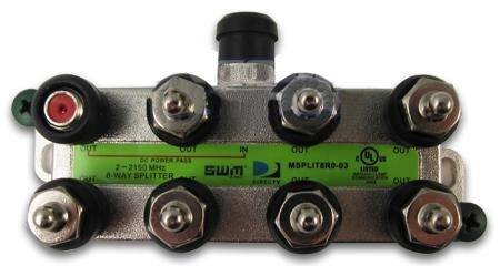

I have the HR34, and 2 H25's
Just added an R22, and it is only using one tuner. do the H25's use slots on that switch? Is that the problem already using 7 before the R22 was added?
Solved........Do want to ask if anyone can help me set up use of my one RF remote with both an HR34 and R22?
Guess its not solved. Is there a way to make two of these work? Like a connection from one to the other or no?
I've understood it as once you get above 8 tuners you need the SWM16 which requires 4 lines form the LNB (the single output SWM would be switched to the older 4 output style and those 4 lines go to the SWM16.)
Hopefully someone can chime in and (hopefully) say there is an easier way
addition...I know we were talking about splitters in a different thread and someone mentioned the single output SWM has 8 channels in it...anything above 8 requires the older (4 output) and a SWM16 switch
