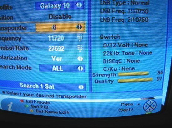

I've finally got the missing parts for my 40" primestar dish and spent a couple of hours setting it up today. Of course, my first target had to be Galaxy 10R. I tried using a signal finder but ended up taking my Coship 5300b outside and use the strength meter on it. The Primestar mount has a fine tuning bolt that makes it easy to make vertical adjustments. Well, you know the Coship does not have blind search so I had to manually enter the figures.
Well, it was well worth the work and time, because The Tube comes in with signal strength of 84% and the signal quality is 98%. I have my Nexus card hooked up through the pass thru on the back of the Coship and the signal strength shows 33% but quality at 100%.

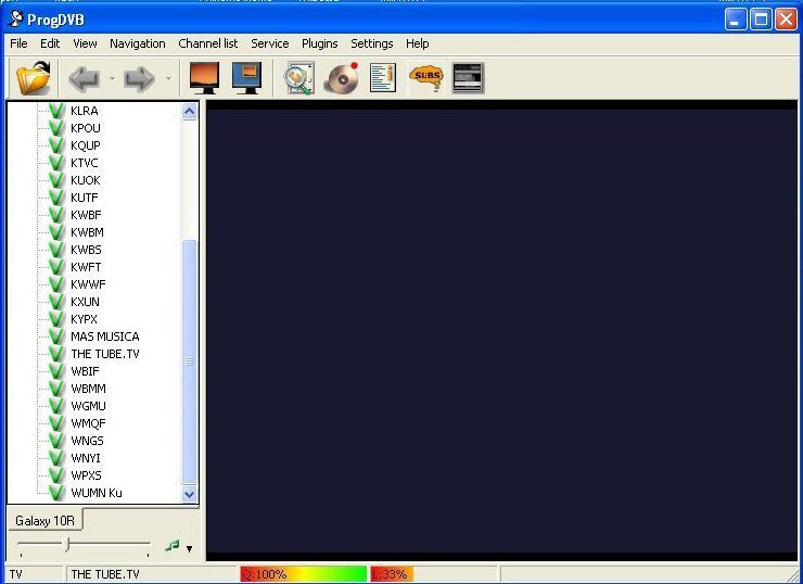

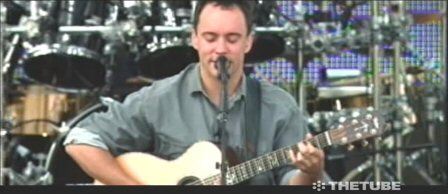

The Nexus uses a different video layer than regular window screen so the picture shows the Nexus window in ProDVB. But this will show you the signal and quality strength I am getting. The Coship is staying at 98% quality on the Tube and the Nexus shows 100% most of the time but sometimes drops to 97%. I am using a PrimeStar 1m dish.
