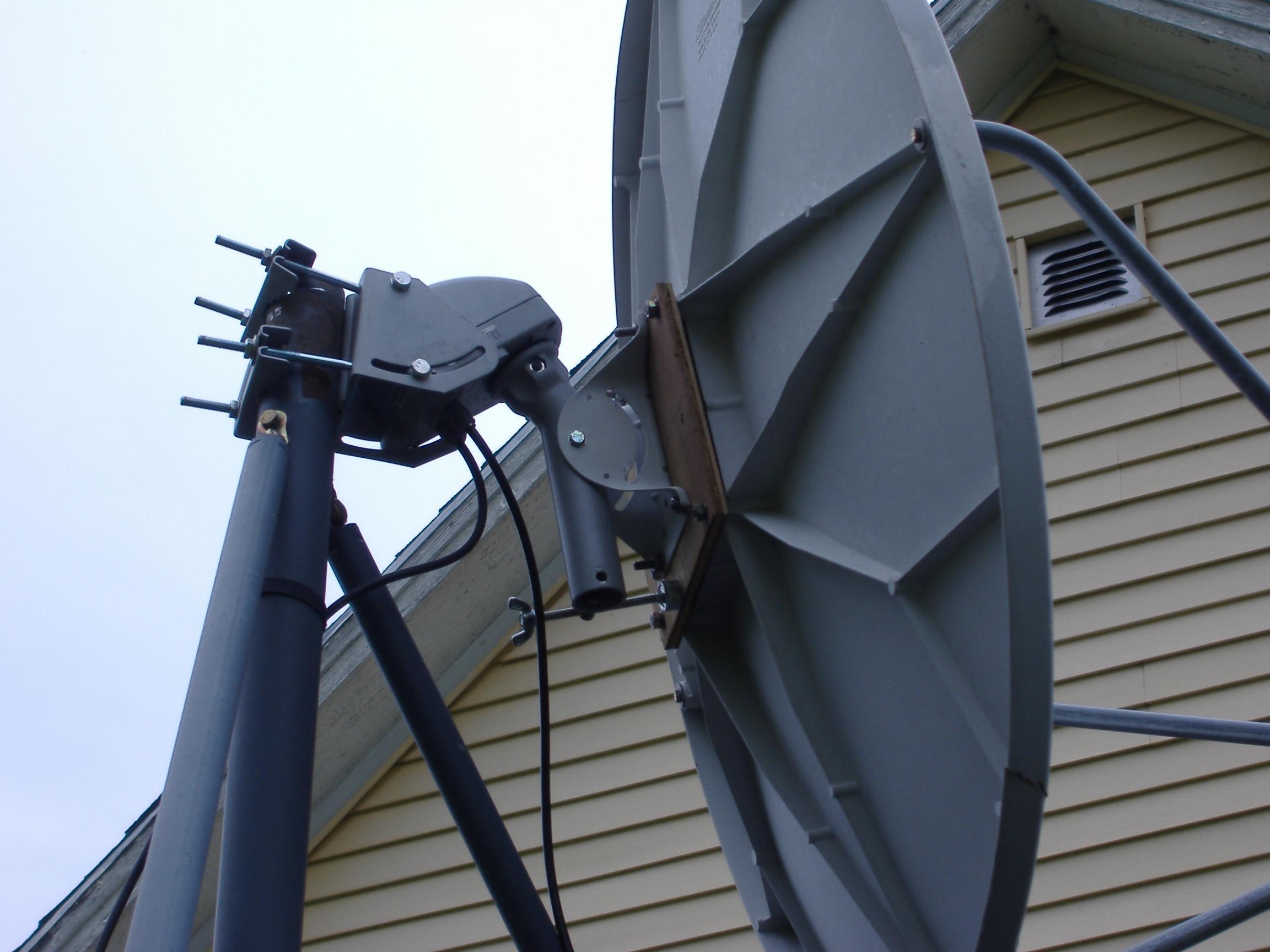

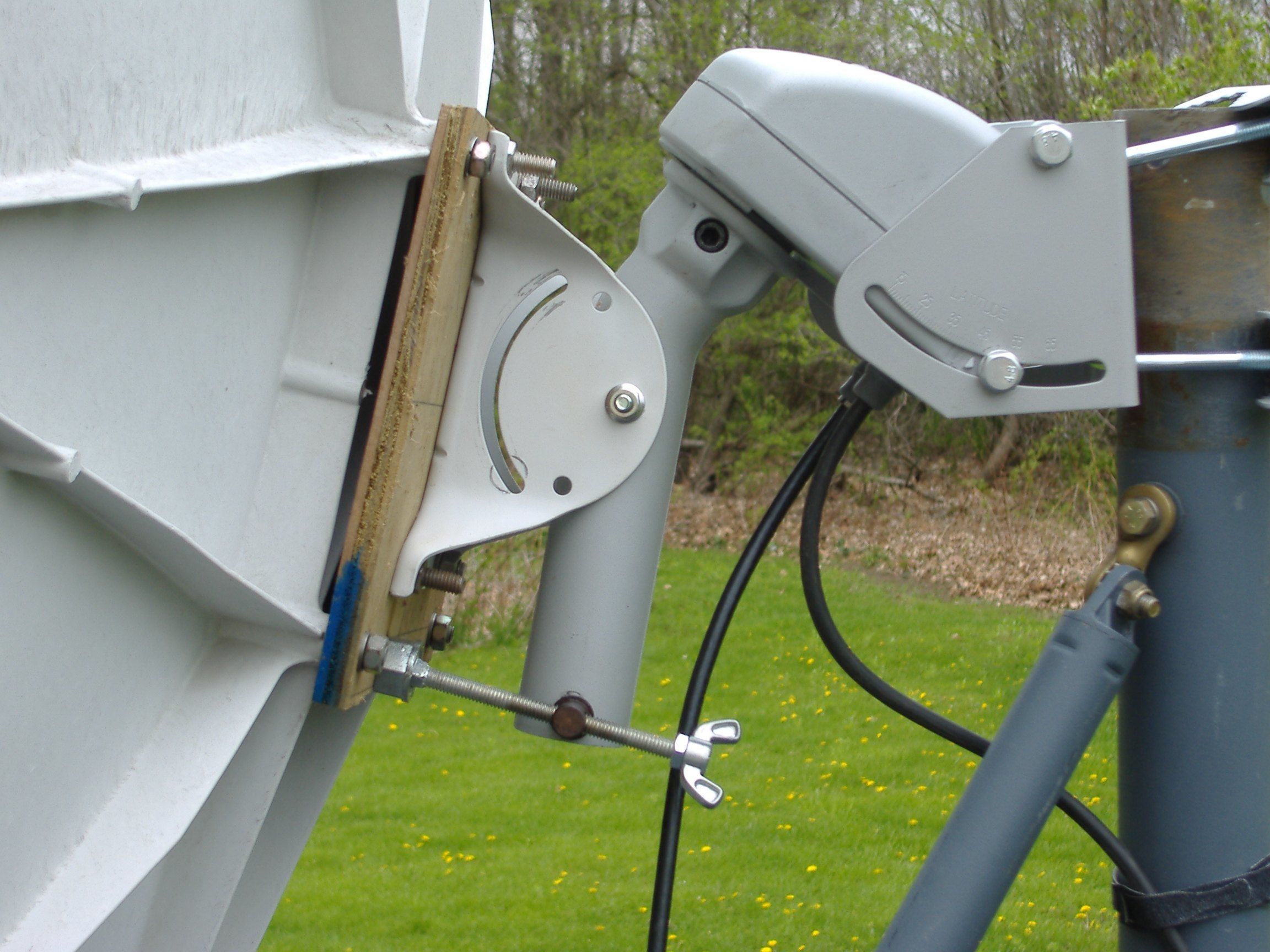

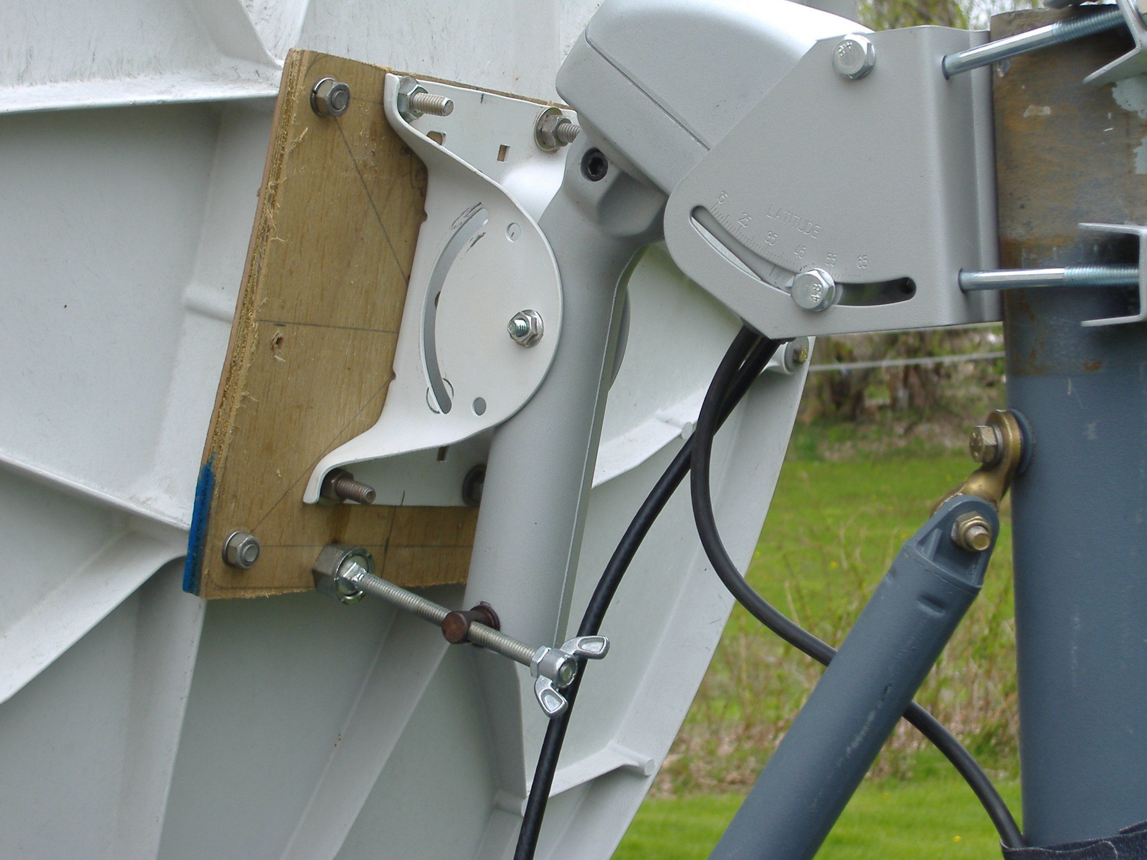

Here are some pics. As you can see I borrowed heavily from others ideas.
