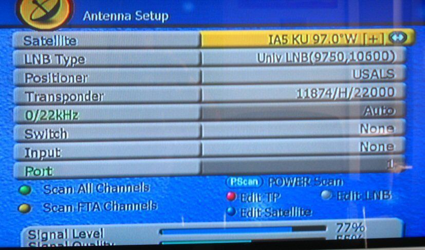

Are you setting the info right for a c-band satellite?? Local osc-5150 for c-band I believe. Any switches involved that might have a bad port?
satellite-pas1R 45
symbol rate- full range
polarity-all
start frequency-3700
end frequency-4200
frequency step-4
mode - scan all
locking speed- detailed

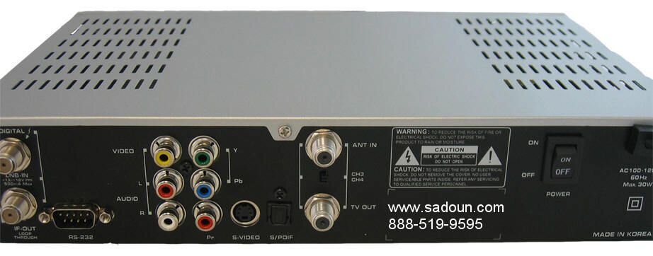

Make sure you have the cable in the back plugged in to Digital LNB IN
Also, LNBF type should be 5150
