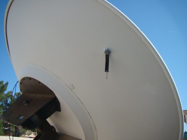

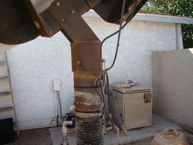

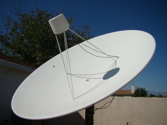

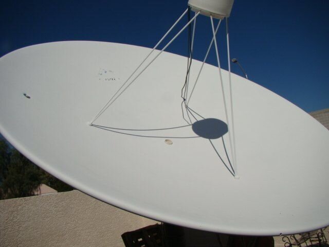

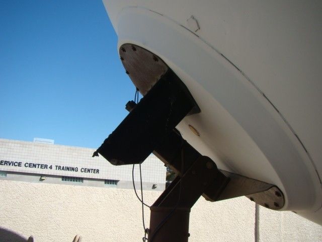

have been reading about them on here the past couple of days.
this seems to be one of the oldest ones 25 + years as told to me by the owner. and not modified/ updated.
sure would like to bring it home but i'm no good at fabbing stuff up like what needs to be done for the motor to work.
anyone here these days doing that ? would galdly pay for the spent time.
guy said a few people have looked at it over the years and now thinking about scrapping it out. that would be sad.
thanks for reading

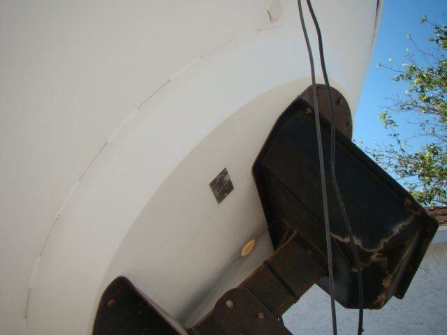

unless the motor is bad it should work with a vbox pushing it

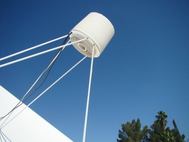

now a new wheel for the sensor might be needed and some work on the scaler might need to be done
lots of threads here on bv recovery and rebuilding
get as much of the pole as you can
the lil poles that hold the scaler are aluminum so be careful if you try to remove the scaler its breaks easy ( the threaded ends ) a lubricant and a wire brush on the threads first ... if needed .
also the bolts that hold the dish to the motor bracket these are threaded into the dish area and often strip free and have to be cut off , try using extra care and something like pb blaster on all bolts ( on dish too) let even sit for a day or two if possible

the drilling out the scaler varies on what lnbf you want to use. for most that are about the size of the standard chaperal feed i think several members used a drill , a door hole cutter and sandpaper or something like that .... the info is here on the forums plus here's a thread on wheels

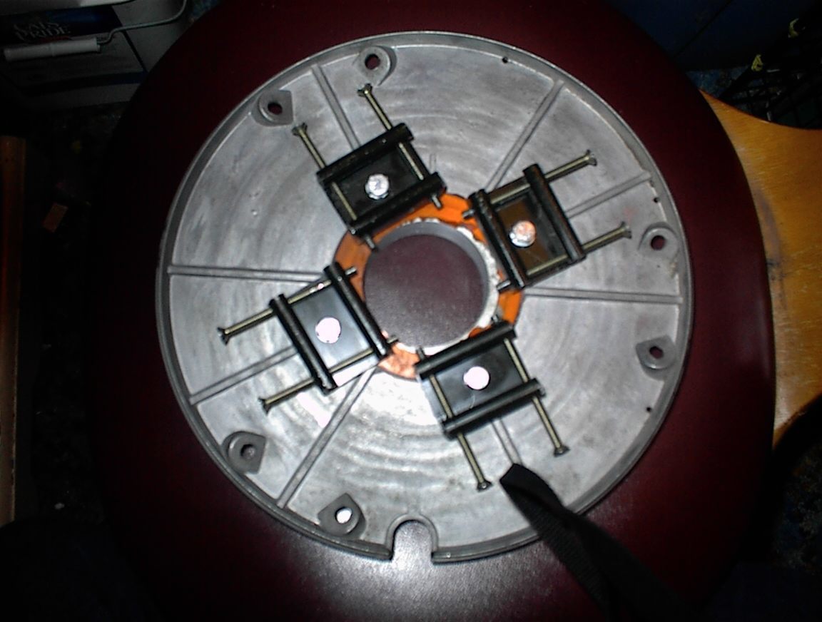

IMO you guys are getting ahead of yourselves. MadMad, do you KNOW the dish doesn't work? The LNB will need to be changed, but a regular dish mover will move it, it just wont count. So you will have to see the dish so you know where its moving when you push the button. You MAY not have to rework the scalar, those of us that are anal about such things reworked ours because it gets that last bit of signal. It will work for cband as is usually.
Yes, get as much pipe as you can, and look at my thread if you need ideas on adapting it.
And by all means, if you decide you dont want it, at least pass on where it is so someone else might have a shot at it! LOL
I got a machinist to chuck the scalar in a lathe and open up the center hole a few thousandths for a standard C band lnb, I ended up changing the unistrut clamps in the photo for simple "L" brackets and set screws.

I have never seen anyone drive one of these with an old Birdview receiver, but if the owner still has it, you might be able to avoid the reed switch/magnet wheel mod
I picked up a Birdview last year and it's one of my prized dishes. For Ku it's hard to beat, although that is with a virtually custom dual orthomode feed. For C it's a good performer, but nothing special for its size. My 10' dishes easily outperform it.
One caution for the older, original Birdviews is they use a potentiometer to feed back their position to the controller. This is incompatible with all current movers. There was an official conversion kit available from Birdview and I've heard they can still be found. However I decided to use a rotary encoder for my dish. I published the details here, but it requires some ingenuity and a simple circuit to adapt the encoder outputs to dish controllers.
