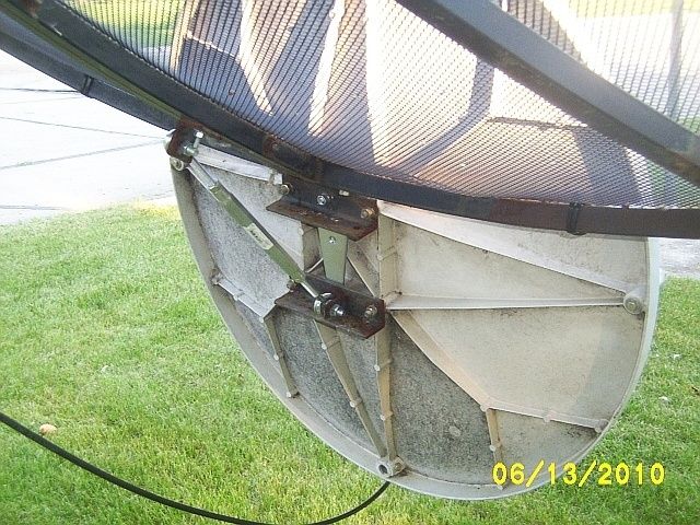

I'd go single band, then later if desired, try a dual band. Being what they are, they are finniky to adjust and are a compromise. BTW my C2 LNBF is doing a bang up job. Here's what I did for motorized Ku, and it's rockin', a 10'+30" dish- - (I should add, it's a 100% steel dish.)
