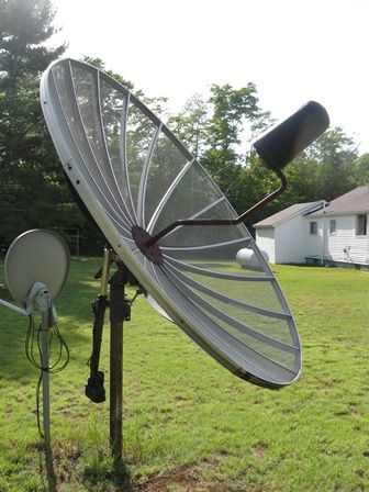

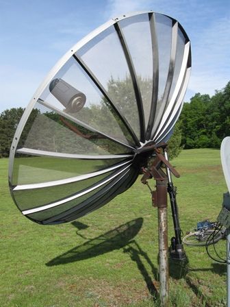

So I found this dish nearby, seems to be in fair shape. The owner says it is 20 years old and was there and working when he moved in.
I'm interested in reviving it. I would be willing to invest but I know little about this stuff (I currently have a 39" Ku I got last fall). I am wondering if any one would know whether it's possible by looking at these photos. What I mean is would the modern equipment hook up to this and work?
Thanks.

You need a vbox or an old analog receiver to control the motor. Your receiver will
work fine
One of those dishes is pointing the wrong way! :)
If the (big) dish has a separate feedhorn/LNB setup an ASC1 might be a good option to control the positioning & skew. You will need to remove the feed horn cover to show what's inside. If you go with a c-band LNBF, a v-box would be ok too. Dish looks nice, if it is not bent or anything that would affect the parabola it will work just fine. Lots of fun setting up etc, it's all good!
I CAN'T TELL WHO MADE IT so it's got to be poorly made one, or it would have sold a lot
It looks in good shape. With a V-Box or ASC1 and a C-Band LNBF, you'd probably be good to go. A V-Box and C-Band LNBF would cost under $100. What size is it?
My dish looked like that, while aimed at a Russian satellite. (a long time ago)
A Vbox and a Titanium PLL LNBF gets my vote. (just for simplicity)
An ASC 1 would be my second choice. To use the existing LNB/feedhorn assembly.
looks like an 8ft, and also looks like the actuator is mounted incorrectly. Should be mounted to the arm 'out the back' of the mount, not to the pole itself. (you'll get more of the arc)
Give it the 'string test' before 'committing', but looks like it's in good condition.
I was returning from a bike ride when I stopped in to ask about this and snapped the photos. And I was pretty tired when I posted this so maybe it didn't make perfect sense. The surface of the dish (6' or 8'?) looks really good (smooth and no dents) everything else has a coat of rust but not falling apart. It is pointing in the wrong direction because the wind has been blowing it around. (I was also wondering if Canada had a satellite I didn't know about.) It's at an elderly couple's place and apparently hasn't been used for many years. They still have all the electronic equipment, and the man knew the motor wasn't installed right. He said they quit using it when signals started getting scrambled.
I was a bit confused about the large LNB enclosure and was wondering if perhaps the design of these devices had changed since this was built (the man said 20 years since they moved in and it was already there). I guess that was the main thing I wanted to know. It sounds like I can get it to work with some investment.
I was thinking of offering the guy $40. for the whole thing (dish, electronics, pole). It's probably worth taking a chance on. Heck, the post is steel and probably worth $10.

I'd outfit it with the Titanium PLL LNBF. Let them know that the electronics in the house are basically worthless. Although, you could move the dish with it. The actuator? who knows until you put power to it.
Going to have to take it apart. Clean up the mount and check/replace the bearings/bushings, and maybe even paint it.
Not to mention, you'll probably have some nuts and bolts to replace. All in all, it might take a couple of months before you're ready to tune it up on the satellites.
Oh, those big LNB/Feed covers, they made 'em extra large BITD so bees had a place to hang out.
