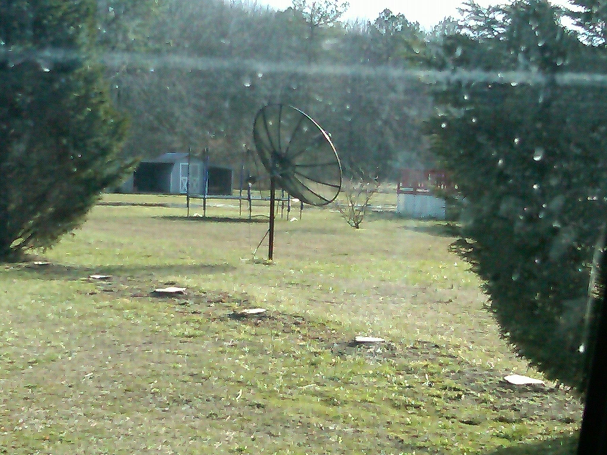

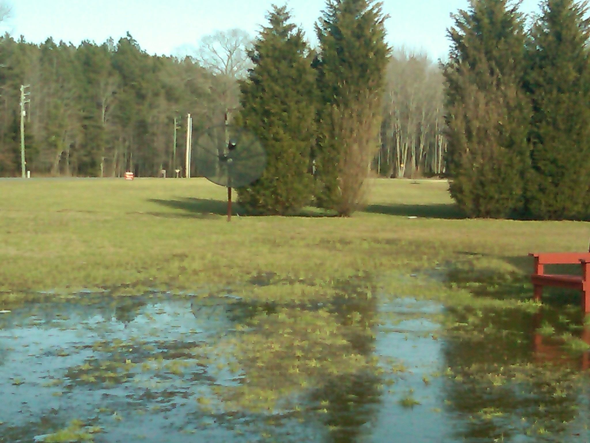

I'm new at this big dish stuff and have been asking alot of questions about the one in my yard. So today I'm driving home and I'm noticing all these houses with buds in the yard and pizza dishes on the roof. I start taking pics and knocking on doors with no success. The last house I stop at has this BUD in the yard and the guy says I can have it but leave the pole. It looks like the size of mine, 8' or 7' with an actuator arm. He says he has a reciever that he bought 3 years ago for $700 and stopped using the BUD 3 months later. He's got the box it came in and the remote. I was too excited and didn't ask what brand it was but he wants $100 for that.
My question now is, is this dish good for a noob?
Can you tell by looking if it's c band or Ku?
What should I look for with the reciever? Brand? Model #?

It looks good to me, especially if it's free.
No way of telling from that pic if it is C/Ku.
That may be a 4DTV receiver, if it's a 3 year old 922 it's definitely worth $100, I think good ones commonly sell in the $200-$300 range. You could use it for subscription C-band (4DTV) reception if you wanted. If it's just an analog receiver it's not worth that.
$700 receiver sounds like maybe it's a Motorola DSR 922. If so that would be quite a bargain. I'd go for it.

Get the dish regardless. Pole and (ribbon) cable are replaceable. Take care not to "tramatize" it when taking it down. Bends and warps will cause you grief when you do the reinstall/realign. Damaged mesh will affect the reception performance.
Dont dissasemmble any further than is necessary to transport. It is a good idea to take several pics if the mounting assy/adjustment settings from different angles. Also be prepaired to re-invest in some replacement 1/4"-20 hardware, SS if your budget allows. Removing the LNB mount arms, LNB and scaler as an assy would be wise as these can be warped out of alignment with little effort. I find using two pair of Vice-Grips (or equiv) ideal for snapping frozen 1/4-20 hardware if necessary.
DO NOT disturb the adjustments for inclination and declination. IF tweaking those adjustments is necessary, that can be done on the reinstall much easier set as they are, rather than doing it from scratch.

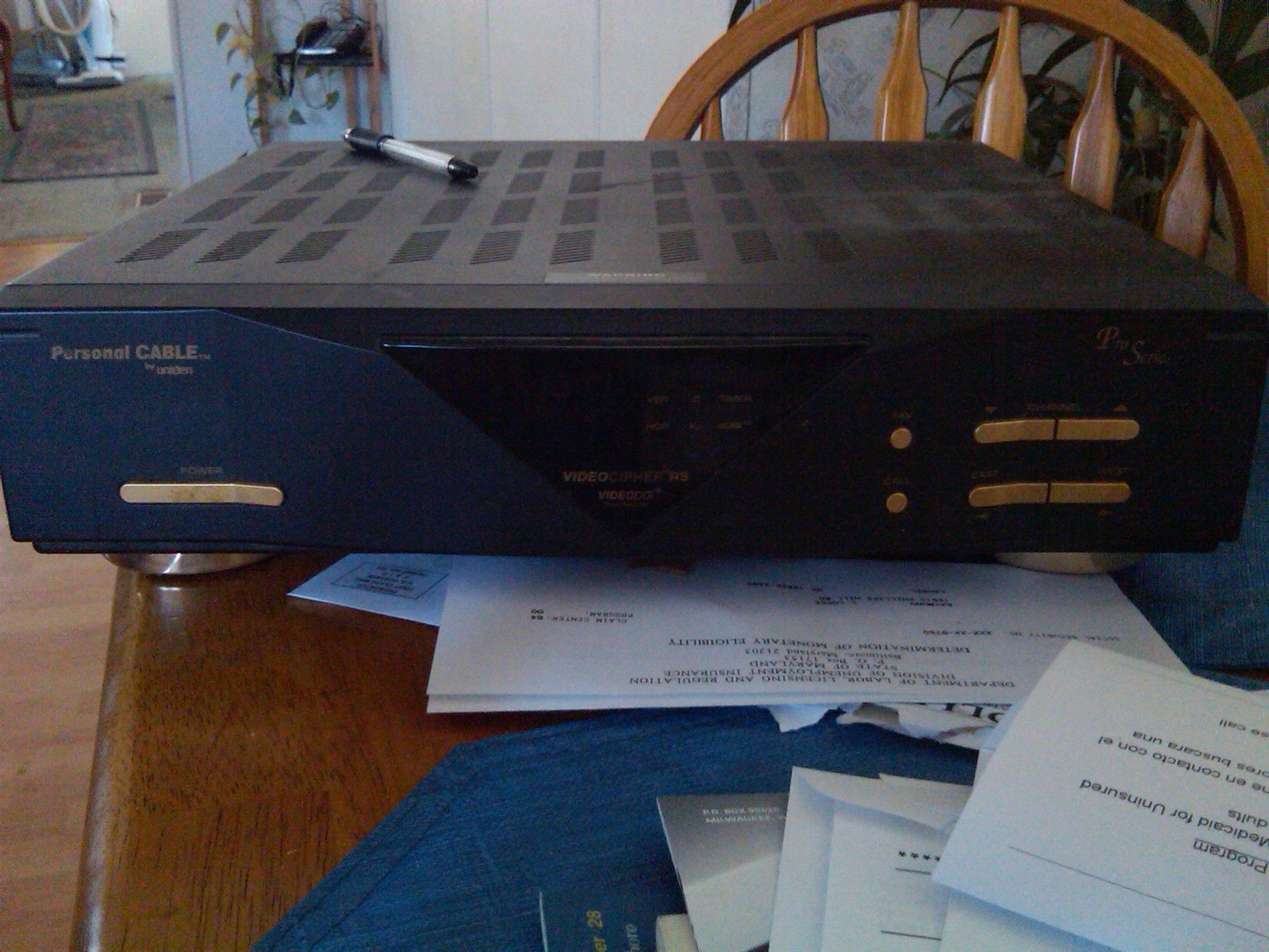

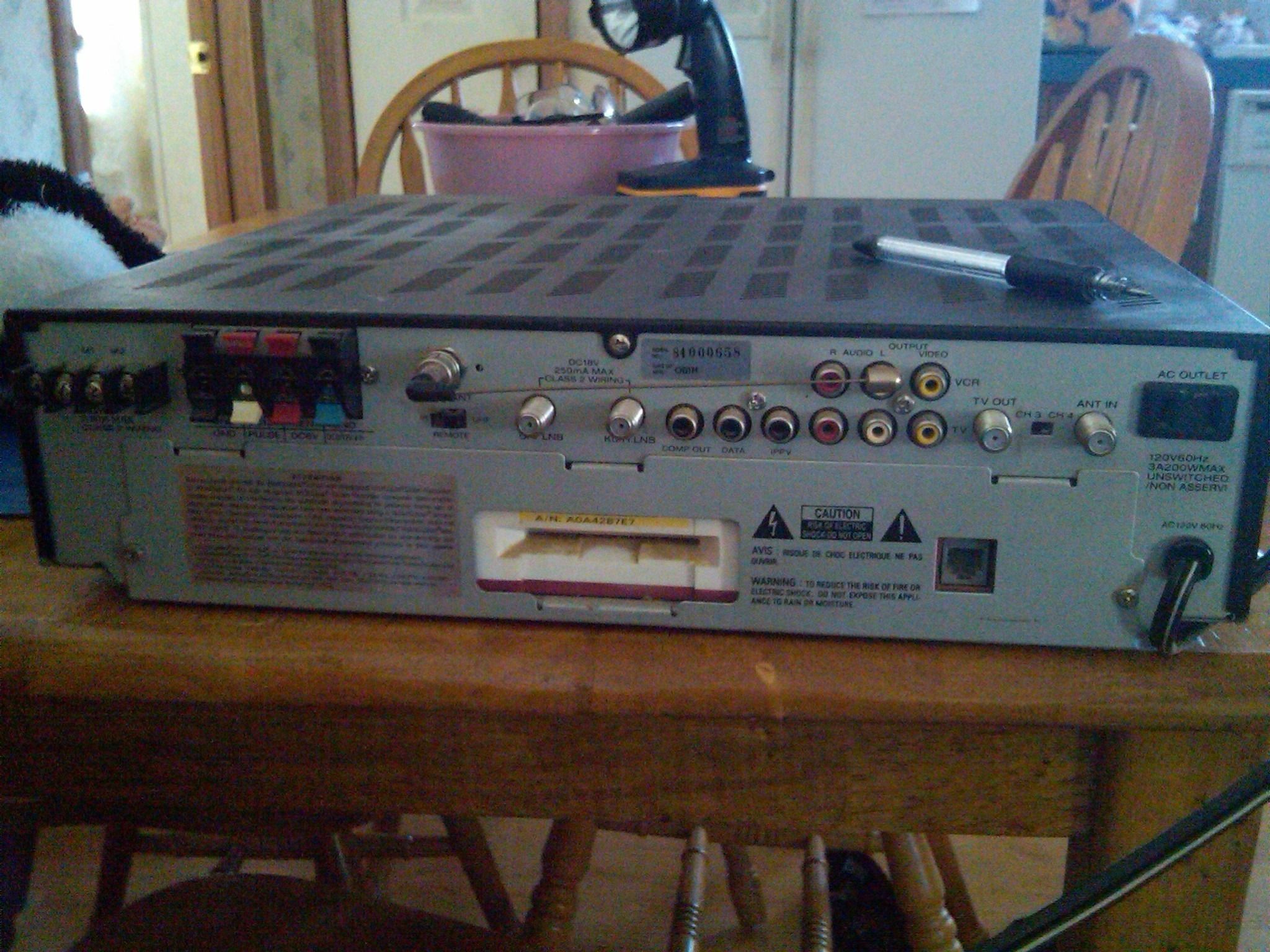

UPDATE
The guy let me take the box home so I can check with you guys about it.
It's a Uniden Personal Cable Pro Series. Model PC4000
Is this still worth $100?
He said if not I could bring it back and just take the dish.

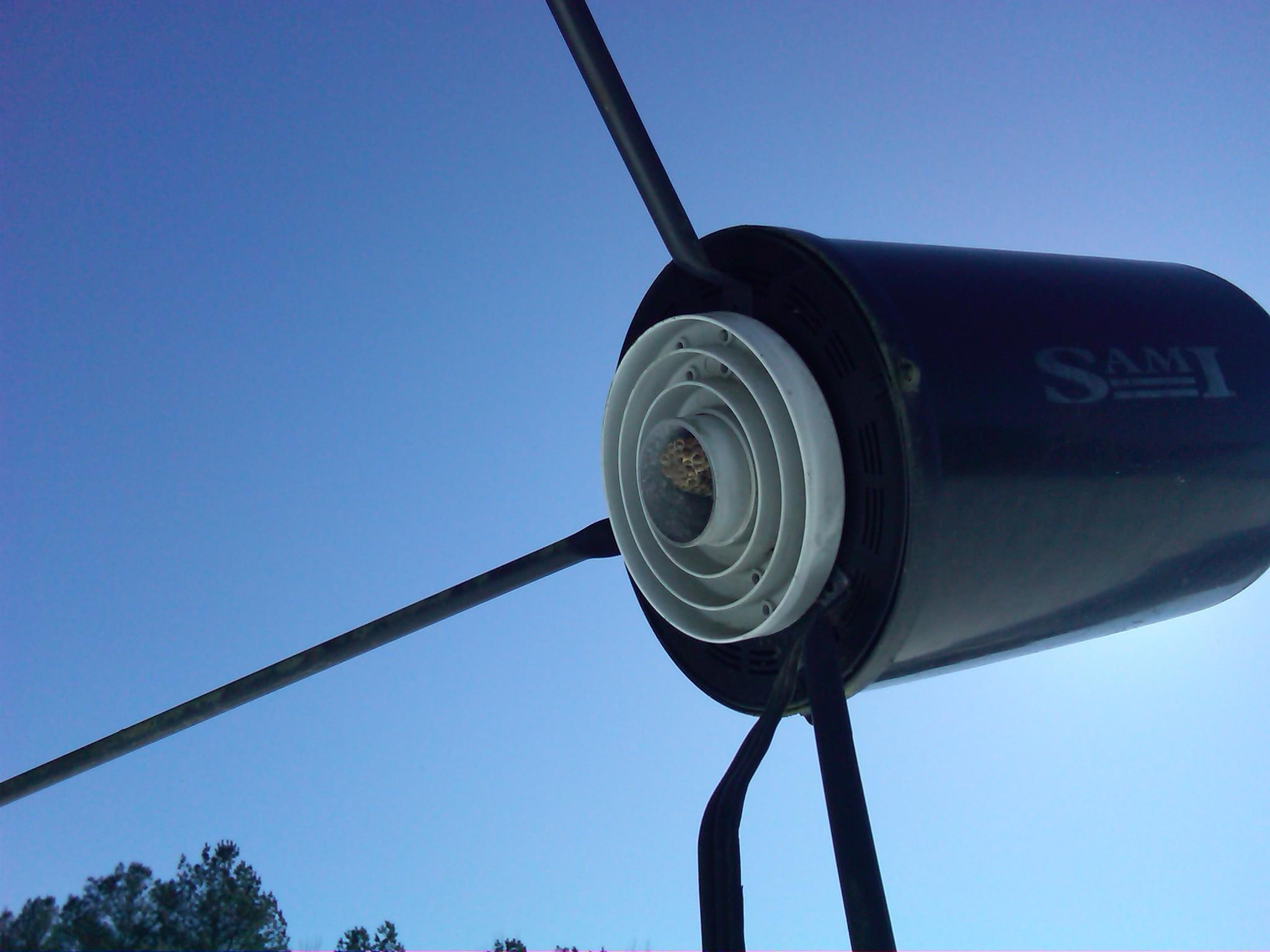

The dish is 8' and the cover says Sam1 on it.
