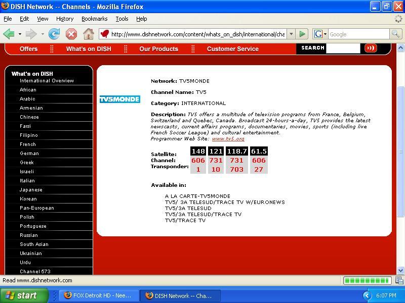

well lets see.....This morning I mentioned
Dish is in the process of moving all the international channels to 118 and TV5 is already there.
I guess I need more proof, huh? :D
see below
Iceberg you were right. TV5 moved to 118 on 731 and I got a local tech to reposition my 100+ to pickup 129 for the HD including FSN HD Detroit.
He disabled 61.5 from the old dish since I can only have 4 orbitals received. I'm not sure what to do with the old dish other than remove it.
Thanks for all your help!
