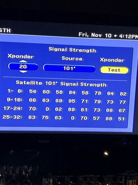

Does anyone know what transponder Fox Sports Detroit is on?
Got a customer in a 40 story building we just upgraded his dish from an 18 inch to 30 inch.
Transponder 1 was in the low 40's with the 18 inch dish. Some improvement with the larger dish.
The signal levels still suck
66% ain't bad. It was 43 before I installed the 30 inch dish
What kind of a receiver is that anyway?
Don't recognize that UI?
As the levels from 101W should all be well in the 90s - 100, except for the spotbeam tps. on 4, 12, 18, 20, 26, and 28, which could be anywhere from 0 -100 of course.
I thought that too ...
Just figured that the Business model (MDU ?) may be different.
Not sure why it would be, but was just thinking.
