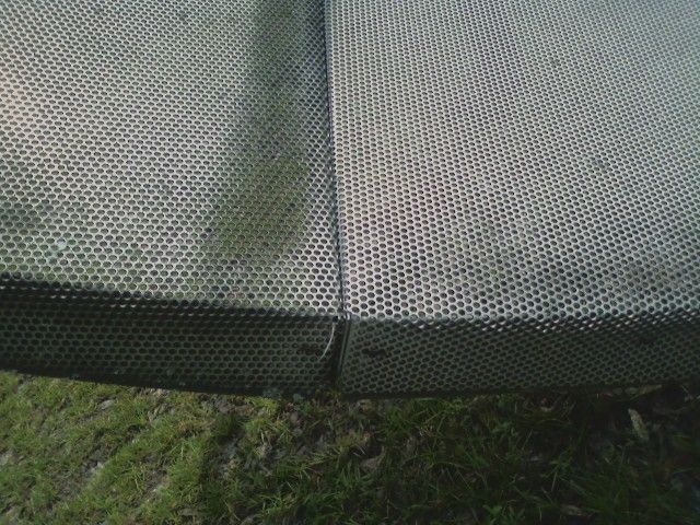

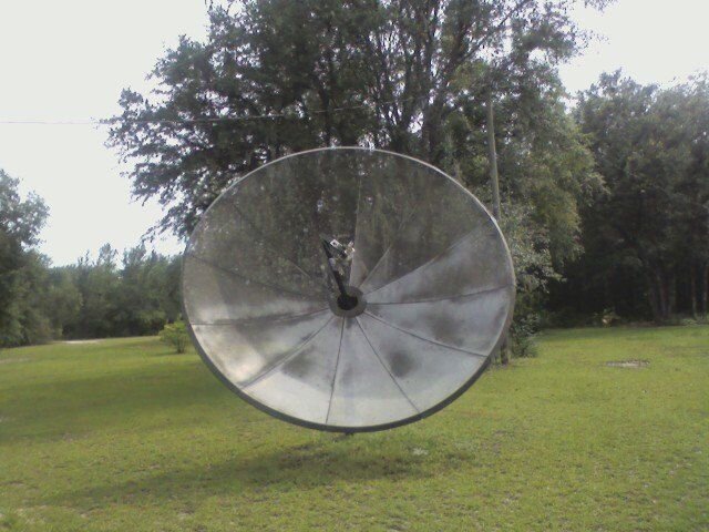

Found this bud free for the taking. Does anyone know who made it, what is the best way to take it down, and how will it do with ku using a c/ku lnb? Thanks It is a 12 ft dish

I just got a free 7ft dish on saturday. The easiest way to take it down is first loosen the bolts holding the mount on the pole. once its free you will need another person to lift up and off the pole. After that dig around the pole until you see concrete, get a rope, chain etc. and hook it to your truck. move about 4 ft and wallah its up and out. :D as far as using a combo lnb, i too am interested in that question.

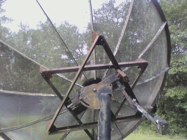

I'd do a string test on the dish before taking time to remove it because from the picture it look's like it may be bend at the lower part, one of the brackets holding the dish has an issue.
