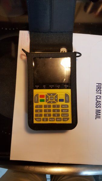

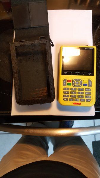

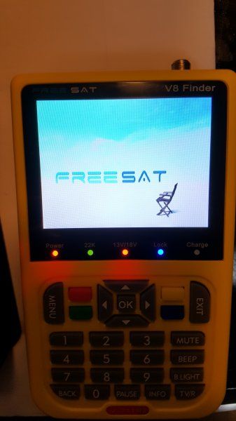

Got this in almost a week ago and had about 45 mins to dick around with it.

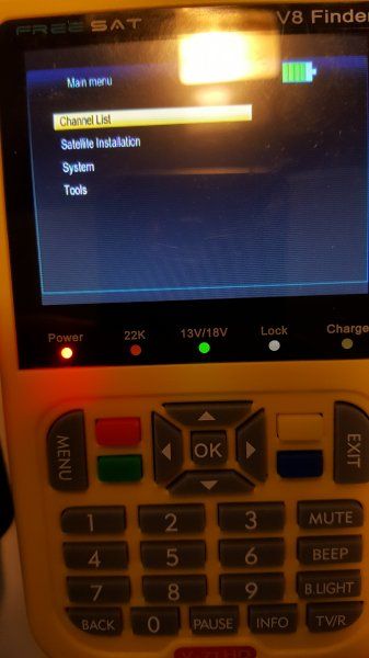

It runs about like a v7/v8 box. Has a tv on it so you can watch, you can enter transponders, edit the satellite list ect.
I was hoping it would have DB option so I can try to hit stuff that is outside my foot print.
But a 65 dollar meter is not going to run like a spectrum analyzer.
Few pics. When I get time ill make a video of how it works.

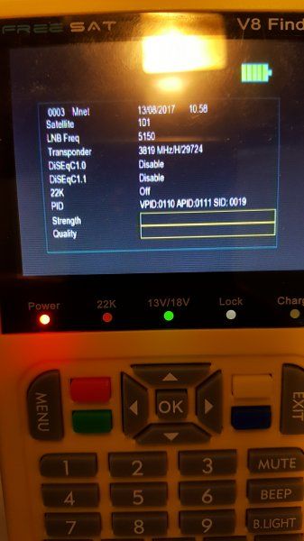

No it is very basic. No SNR. It is like setting up any TV outside with a STB to tune a dish.
BIG PLUS is that it is very easy to program in transponders. Blind scan works good. Like most other STB.
Will not display any forum of encrypted channels.
It is pretty much and STB with out puts and a battery that you could use on a camping trip.

Bottom line no meter at 65 dollars can beat this. But it is a shame to call it a meter when it is a V8 compressed with a cheap LED and battery.

It does show the quality but as we all know quality will differ from STB to STB.

I've ordered one but after reading the freesat forum apparently the v8 finder has a hardware fault. It's all above my pay grade but, from what I can gather it has a ripple from the power supply/battery that is close to the 22khz so it blocks all DiSEqC commands and only allows the high band on universal LNBs. So for anything more than a fixed dish with a single LNB in North America very limited use. If I am mistaken let me know
