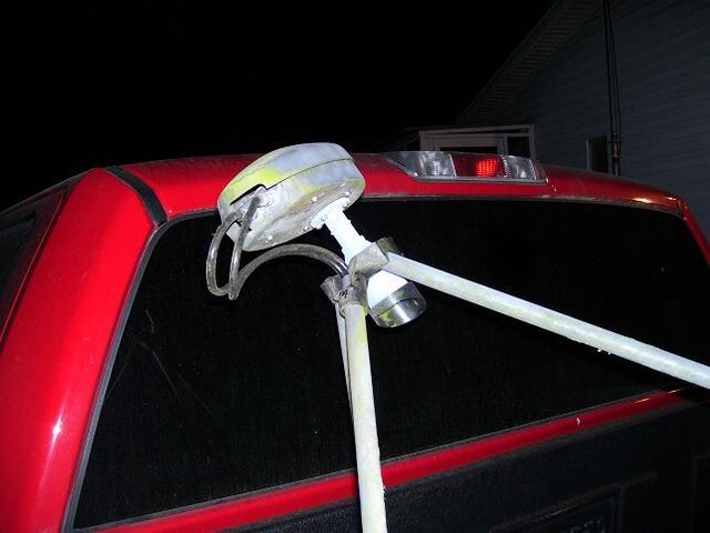

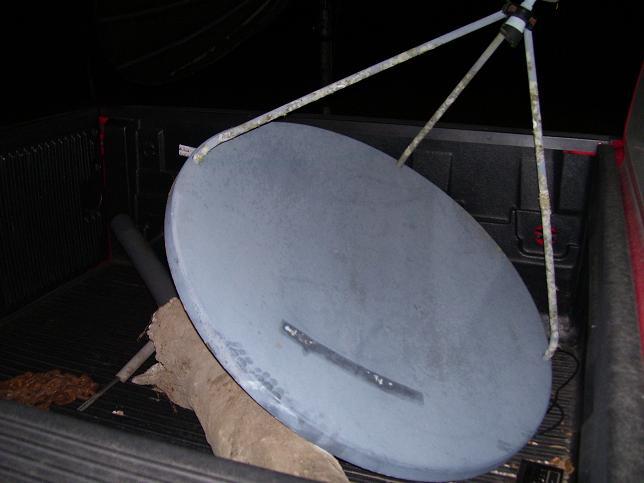

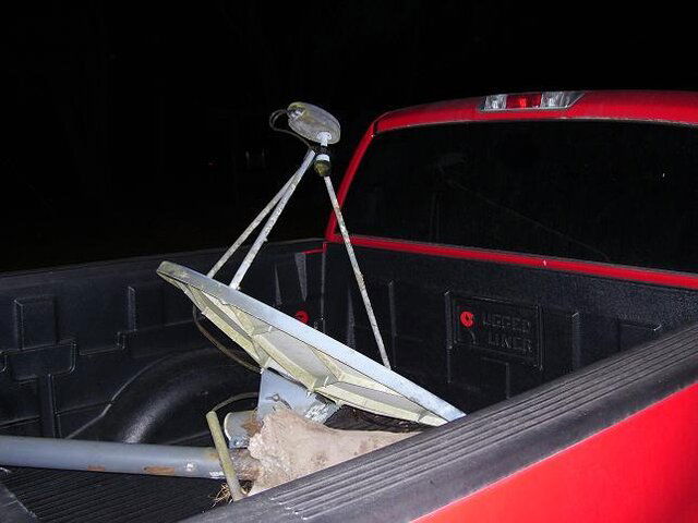

One of our customers (I deliver auto parts) had a CM/Primestar dish in his yard, when I asked him about it he said "Whenever you're ready, come and get it" :D:up

The LNB/feed on this one looks different than my other 3.

A pancake lnb! I never found one of those either (yet). Nice find. Now, did you reach down and yank it up with one grab, or did it take several pulls?//lol
....Now, did you reach down and yank it up with one grab, or did it take several pulls?//lol
Actually he had a tractor, and I just dug around it a little, and he backed up to it, we tied a heavy duty strap around the pole and pulled it right up!
The dish, the pole, the cement, and the Dove-bar LNB!
Good haul , there!
very nice :)
oddball LNB on there though. Looks like a cross between a Primestar LNB (the back part) and a totally different LNB.....it escapes me (the name) but Tron has one of them oddball flanged ones. The LNB normally is single polarity

The round Primestar dishes all had the feedhorn shown in Eurosports picture.

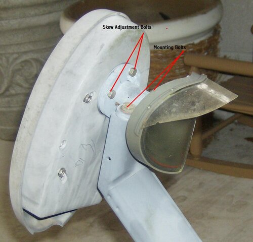

The elliptical Primestar dishes all had the feedhorn shown below.
Now that you mention it, I don't think I've seen a Dove Bar on a round feed either.
This picture was posted to the forum two years ago this month.
Or at least that is when I archived a copy.
Someone was even kind enough to mark up this one:
Another 1M Channel Master with a dove bar LNB! I'd never seen the dove bar LNB on a 1M CM dish either, until I snagged that dish earlier this month. It looks different from the assembly of a dove bar on an elliptical Channel Master because the feedhorn of the 1M is differently shaped. It still terminates with a C-120 flange, so the LNB bolts on perfectly.
In a single polarity configuration, there is a short waveguide between the C-120 feedhorn and the single polarity LNB... One side of the waveguide is C-120, the other side is WR-75. But with a dual polarity LNB (either the dove bar or the stacked Eagle Aspen that Dish uses for FSS on a Superdish), you just remove the waveguide and bolt the LNB to the feedhorn directly.

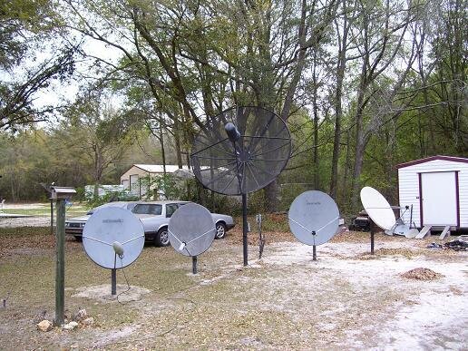

And here's a shot of my 7.5 flanked by 4 Primestars!
sweet! that's the same LNBF on my primestar.
