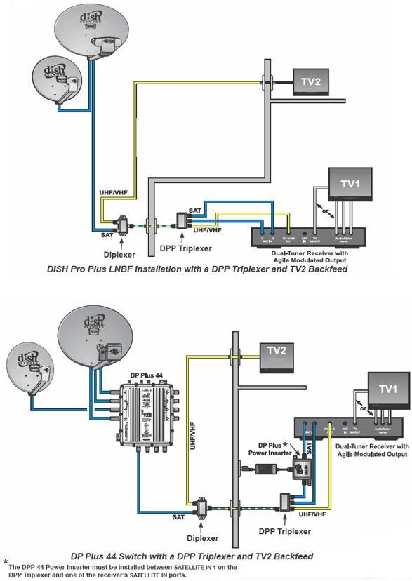

I have a 1000+ with a DPP44. The installer put the DPP44 outside and he screwed it onto the bricks of my house. I have 4 wires coming from the dish to the 44 and 2 other wires going from the 44 to my receiver.
Do u just have that dish or a Wing dish too like I will have also I don't have a place to plug n e thing in if it needs to be powered like I thought it was.
This diagram should help you out. Note that it does include a triplexer, which you don't need but the diagram should still at least give you an idea of how your setup should be connected.

Top pic uses a regular DISH 1000 with a wing dish so you wouldn't need a 44 with that setup. The bottom pic uses a 500+ with a wing dish and the just like the 1000+, the 500+ needs the 44 as well. I'll try to see if I can find another diagram that's more accurate to your situation.
