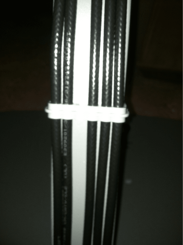

On the 1000+ are the wires from all the lnbs go under the mast and not inside?
Like this

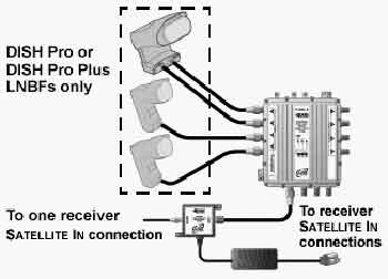

I do thank u for all the help more question do I need 5 cables from the lnbs to the 44 or do I leave the one marked 2D just to peak it only
On the 1000+ there are 5 cable ports plus I have one coming from the 77 sat what ones go into the 44
There should 4 cables coming from the lnbs of the 1000+. Those should be hooked onto the left side of the 44. I assume the 5th cable is the one that connects to the 44's power supply. Connect that to one of the 44's bottom ports.
How do I get that one to my receivers right now with my 1000.2 and 77
I only have two cables coming into the house
I'm looking at the sketch from post#2 and I think this is where the DP21 comes into play. I think you need to connect the 5th cable on the bottom of the 44 to one end of the 21 and connect the 77 cable onto the other end of the 21. Finally you would connect one cable from the bottom of the 21 to the 44 power supply which would connect to your receiver. I think that's how it would work but there's a chance that I could be wrong.

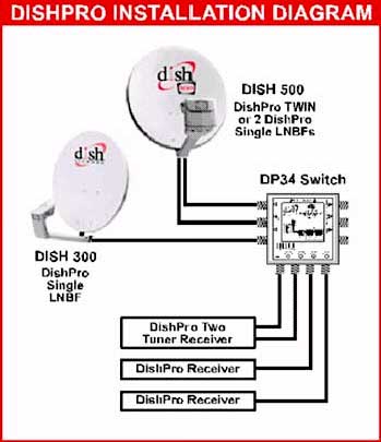

EDIT: I forgot that if you have a dual-tuner receiver, you would need two 21's. On second thought, if your receiver is a dual-tuner, use one DP34 instead. I'll post another pic in a moment.
Okay here's my final idea. That 5th cable that's connected to the bottom of the 44, connect the other end Port #1 on the left side of the DP34. Connect the 77 cable onto port #2 on the left side of the DP34. Finally connect one last cable from Port#1 of the bottom of the DP34 to the 44 power supply and receiver. I don't know if it will work, but if you're willing to try it then go for it.
