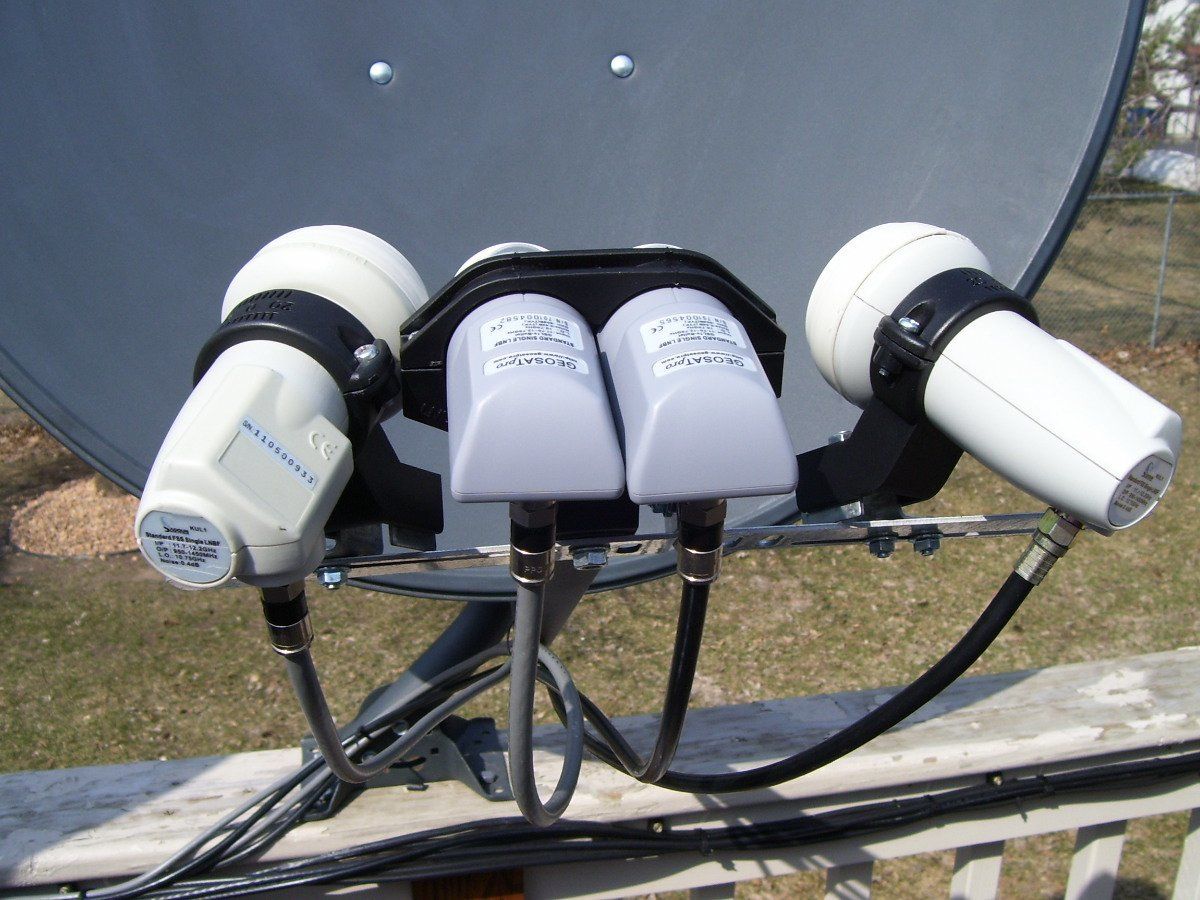

Here's a picture of my bracket setup for 91, 97, and 103. The 97 LNB, in the center, is mounted on the holder that came with the dish. The brackets that were provided with the multi-bracket kit for this purpose would put the LNB holder too high up on this model of dish and not point toward the center of the dish. Instead, one of them is bolted upside-down to the bottom of the LNB arm as an aid to keeping the crossbar straight, although in retrospect I don't think it's doing anything and probably doesn't need to be there. (I had to find another bolt for this configuration by the way; neither the ones that came with the dish nor the ones that came with the brackets were long enough, since the crossbar is meant to be mounted completely differently as you can see in the advertising pictures for these brackets.)
The 103 LNB is mounted to the right on one of the posts provided. The 91 LNB on the left has its holder mounted directly to the fitting meant to hold another post, because if I put it on a post it can't get close enough to the crossbar to be in the proper location. This is all geography-dependent by the way. At another location, and/or centered on a different satellite, the LNBs will be at a different angle to one another, and so it may be possible to mount them all on the posts. Or, it may not be possible to mount on both sides of the center, as I barely was able to find an acceptable location to hit 91. It actually sits a bit further back from the dish than I would like, but if I mount it in front of the crossbar it sits too close to be in the focal point at all.
actually if you are standing in front of the dish, it goes to the RIGHT....when working with multiple sats they go opposite how they are in the sky

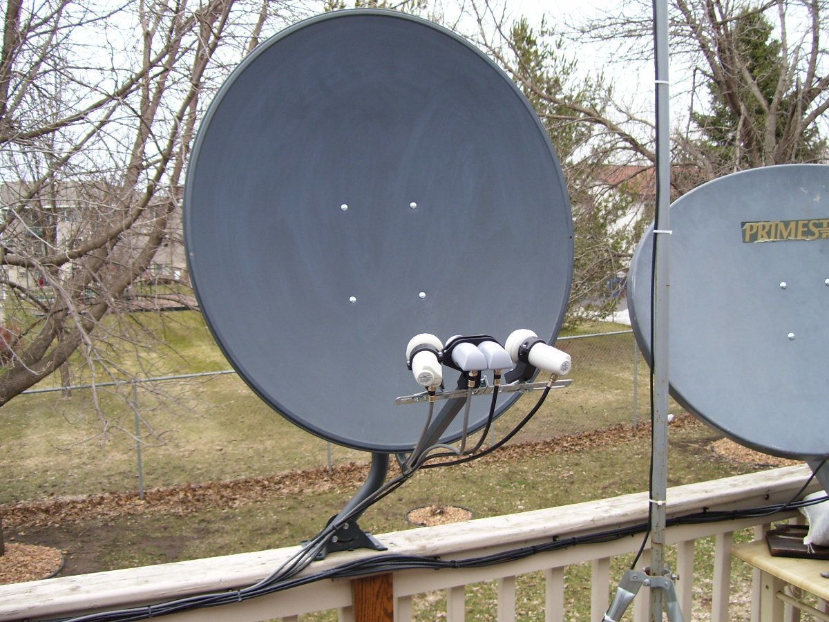

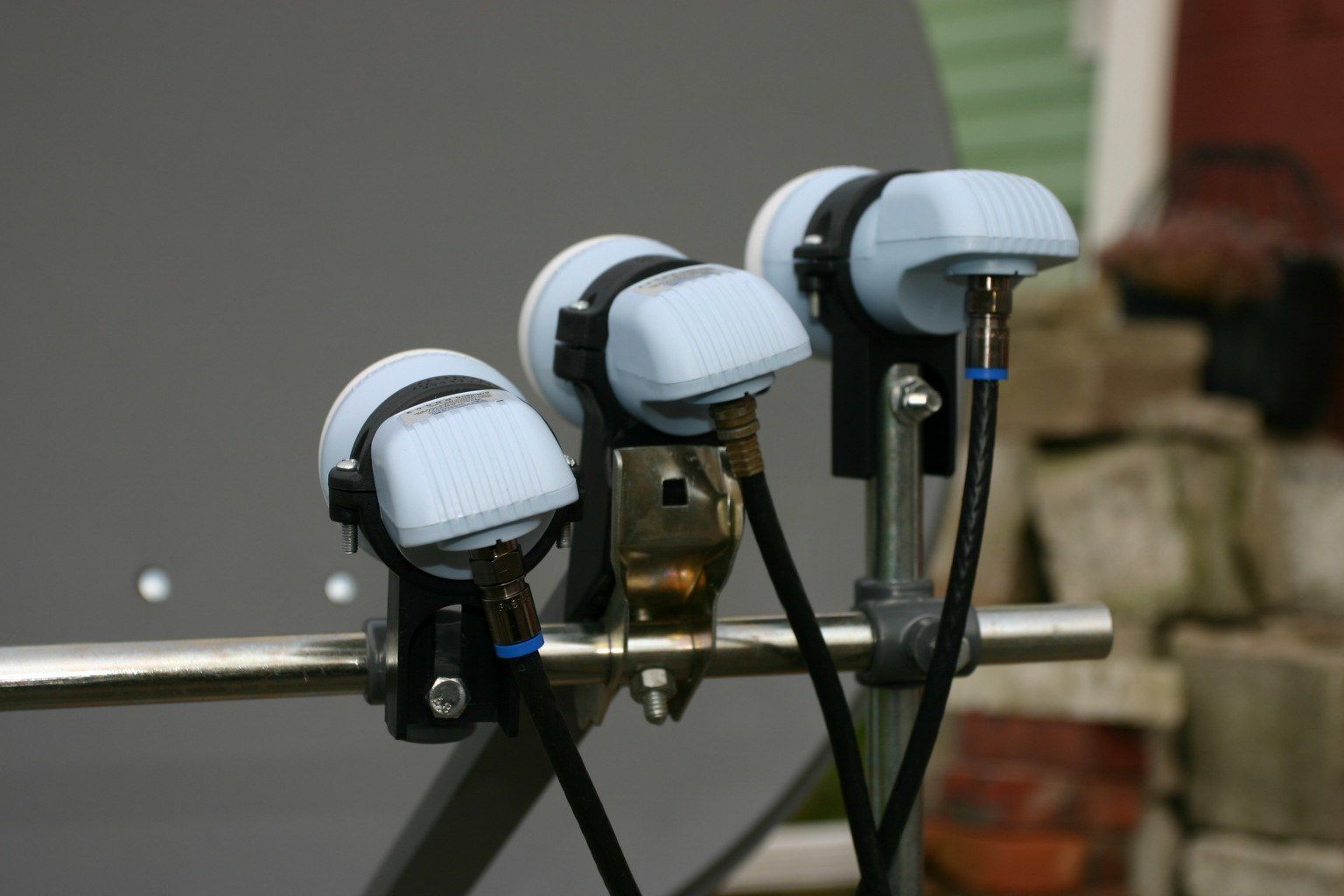

Here is my old 36" dish setup with 89/93/97/103 (from left to right)
Thank you Jim and Iceberg for the photos! I'm gonna try to experiement with each setup and see what I can pull. 103 is my main target and it seems like it must be an easy enough mod to get that bird.
Once again thanks for taking the time to take the photo and upload it!
