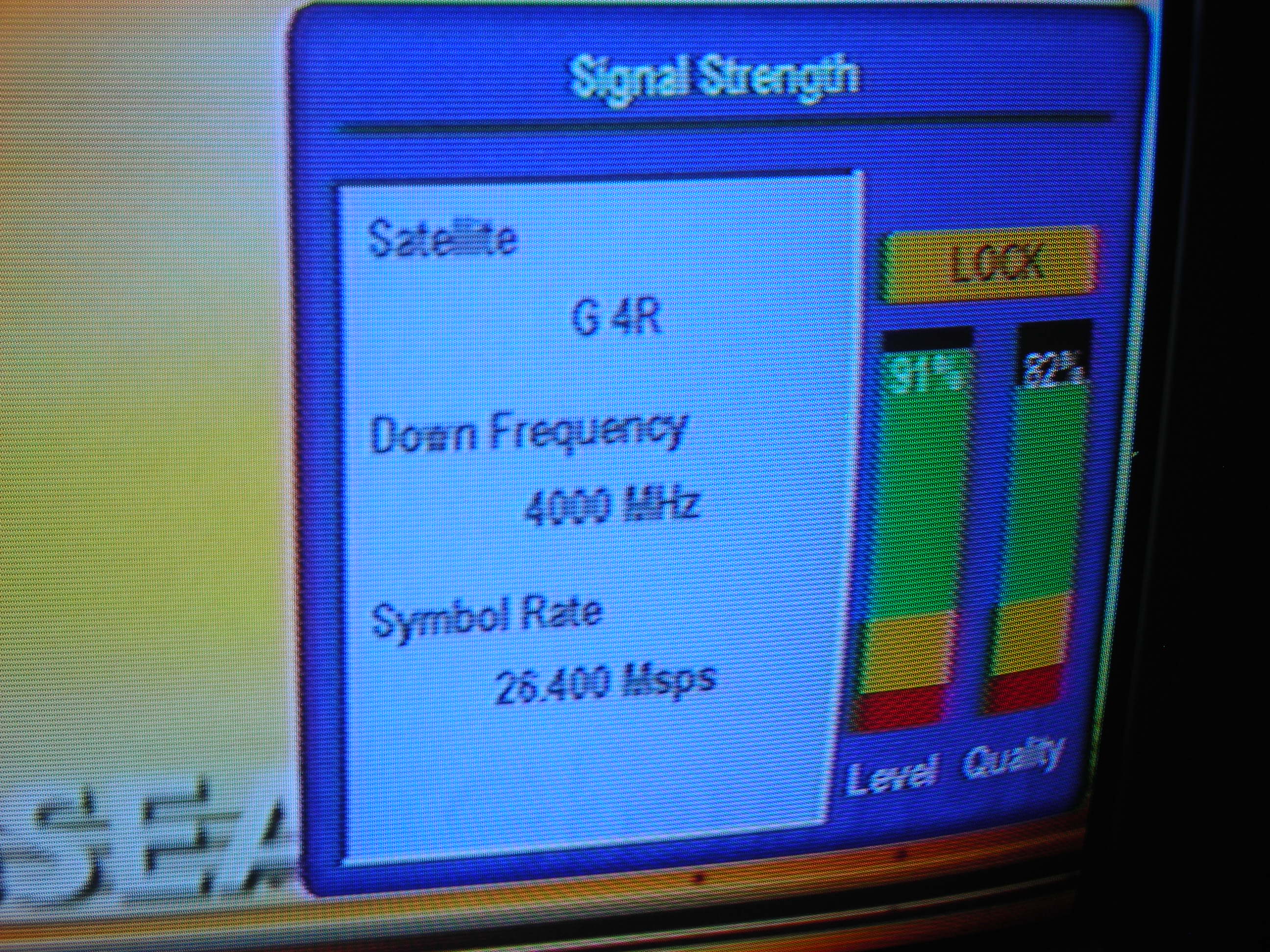

See picture in the next post I left......
See example in my picture.
