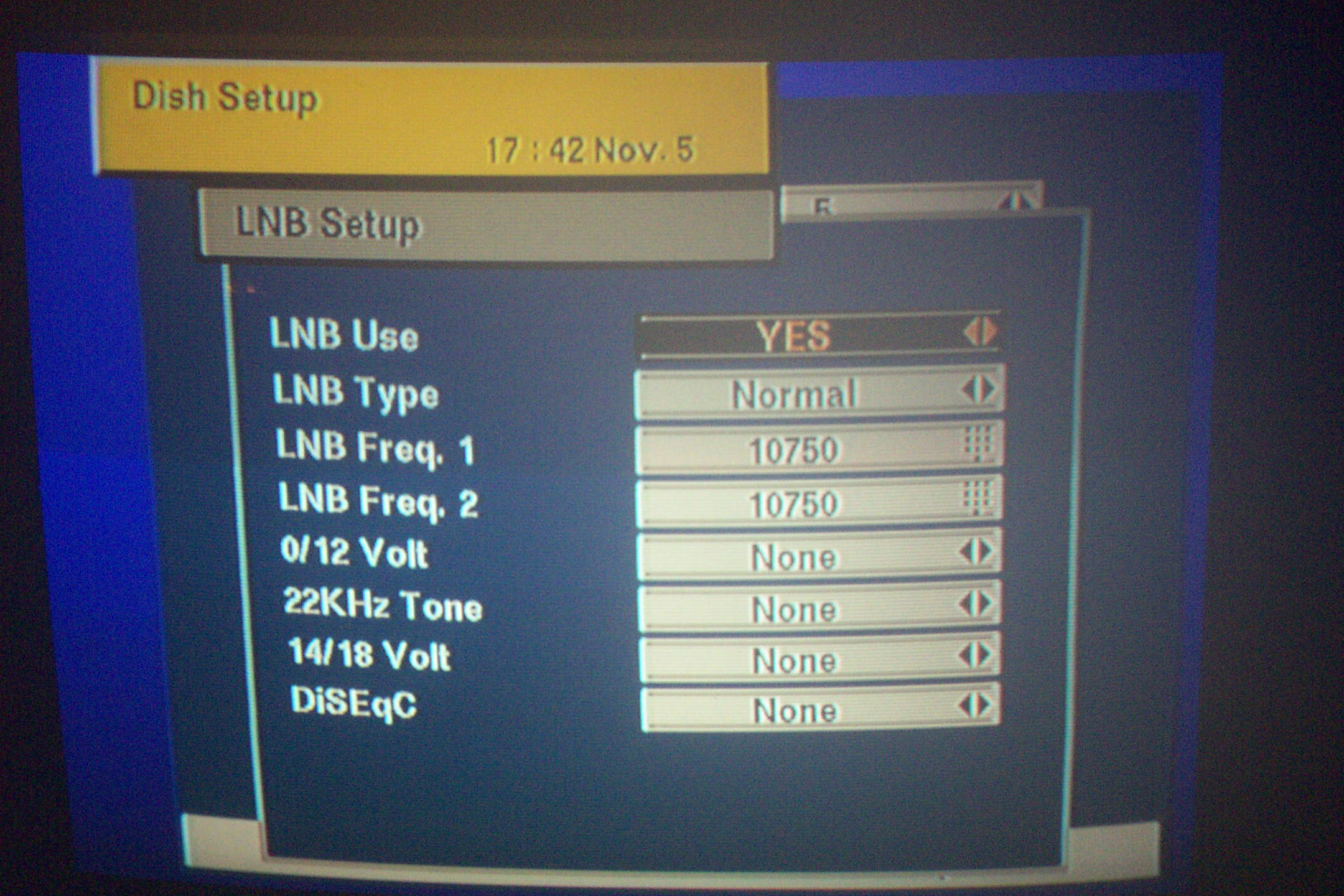

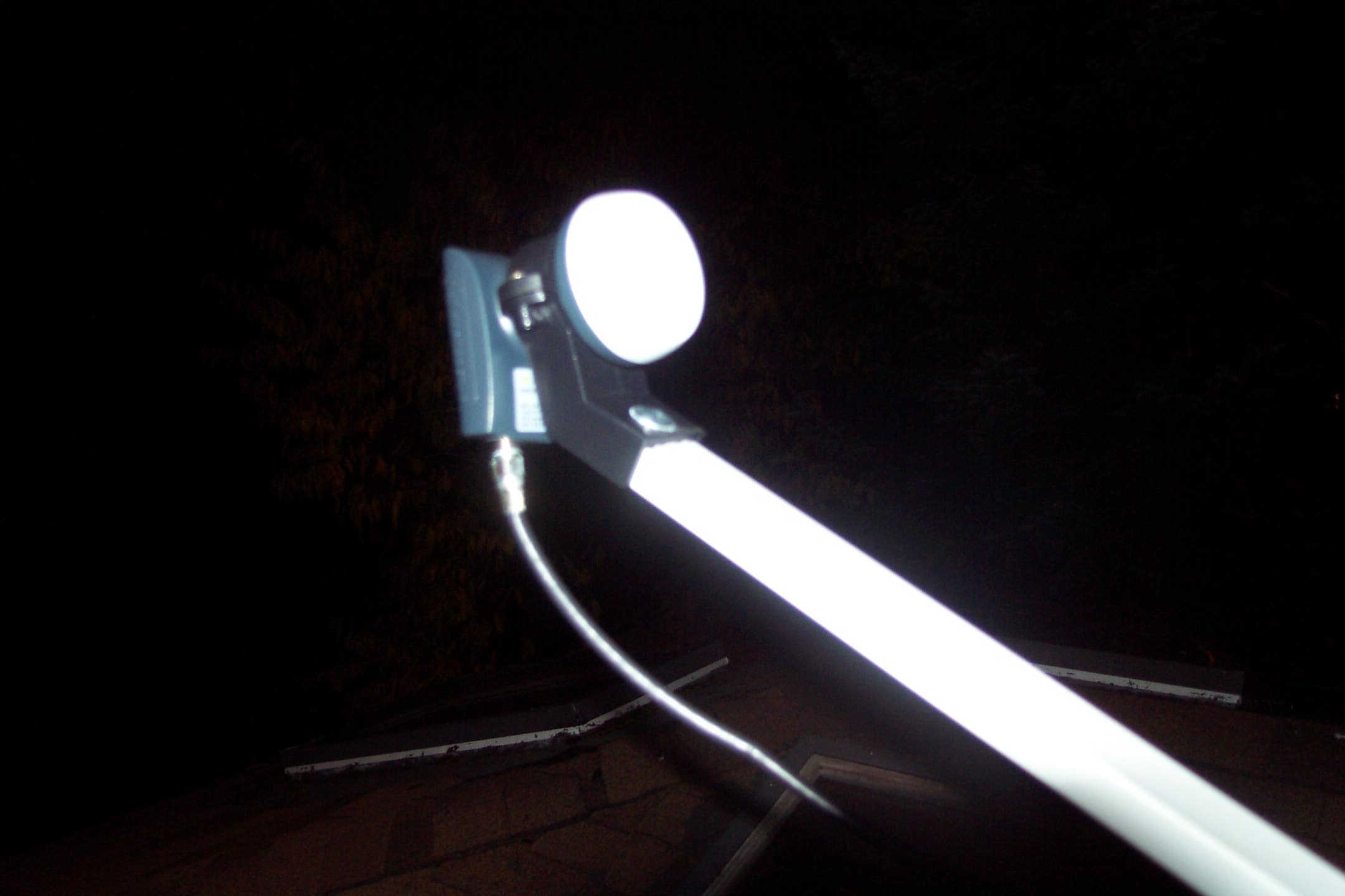

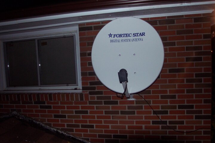

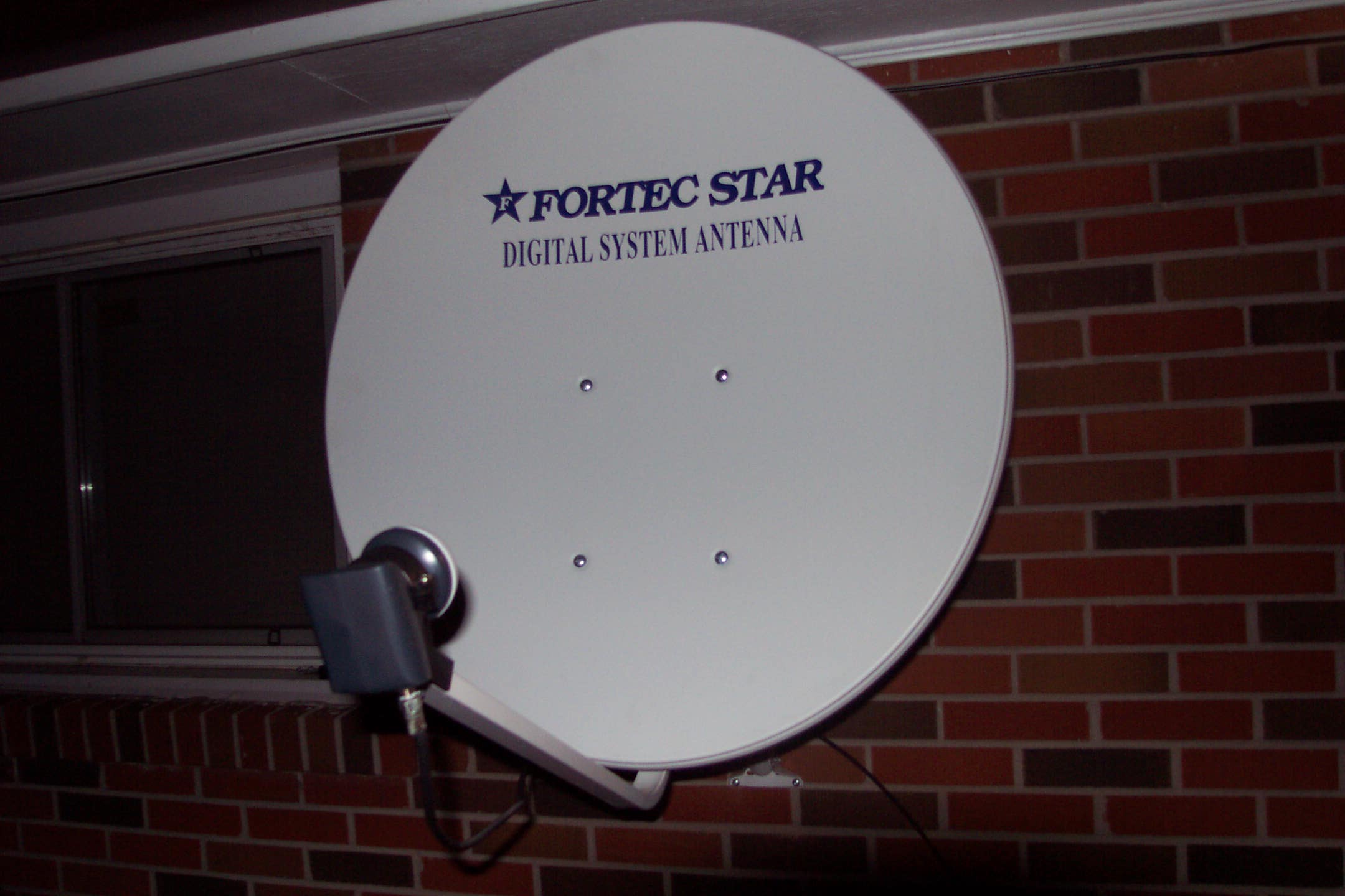

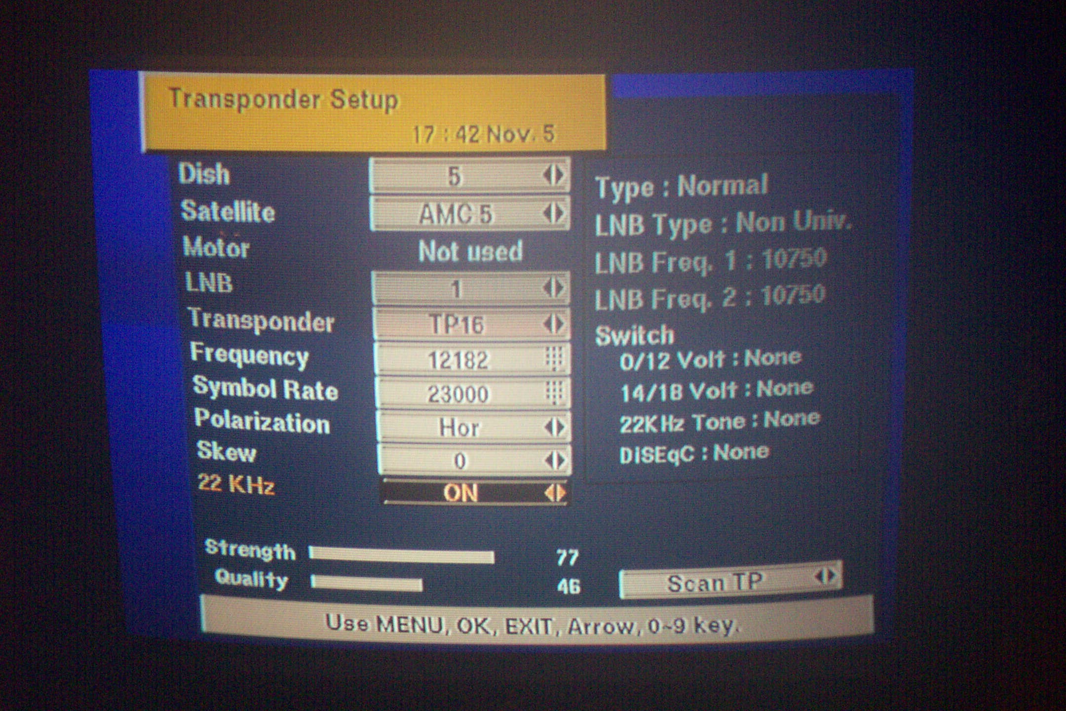

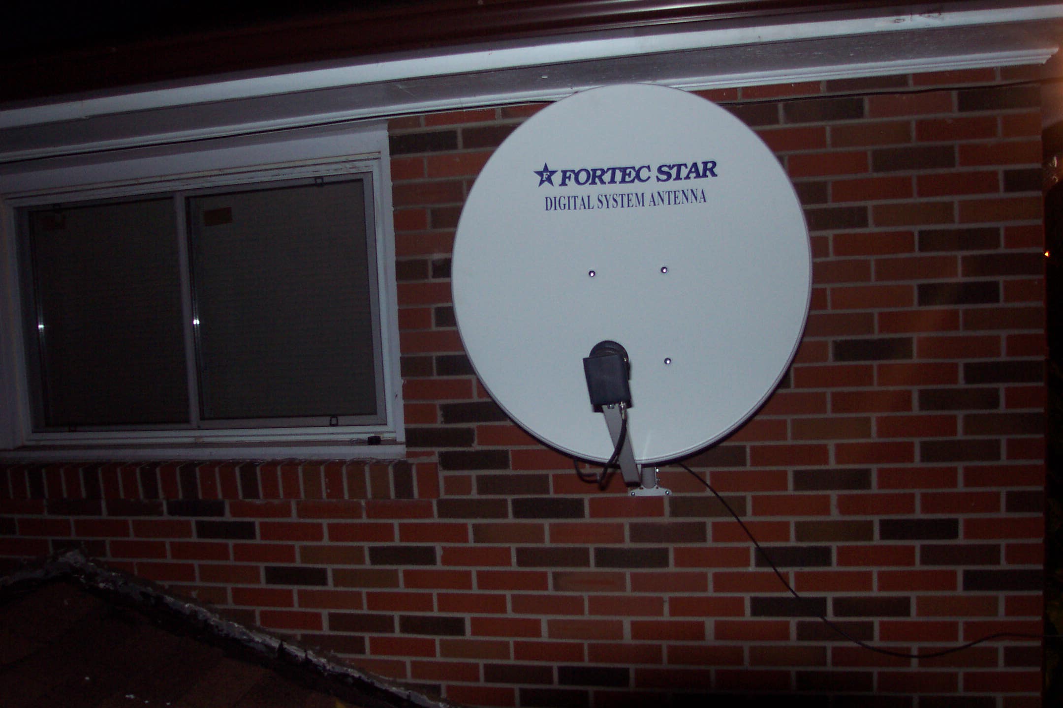

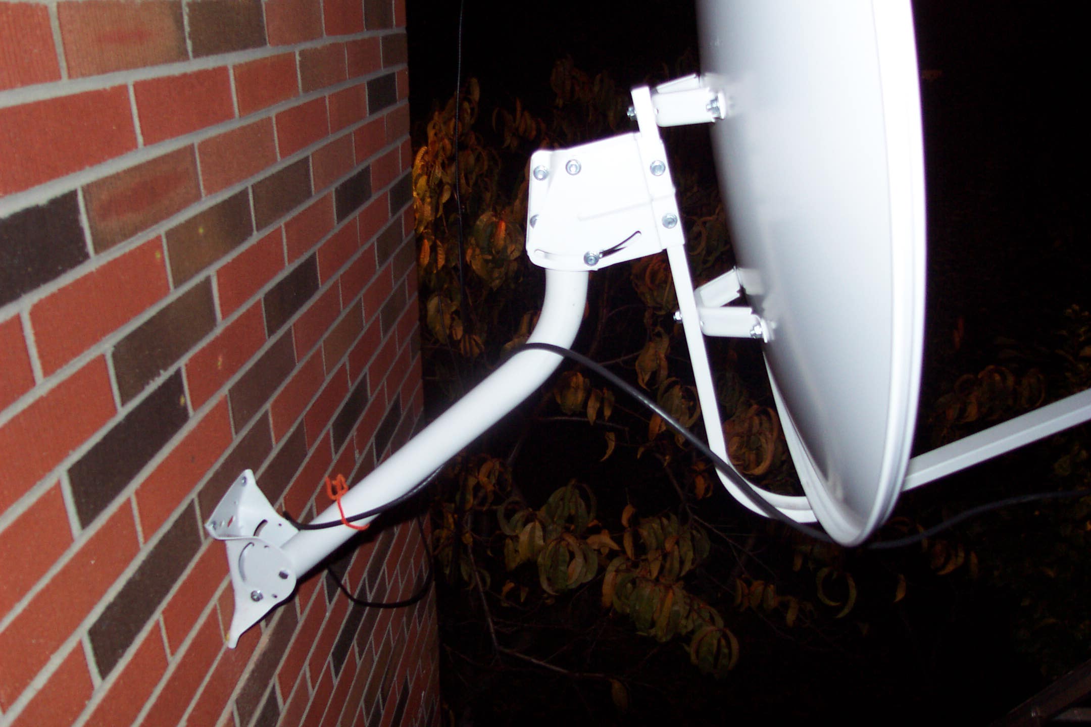

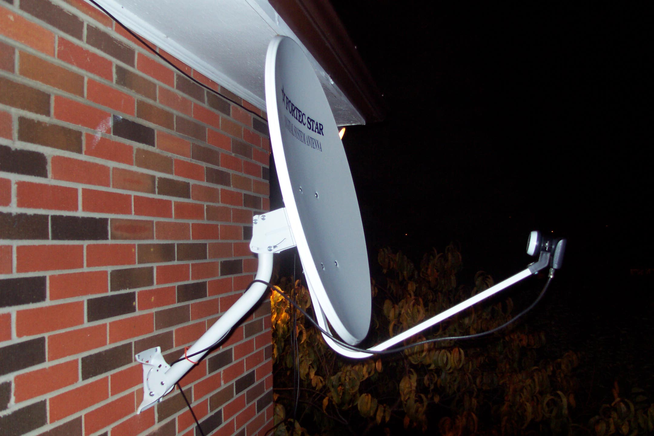

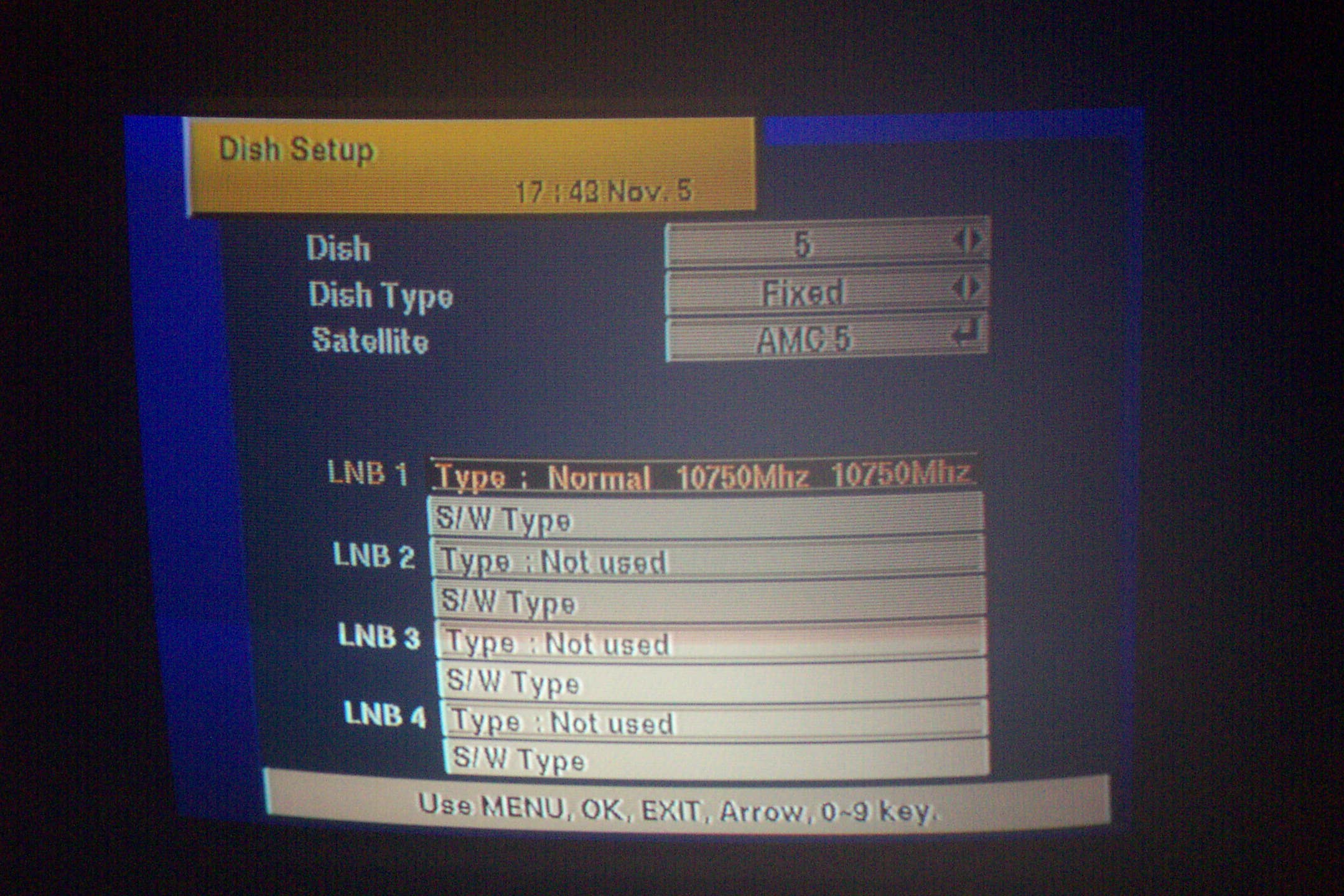

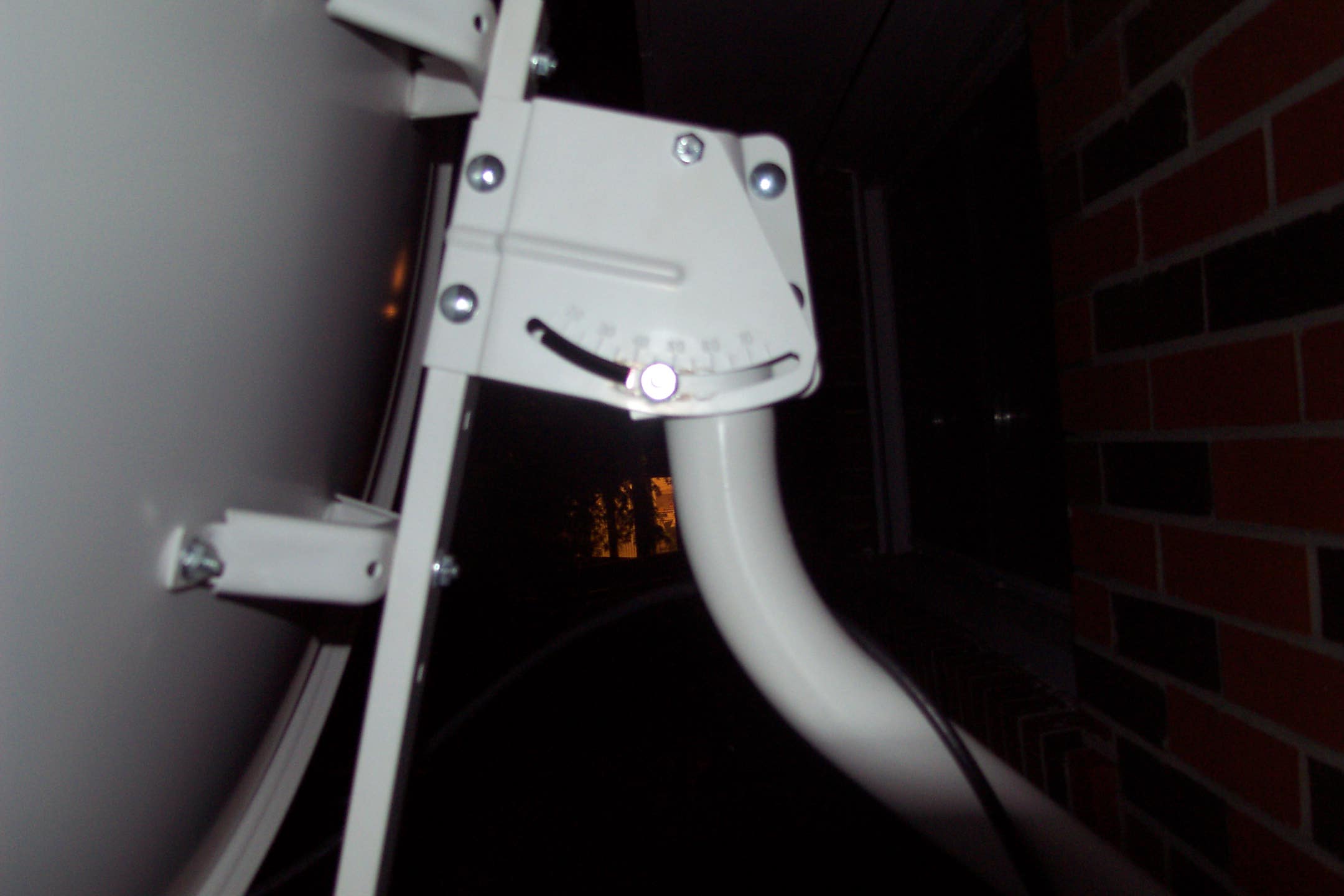

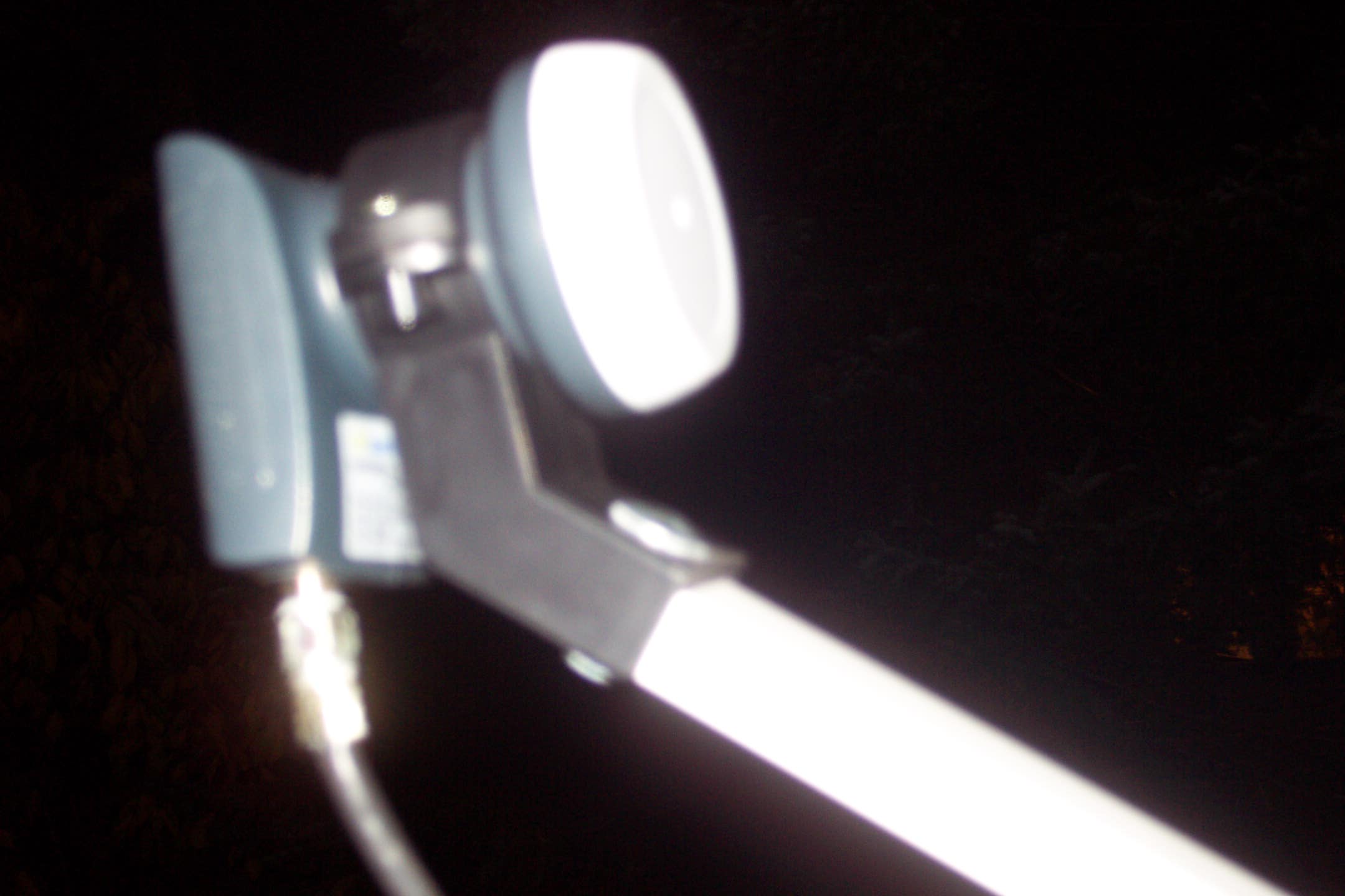

Thanks for the reply guys.....Please see the attached photos I took tonite. Some are a bit fussy. It was getting dark.
Photo Dish 2: Shows the LNB
Photo Dish 3: Shows the LNB (further away)
Photo Dish 4: Shows the dish pointing due south
Photo Dish 5: Shows side shot of Dish setup
Photo Dish 6: Shows another side shot
Photo Dish 7: Shows dish again
Photo Dish 8: Shows a fuzzy shot of the angle :-0
Photo IRD 1: Shows Transponder setup screen for AMC 5, Tp16
Photo IRD 2: Shows LNB Setup page and freq. 1 & 2
Photo IRD 3: Shows Dish Setup page
Any comments would be appreciated. :)

Looks to me as if the mast is not square or plumb/level, the top of the mast has to be checked with a bubble level, seems to be a tad off, its always a good idea to take into account the weight of the dish, I offset the level slightly then when I put the dish on the weight pulls it bang on horizontal, may be the picture but I would take the dish off and use a bubble level, it has to be bang on or your elevation angles will be way off, even more important if/when you ever add a motor.
Cool, good to know. I will try that tomorrow. When I installed the dish I checked the plumb with a bubble level "before" I put the dish on. The weight could have pulled it down. I see it now. You think I should install the support arms? That came with it. I didn't want to drill more holes thru the brick.
What about the LNB settings on the IRD? Any problems with that?
