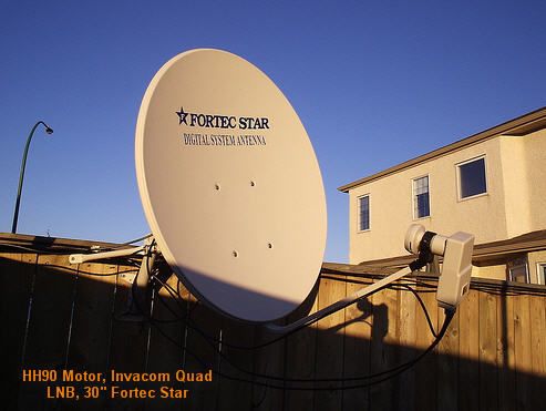

Equipment: Motorized FTA system with Invacom Quad Polar LNB
- Fence mount (Initial pole mount did not work very well)
- T5/IA5 is true south
- Motor: Stab HH90
- Dish Type: 30" Fortecstar
- Location: Winnipeg, MB (Hash winter and windy city)
- Receiver used: Pansat 2500A

When using 4-1 diseqc the motor seem to get confused and move back and forth just like it has "no brains". I have to enter the installation menu and force it to cycle through various tp to have it stable on the specific bird. The following config have been tested and same results with the motor.
(A) Diseqc between LNB and Motor, Only 2 inputs on the diseqc used (L and C)
(B) Diseqc between Motor and receiver, Only 2 inputs on the diseqc used (L and C)
Diseqc used is a digiwave 4-1 diseqc that has the label "Power Passing: 500mA". Once I have the diseqc removed and have the wire pass through directly from Receiver to motor then to LNB, things work better and motor can move better and smoother.
I currently have a temporary fix with A/B switch controlling Linear and Circular birds. This is not the best solution, but for the sake of the motor movement, this is the best now.
Could someone suggest maybe a different type of Diseqc that would do a better job? A special kind of switch?
Thanks
