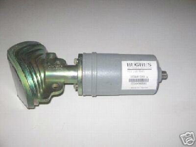

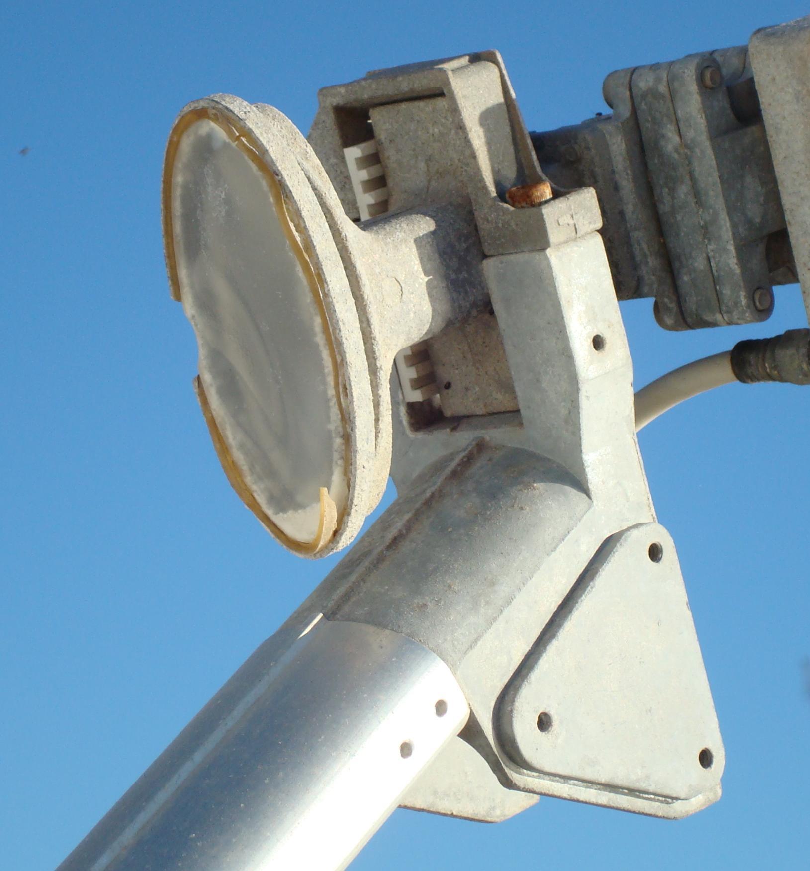

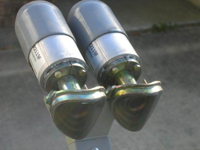

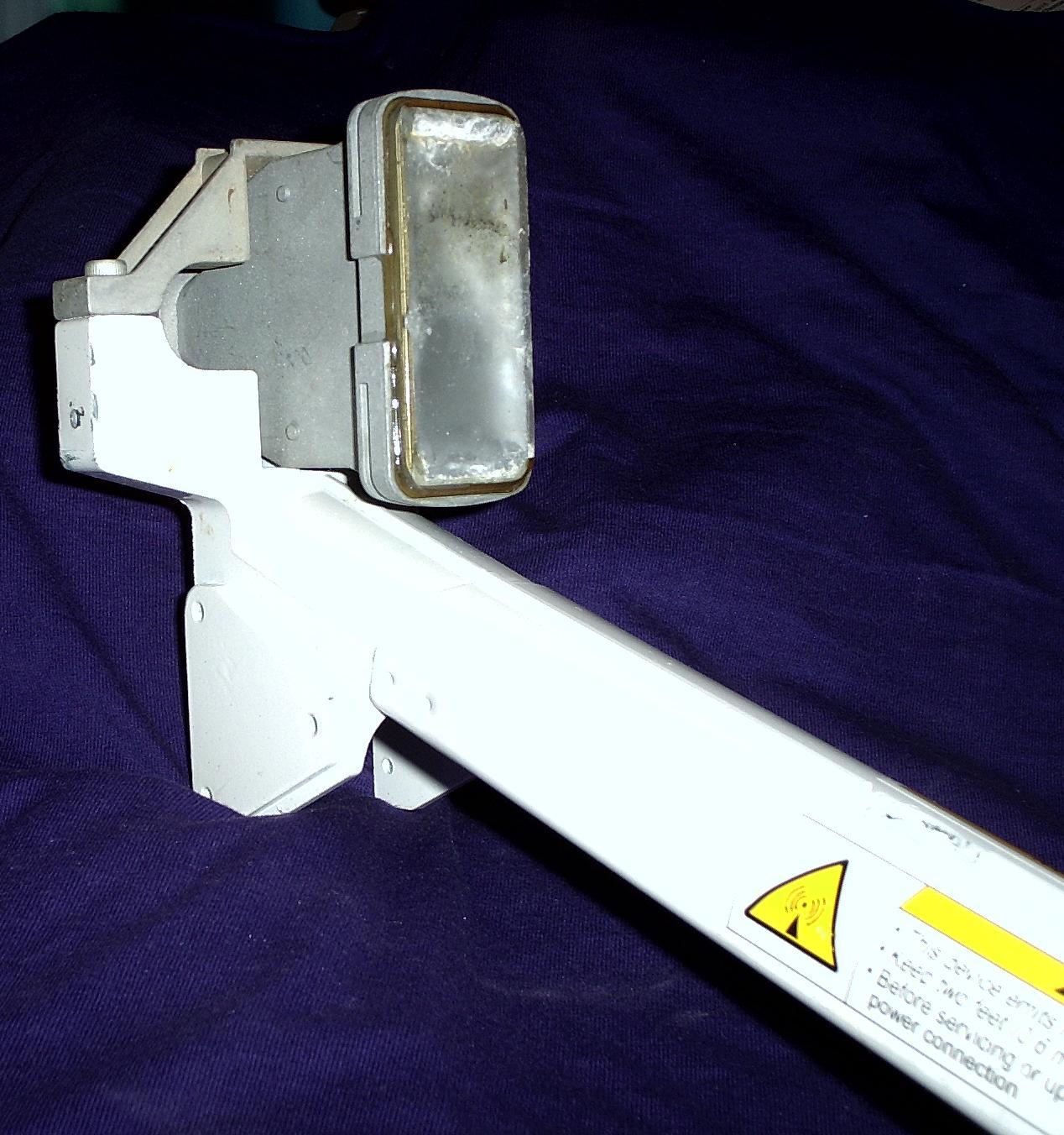

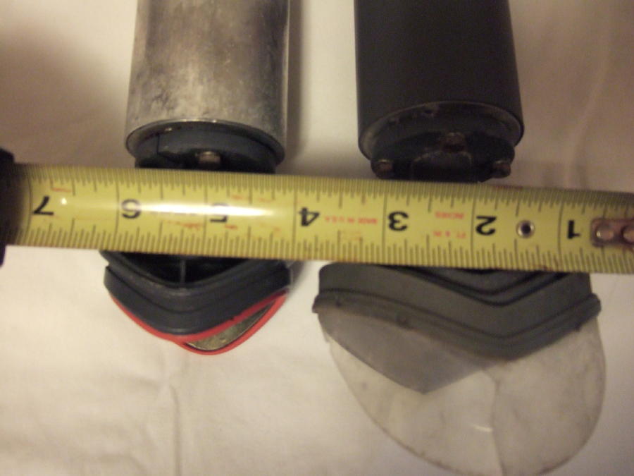

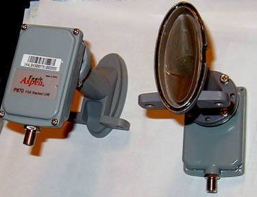

As for feedhorn, below are a couple of designs you would see on elliptical dishes.
If they were for round dishes, the feed would be round.
These first are kind of V-shaped, and the last three are tall and narrow:
