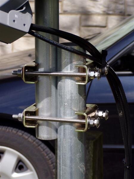

Here's how I adapted a small piece of 1-5/8" galvanized pipe to the old SuperDish 2" pole. I couldn't find any stainless U-bolts long enough, so used some 6" carriage bolts often employed in deck installations. The plated "backers" are leftovers from wireless Internet equipment mounts. They are key to this adaption, as they have the curved side with serrations that dig into the pipes and provide stability.
sigmtr
So why did you even bother to make this post? You asked for advice and then blatantly ignored every piece of advice that was given. Now you've wasted your time, our time, and made your installers job that much harder as he will have to somehow rig up a way to mount the dish to that oversized pole using hardware he problably DOESN'T have on his truck.
I did not BLATANTLY ignored every piece of advice that was given. I simply took every piece of advice into consideration. Is this not what this forum is for? For advices, tech support, tips, tricks, do's, don'ts and whathaveyou?
I simply took everything under advisement and came to the decision that I though BEST suited me.
As for the installers having their jobs being made harder, I have/will be taking care of that. I will be buying heavy duty galvanized U bolts complete with back brackets, washers, lock-nuts. All the tech simply will have to do is slide the U bolts through the holes on the mounting bracket and tighten. He then can configure as needed.
I would imagine the tech would be grateful for me not making him put in a pole in the dead of the winter, ground frozen solid. I will provide the U-bolts and hot cocoa if he so wishes.
