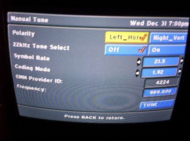

I'm trying to figure out if the box has the capability for FTA purposes using DVB. It is definately not useful for DVB via cable or terrestrial (OTA). The frequencies this box is capable of doing a frequency between the range of 950.00 to 2150.00, since this is the range that is down converted via the LNB.
Also, the installation guide states this as well. Under coding mode in the manual tune menu, which is found via the "hidden" system configuration menu, it lists different coding modes. One coding mode it does list is DVB-Q3/4. So therefore, it must have the capability to decode DVB. The problem is that the EMM Provider ID is forced on the receivers by the Voom Programming software. I've been trying to figure out how to change this number by the satellite meter that has the number inputted in it, but it is to no avail. I have been able to lock onto Echostar-3 by the frequency for the High Definition Promo channel that is in the "clear," but we haven't been able to get it displayed. I'm getting a 99% signal quality off of the satellite. Check "It's Yours" thread in News and Updates here on the Voom forum for my pictures and the settings for locking on to this satellite. I'm in the process of the formation of what I call the "Voom Receiver Project". It is a website that will be dedicated to figuring out the inner workings of the receiver and be able to display PSIP data on the programming guide for HD local channels. Another goal is to figure out a way to make the box capable of FTA (Free-To-Air). It is not the intention of this project to descramble or decrypt channels from other channels that are not in the "clear." After these goals are obtained, we might figure out a way to make the receiver into a DVR and be able to network the receiver to other existing receivers via the USB port. Some of these goals may be unobtainable, but it's worth a shot.

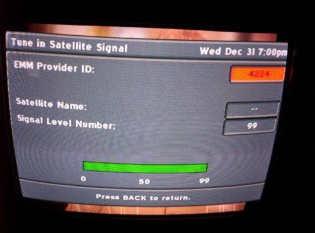

I've already got the polarization down pat, so that part I know, but I just need the other information to go further on my research. Here's the pics on my satellite meter and the menu settings for the lock onto the HD Promo channel:

In regards to the signal meter there, I notice that it says "Signal Level" not "Signal Quality".. now, this could just be a verbage issue, but since there is a strong Ku signal on E3, it may just be reading the flat out signal level, not actually locking onto the data stream, or even having a readable (eg, able to decode) data stream (signal quality)..
FTAers know from experience, signal level means nothing, signal quality means everything. But, as I said this may just be verbage confusion in the software too.

The only thing the Voom box MAY be able to receive is unencrypted DCII programming (like PBS on AMC3). You would need a 30” dish and a different LNB
But I have tried this before and it doesn’t work. Yes the signal registers, but it says “please wait…we are processing your request. So it really doesn’t work.
