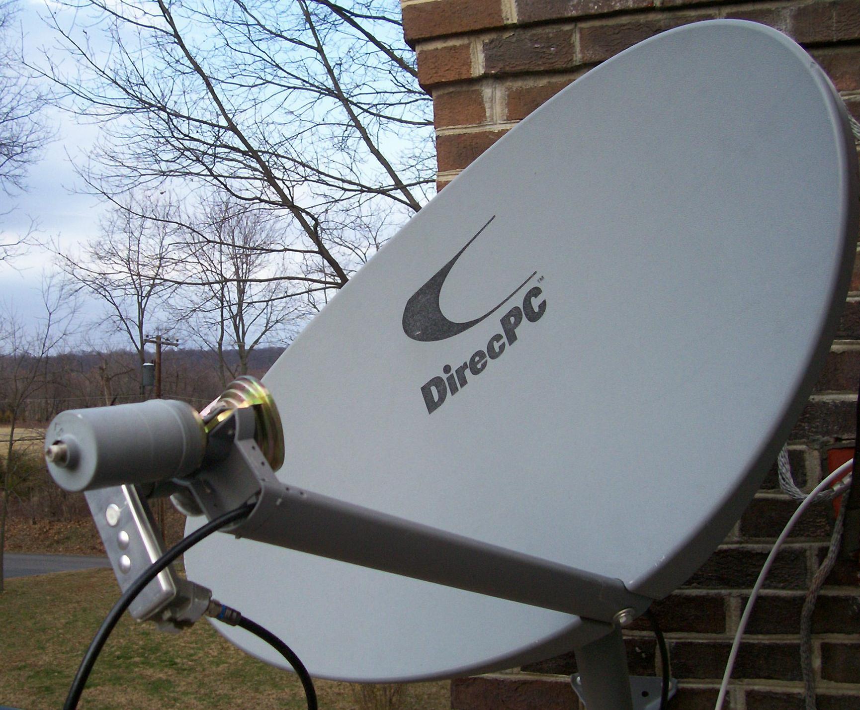

Funny you should ask....
I just did this today. Took me a while but I figured it out.
Used my existing DirecPC and added back the Dish LNB (I had it on the opposite side before for pointing purposes). Both are working but I did not have a piece of RG-6 long enough (have to go to Lowes and get one).
The Hughes will be going to my Fortec Merc II and the Dish LNB is going to an old JVC 3700 from Dish. One more cable and I should have it done.
